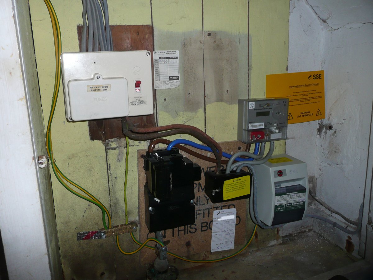

Thanks for the answers and advice. Another question, the original consumer unit is fitted to wooden panels in an under-stairs cupboard, is there any reason that the electrician can't fit the new one in the same place? CUnit.jpg
It has need a traditional location, however there is a risk of fire if started under the stairs from preventing egress from the building. As a result I intended to move my mothers consumer unit to a visible location, still technically under stairs, but where nothing can be placed around the consumer unit to prevent the heat escaping. However all the people I got to give estimates all wanted to keep the consumer unit under the stairs. So it seems electricians still fit them under stairs.
What has to be remembered is any fuse or MCB makes heat, that's how they work, so that heat must escape, so 13A sockets for example should be in free air so the heat can escape from the plug. For a domestic consumer unit that heat is very small, so in the main not a problem, but under the stairs is where many people stuff things out of the way and the area can end up full of junk which stops cooling and could in extreme circumstances lead to a fire.
So it has to be left to the electrician to do his risk assessment and decide if he feels it is a safe location. Can't really do it for him. He signs the paperwork, so it is up to him.
Thanks for the answers and advice. Another question, the original consumer unit is fitted to wooden panels in an under-stairs cupboard, is there any reason that the electrician can't fit the new one in the same place? View attachment 103428
No reason why not if the replacement CU will be fully compliant with amendment 3 , i.e. all metal.
