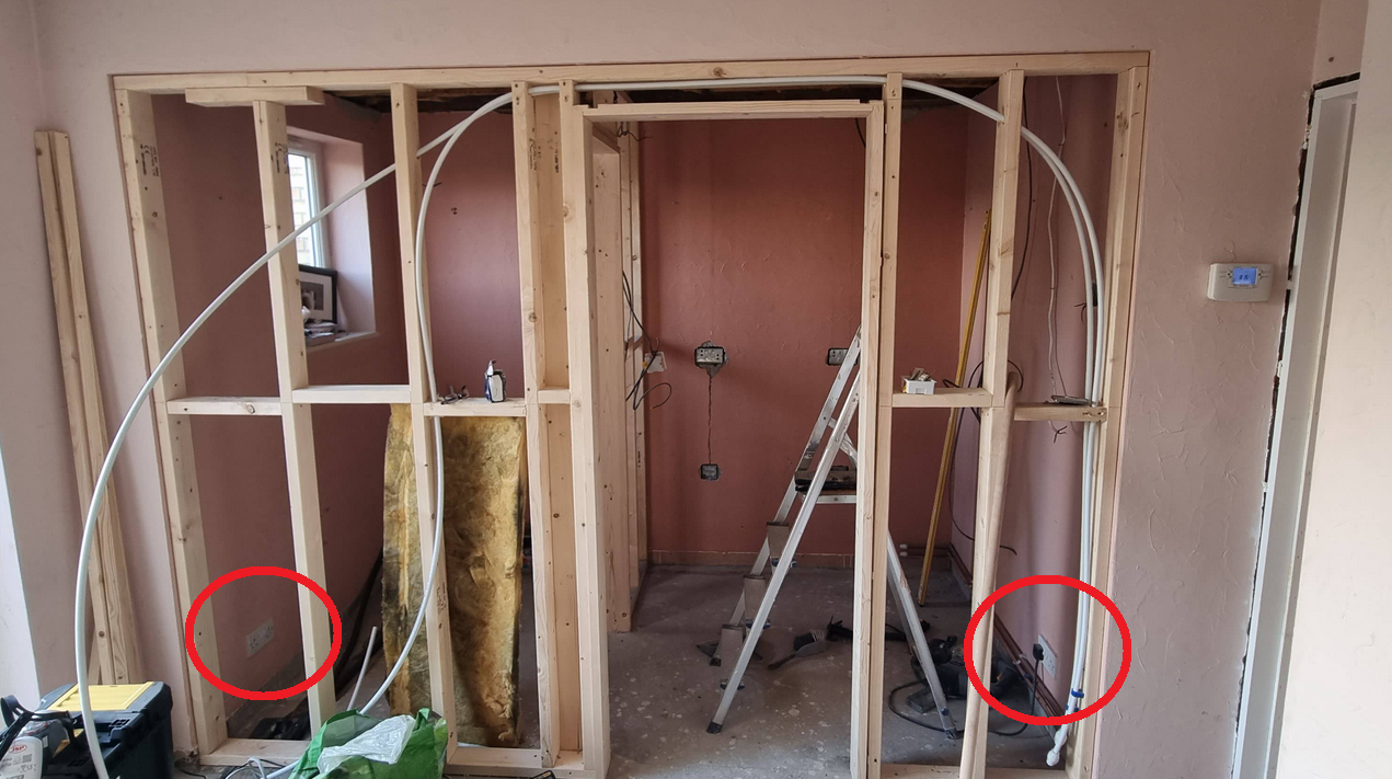

I need to extend a ring circuit into a utility room for a washing machine and tumble dryer. Both alliances will have their own socket which can be isolated individually above surface.
How would you go about bringing in the ring circuit from the next room (dining room), the ceiling of the utility room/toilet is flat roof and lower than the dining room, plus there is a lintel in place.

Thanks for the replies all, I'm not sure I have explained myself properly but the ring must come from the room I'm standing in, in the first pic through to what will be the utility room (where the sockets are chased out).
The normal route would be above ceiling and drill through centre of joist but there is a steel and ceiling height difference to contend with?
I understand the regs of where wires can be chased in, but that doesn't answer how I actually get the cables to that room in the first place, i.e drill above lintel down into utility?? Etc..
From what you've said, it doesn't sound as if there are problems in relation to regulations concerning the routing of cables - so does it not just come down to a question of what is physically/logistically possible (and also aesthetically acceptable)?

How does the supply get to the existing socket in that space, the one that your tools are plugged into?

I’m confused. There’s already sockets in there, so must be access to the ring?
Just what I was thinking.
Same here. In fact, there's only one 'live' socket we've seen in the pics (the one near the floor with tools plugged in), since the ones on the back wall appear to be 'awaiting their wiring'.
However, that one double socket is plenty to 'beg the question'!
Kind Regards, John
As I just wrote, other than the one near the floor with tools plugged into it - which presumably does 'have cables'?
Kind Regards, John
My bad, sorry. And there seems to be one on the far left.
