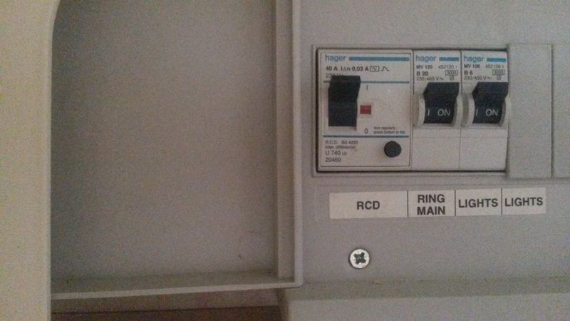

A term often used for a Ring Final circuit. But looking at this Static Caravan board, it was used by manufacturers as well. No wonder Joe Public gets confused...

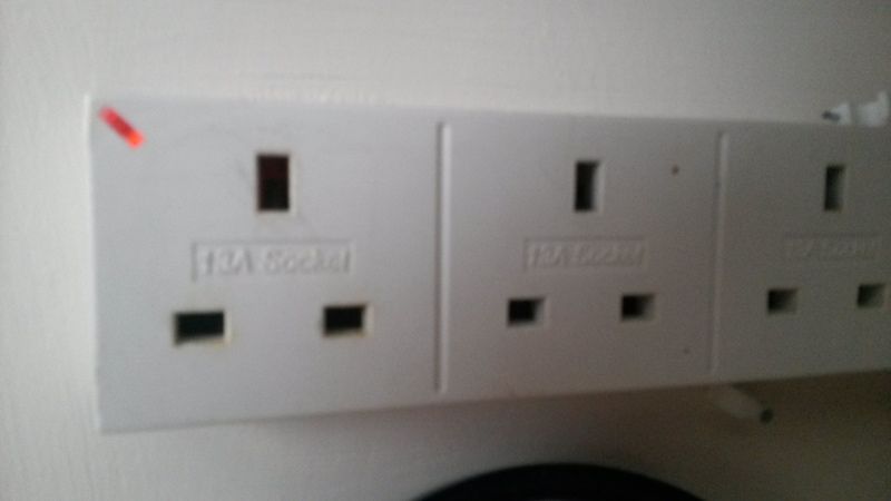

Talking of confused, this 4 way strip from the same 'van has 13A embossed on every outlet...
I'm wondering how that second 'LIGHTS' MCB is operated!
The ring final is rather a special system with special rules which allows us to use some predetermined figures.
In spite of having a 32A MCB we calculate at 26A that 20A at centre and 12A even spread across the ring.
As we drop the MCB size the 20A remains so using a 20A MCB we only reduce the current rating by 6A not 12A. So reducing the current does very little to the volt drop which is the limiting factor.
With a static caravan it is unlikely you will ever have a problem with volt drop so I see no point in using a ring with a B20 MCB.
However the question is why is there a B20 MCB it could well be so than MCB trips before the supply MCB/Fuse opens. It could have been designed to use a 32A MCB but swapped to a B20 latter.
It could also be the other type of ring which allows for a section to be isolated without turning off the whole system.
But I would guess it is simply the consumer unit comes with pre-printed labels and the installer has just selected the most appropriate.

The ring final is rather a special system with special rules which allows us to use some predetermined figures. ... In spite of having a 32A MCB we calculate at 26A that 20A at centre and 12A even spread across the ring.
Although you frequently quote those figures, and although they seem to make very reasonable sense as a 'rule of thumb', I don't think anyone has ever seen them in writing, have they? Logically speaking, if there is such an officially-accepted 'formula', one would probably expect essentially the same 'formula' to also apply to a 32A radial circuit - have you heard that suggested?
I can't think of any real reason why anyone would design a 2.5mm² ring protected by a 20A OPD, since the whole point of a ring final is that the regs give a special dispensation to allow the use of smaller CSA cable than a 30/32A OPD could normally protect. If VD (or EFLI) would be a problem with a 20A 2.5mm² radial, then one would presumably design with higher CSA cable, rather than change it to a ring, wouldn't one?

They do, but it doesn't result in any confusion - we all know what they mean. The same when they talk about 'bulbs', 'plugtops', 'plug sockets','low voltage lights' or 'transformers' etc. etc.
....and many DIY folk think that each 3 pin outlet is rated at 13A.
Those outlets in the picture probably are 'rated at 13A', aren't they?
