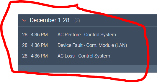

Alarm still functioned physically, but had stopped sending emailed status updates.... which was important to me for when im not there, I like to know if its been triggered while im away, for obvious reasons.

It doesnt unfortunately.... but based on the event history in previous months spitting out a Device Fault error for the (LAN) Module.....it looks like it stopped doing that yesterday when I reset all the vonets wifi bridge and re-pointed it to the routers SSID etc.
Based on the event history error schedule, it looks to my eyes like it would report one of those errors every 3hrs or so... it hasnt done it for 12hours now, so one would assume it has connection to wifi based on this?

Assuming by deduction then that that means the vonets is working just fine, but the issue lies either between vonets and the panel.... OR as you suggested the panel is simply not trying to connect to the internet, perhaps because the GSM is working fine and it isn't to try and connect via wifi?
Worth mentioned actually that there's still no errors.... though I wonder if, when I disconnected and reconnected the vonets on the 28th December...it somehow has told the panel to stop trying to connect via wifi. See attached below.... that was the last "LAN" error i got.
