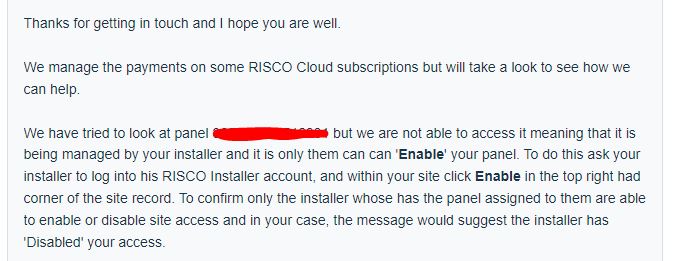

Hi all,
Had a RISCO Lightsys2 for a while now, always been great until recently noticing it had stopped giving us status update emails.
Logged into the app and was met with this message saying im not authorised to access the site and that i should contact my installer?!
App screen image - https://ibb.co/km1rkMn
Obviously gave them a call, they said all the places that could help with this (risco technical etc) are closed till the 5th Jan, but they did also say that there is an outstanding bill for the GSM service this alarm uses (it uses GSM as a backup incase the WIFI goes down).
To be completely honest I didnt even know where was an arrears, but even in the result of there being one...I really can't understand why the entire panel has been made entirely inaccessible by me? Fair enough not allowing it to be function via GSM if i've not continued to pay for that service.... But see the attachment below, it's saying the site has been disabled when I try to login via my desktop computer too. Meaning they've blocked my WiFi access to it too?!...Which didn't feel right...?
Desktop RISCO cloud image - https://ibb.co/2sjknxr
Am I being crazy or am I right to be confused here? as mentioned above.... do they have the right of access to disable my site from wifi access too? that bit isn't a paid for service. Id be surprised if they have that level of access... if they dont then the problem must be something else?...

You need to take this up with Nova.
Unfortunately can't speak for what agreement you have with Nova.
However Risco as a per site subscription for the app and has done for about a year now.
The GSM module will have a sim and this may be a contract with Nova, that I can't comment on either.
As for releasing the panel so it's free of contract, you would have to contact Nova/ Risco. You may be able to transfer elsewhere once it's released.

A company called Security Point UK have nicely responded to one of my email enquiries... and said the following below, does this look correct to your experienced eyes? as when I called Nova earlier they didn't suggest any of this.
The message you got in the app suggets you don't have an active subscription with Nova and that's the last company for that system.
Light sys didnt have a dedicated WiFi module so you would have an IP module connected to a WiFi bridge unit if it was WiFi connected.
It should also be in your contract, as for using the alarm, you should be able to use it just not the app but may depend on programming

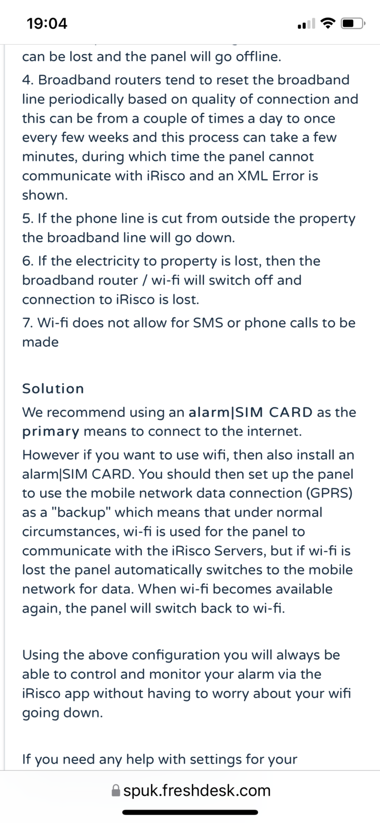

I found this FAQ on Security Point's website - which also confused me - It suggests the simcard and risco cloud services are linked.... But in my case i've already paid for the subscription directly via the app?
https://spuk.freshdesk.com/support/...t-pay-alarm-sim-card-for-risco-cloud-service-

That link above with Q and A suggests it’s a GPRS SIM card ….eg connection on the IP Side via this …C7C3236B-AA84-4725-B496-BA632CBD57F7.png
I was under the impression that's how it was setup by the installer yes. I specifically asked for both a GSM module and an IP module so it would do both and revert to Simcard in the result of a burglar cutting the internet cable or something like this.

It’s irrelevant because the panel is set up to access the cloud to use the app.
The panel should work manually but no cloud access.
With risco it’s possible to use the WiFi and if that connection drops for any reason to switch to gprs. You can also use the gsm module separately but if the SIM card is under nova contract, then the chances are it won’t work in any respect.
I have no idea on what is happening between you and Nova I can’t see the system being released if money is owed. As for no one to sort it until the 5th Risco may be shut but someone at Nova should be able to help.
yeah, all accurate, cheers.
Nova did get through to someone from RISCO today and managed to un-disable it. No ones sure what had happened entirely as Nova said the GSM stuff should be entirely separate but hey ho, it is back online.

If I was to disable my customers for non payment I log into the engineers portal and disable it, it’s a really simple process, but nova would need their admin or risco admin to do it. Appears that must have been the case.
disabled by accident would seem unlikely, disabled for unpaid bill is a possibility, you pay nova, nova pays risco for the accounts when due, it’s possible but couldn’t confirm it that nova didn’t renew your system with risco due to bill being due and risco disabled there end, but that’s all guess work.
the alarm company logs into the panel and programs it accordingly, you would need an engineers code to change the programming.
I can’t comment and don’t believe an end user can check, it may show online and by what method your connected if you log into the user portal for risco cloud.
