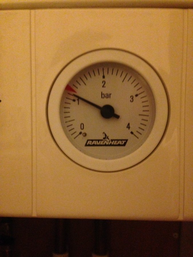

The pressue was exactly on the red mark last night before bed with no heating on overnight. So close :(

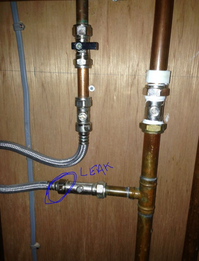

On Sunday night when I isolated the system and diconnected the filling loop I noticed there was a leak from the NRV (I'm guessing this is what this is). Would this cause the pressure to drop? I was thinking that when the filling loop is connected the system stays sealed or maybe thats not the case? Will I replace NRV or can I buy a cap to screw on the end?

I've just got in and the pressure has dropped another 0.1 bar. The heating hasn't been on all day, hasn't been on in 24 hrs. There is a very small wet patch outside, what would be causing this? What's my next move (besides getting an engineer out)? Thanks for your help so far.
I've just disconnected the filling loop and the NRV is dripping. Could this be causing my problem? Is it worth replacing this or when the filling loop is connected does it not make any difference?
Edit - I think it's a double check valve that's leaking.
