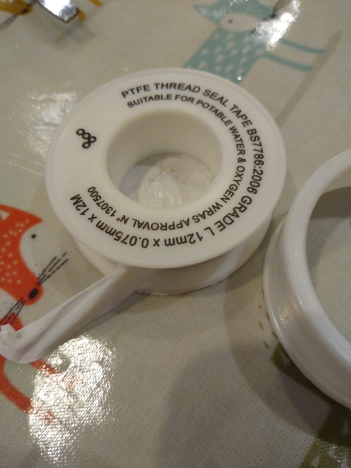

Anyhow, I've just had a breakthrough that you may like to try - I suspected that the leak may be happening at the centre of the washer, where it fits around the white plastic. So I took of the two washers (solid plastic and flexible rubber) and the part that fits on the bottom to secure it all, and wrapped the central "post" with white threading tape before putting them back on it and reinstalling the valve - worked a treat!
See how you get on...
