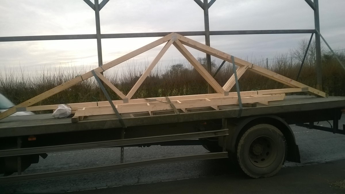

Also, in most parts of the loft I can pile in 300mm of wool of I wanted as I wont be boarding it out but there is a central section which I do intend to board and it is the entire length of the loft and around 1.5metres wide. The ceiling joists are 70mm high and I was originally planning to add 30mm battens which would then provide space for 100mm Celotex. I am concerned that if I go with rockwool here too, it may be on the low side?

Everything you have said makes perfect sense and applies in my situation except, I have reservations about the central section where I will be boarding out. This section is already at a crawling capacity. there simply isn't the room to have 300mm insulation here (I could have 400mm in other areas if I wanted to - not an issue). This would make it difficult to crawl too. This is why I was wondering whether I should go with 100mm PIR here. Hope that makes sense.
ok, that might be the bit I missed. I wouldn't try to fit pir boards between joists. An option might be to start with mineral between joists and then lay continuous pir boards over the mineral. Will these board need to take traffic - i.e. crawling over? How much space do you actually have?

Yes the boards in the centre will need to take the weight of someone crawling across. I would estimate the current height from the top of the joist to the highest point of the truss at 1.5m. The area I am looking to board is around 1.5 metres wide too (central section of picture inserted below). Note that there is a triangle which means it's restricted further on this sides.
If I packed the existing 70mm joist with 100mm rockwool and then put a PIR board over the top of the joists, how would the chipboard go on and would it be safe to crawl across, etc.?

Look at the celotex loft insulation application datasheet. It tells you to use 18mm ply over the insulation boards and to secure through to the joists.
The data sheet refers to light storage. I'm not particularly light and I'm worried that the insulation board may give as I crawl on the chipboard placed on top of it...
Can someone please shed some light on the above? Can I just place the insulation board over the ceiling joists? the ceiling joists (bottom part of the truss) are only 70mm deep.
Celotex GA4000 claims a compressive strength of > 140 kPa.
Say your mass is 100 kg. Weight on earth = 1000 N.
Say the boards distribute that weight over a circle of diameter 500 mm. But that circle is supported only where it touches a joist. So that could be an area of 500 mm x 50 mm = 25000 mm^2 = 0.025 m^2.
So the pressure on the bottom of the celotex would be 1000 / 0.025 = 40000 Pa.
That gives you a safety margin of 140 / 40, which seems reasonable to me.
