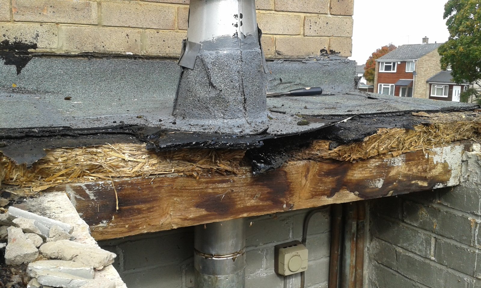

Hiya,
My boiler roof leaks I and decides to DIY. I found that the insulation looks like a compact hay which I've never seen before. Is there any reason this insulation is made of such (as image).
A place I used to work had a roof made from what looked like wheatabix
It was compressed wood wool
It's called stramit board. Widely used on roof construction in local authority housing in Cumbernauld (a new town built around 1950's - 60's), never came across it used anywhere else but I'm sure it must have been. Quite strong until it gets wet, and was intended to be a combined solid surface and insulation in one. Almost definitely no specific reason not to do away with it if you wish.
Not as a like-for-like replacement since polystyrene won't be any good as roof boarding - you'll need boarding first then your selection of roof covering (including insulation as you require).
