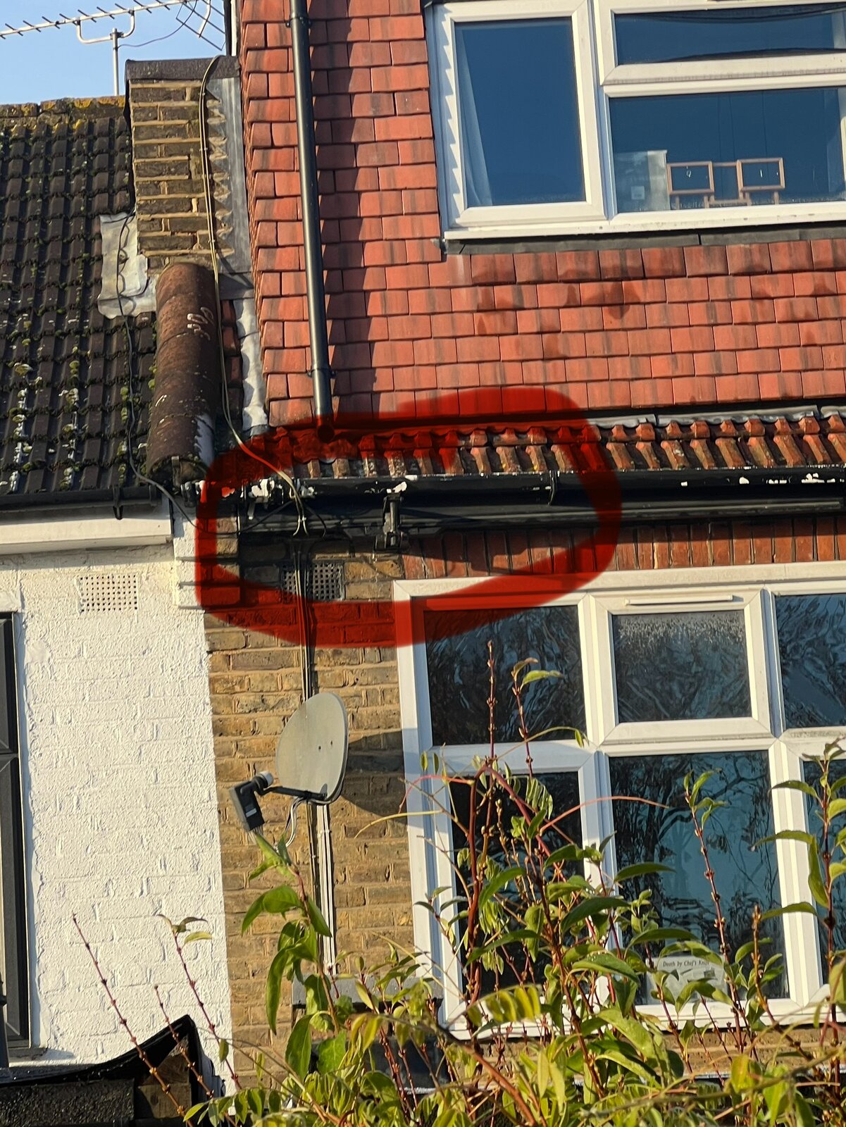

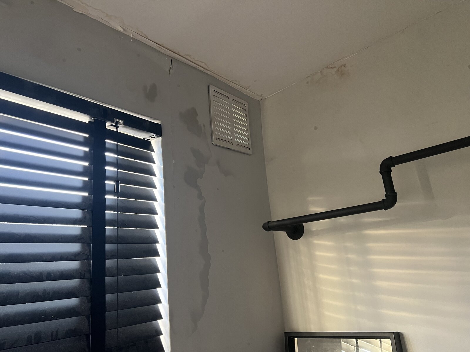

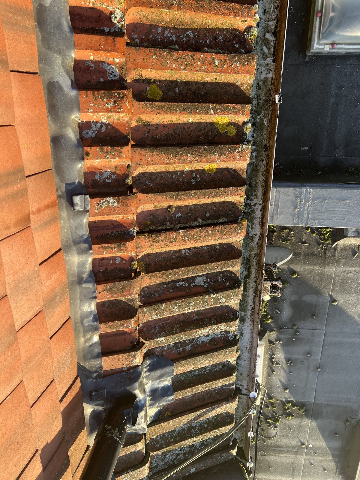

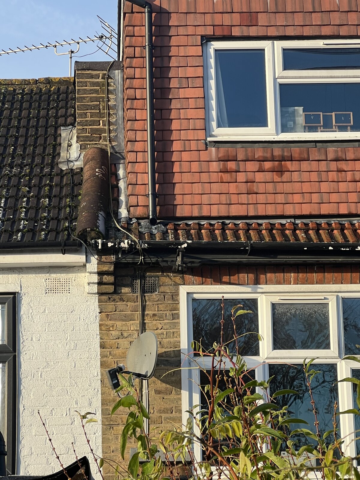

I have a persistent roof leak into my son’s bedroom below our loft conversion. I have had a seemingly reputable roofer come twice to try and fix it but he’s run out of ideas and left me £325 poorer! He replaced some lead flashing under the gutter and also said the felt under the tiles is fine. It’s a weird leak in that it doesn’t leak every time it rains, only sometimes, almost like either there is a build up of water or only when the wind is blowing a certain way. When the water comes in though it’s quite heavy, ie literally running down the walls. Any thoughts / ideas / help please? I have attached various photos. Much appreciated.

That lead work under the downpipe looks really inadequate to me. Badly done. And the lead work along those tiles. Any driving rain would easily get in under all that.

Extend the rainwater pipe from the main roof into the gutter below and see if that helps.

I can't see that being the issue as the OP says it only happens now and then. The side cheek of the dormer where the ridge tiles are look like a bodge to me, that's where I would start looking because it will be sheltered at times depending on wind direction.
