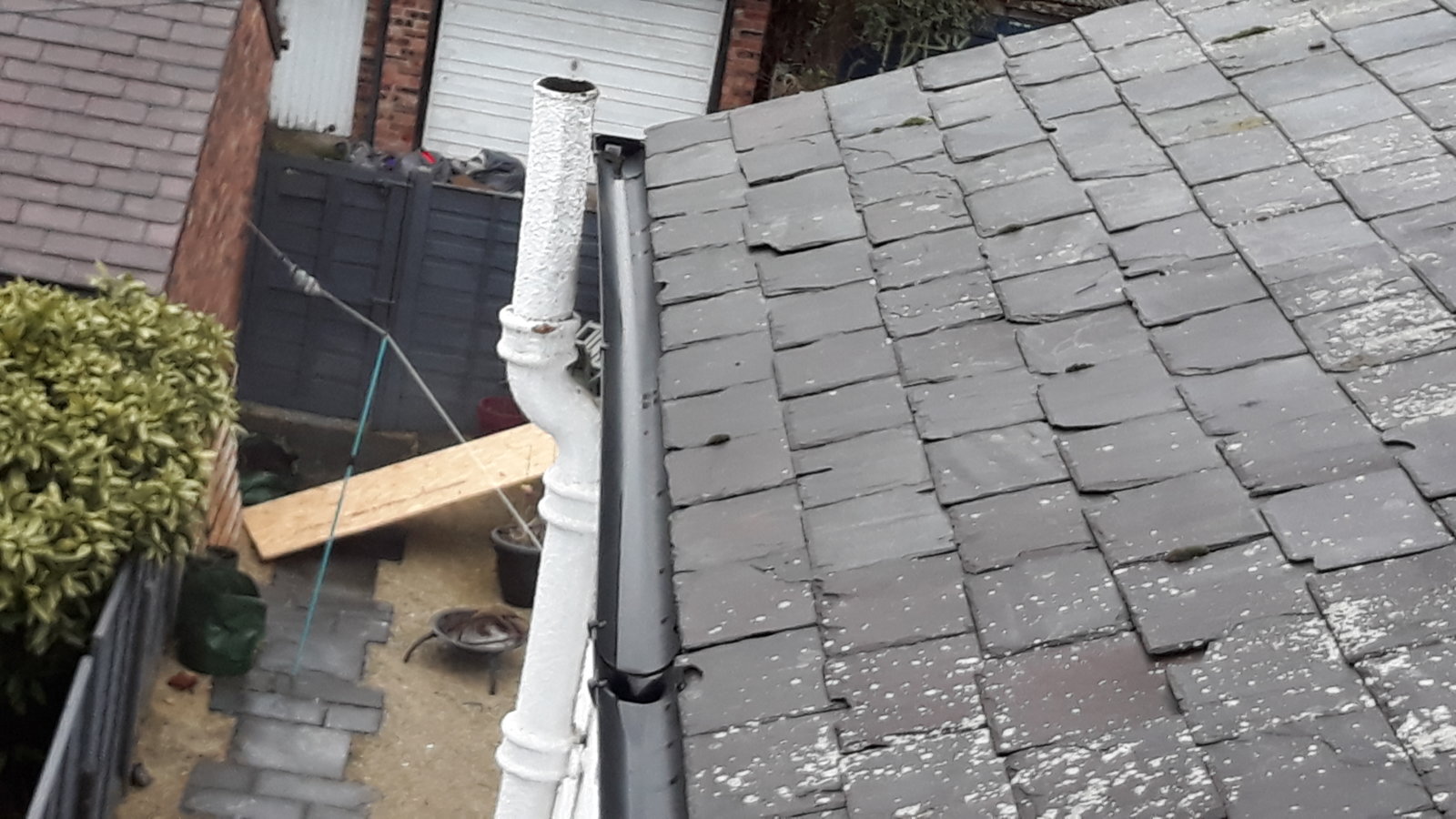

Ello, had new fascia and gutter installed and there's now insufficient overhang causing a waterfall down side of house. Roofer suggesting eaves guard will resolve but just want to get some opinion on this. As can see from pic there's barely a cm overhang.

Hard to tell from that picture but did they fit new fascia board over the old one?
Yes, I wasn't keen as the old wooden fascia was well worn but roofer assured me it wasn't rotten so attached over the old
Well he's a lazy roofer isn't he? Get him back to do it properly- either take the old fascia board off & refit the new, use different gutter brackets (if you can get any with less standoff than yours have) or fit felt support trays WITHOUT ripping the nails out of the lower course of slate & fixing them back in with tingles. The felt trays will be a nuisance- the end will be dipping in the gutter so if you have leaf problems, expect them to double.

In your case, I would suggest calling the installer back to install a piece which is long enough.
