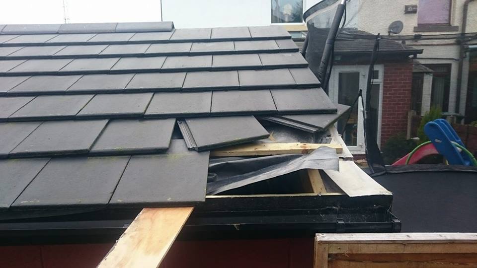

We got burgled through the roof :(
yep its the old favourite weak spot unfortunately. Hope they didnt get much. Often they cause more expense getting in. My friend had a motorcross bike lifted out through his workshop roof.
Are they plastic tiles? They look great. OSB board, sark it material then battens before tiles is how I did my summerhouse but nothing in there is worth taking. I also used plastic fake slate tiles, made by tapco I think.

This is the guy who broke into mine, I think he was looking for my sons motorbikes but we keep them at my sisters farm.
They still stole s fair bit though so must have come in a van.
