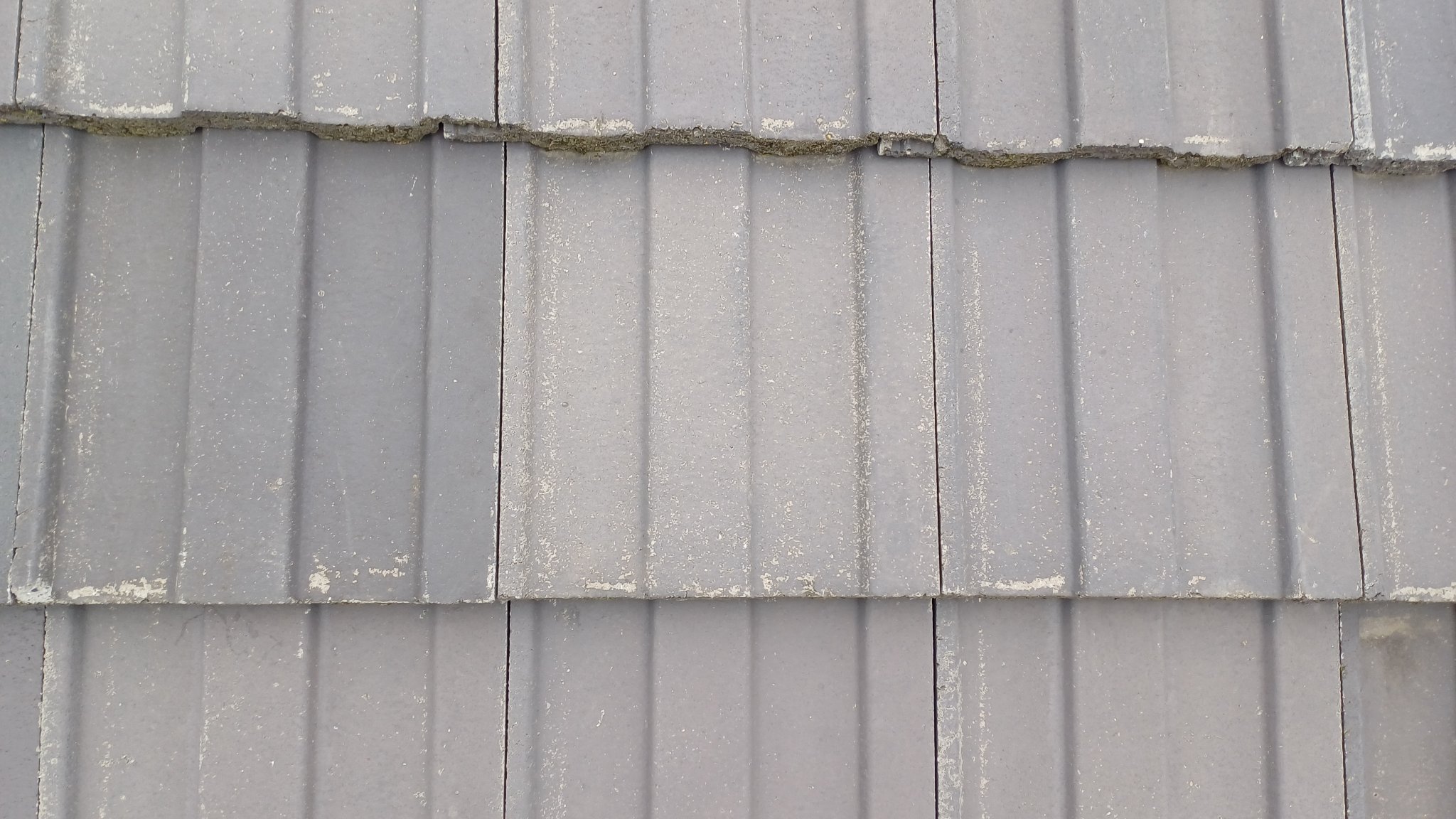

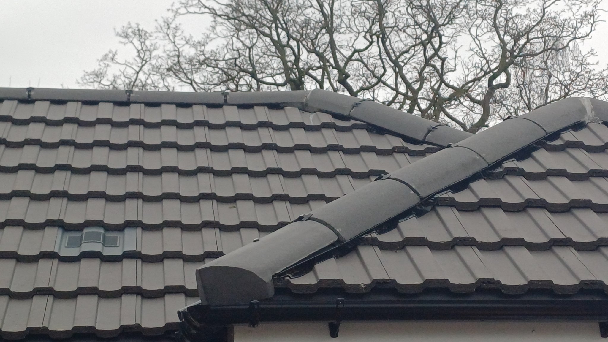

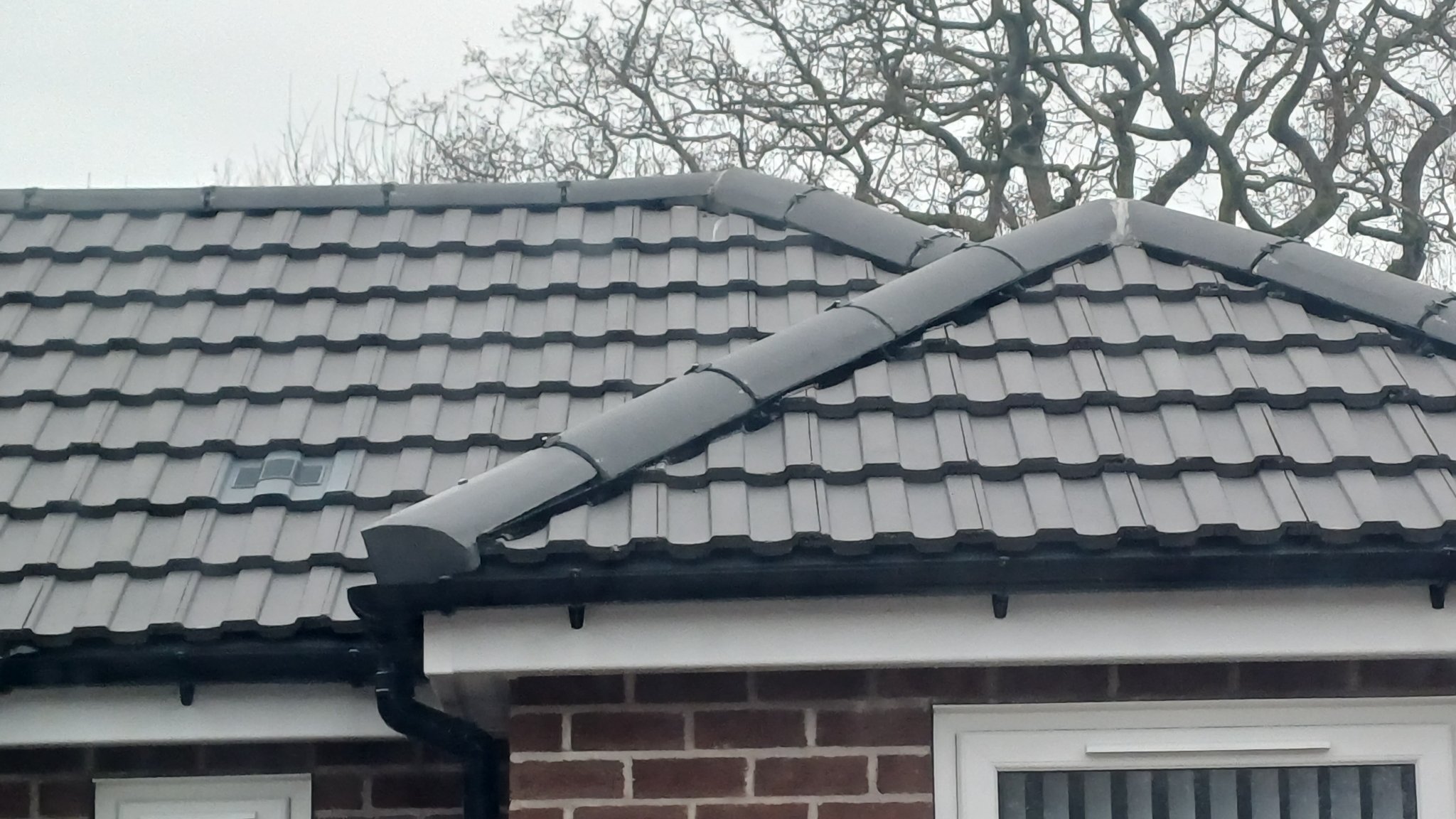

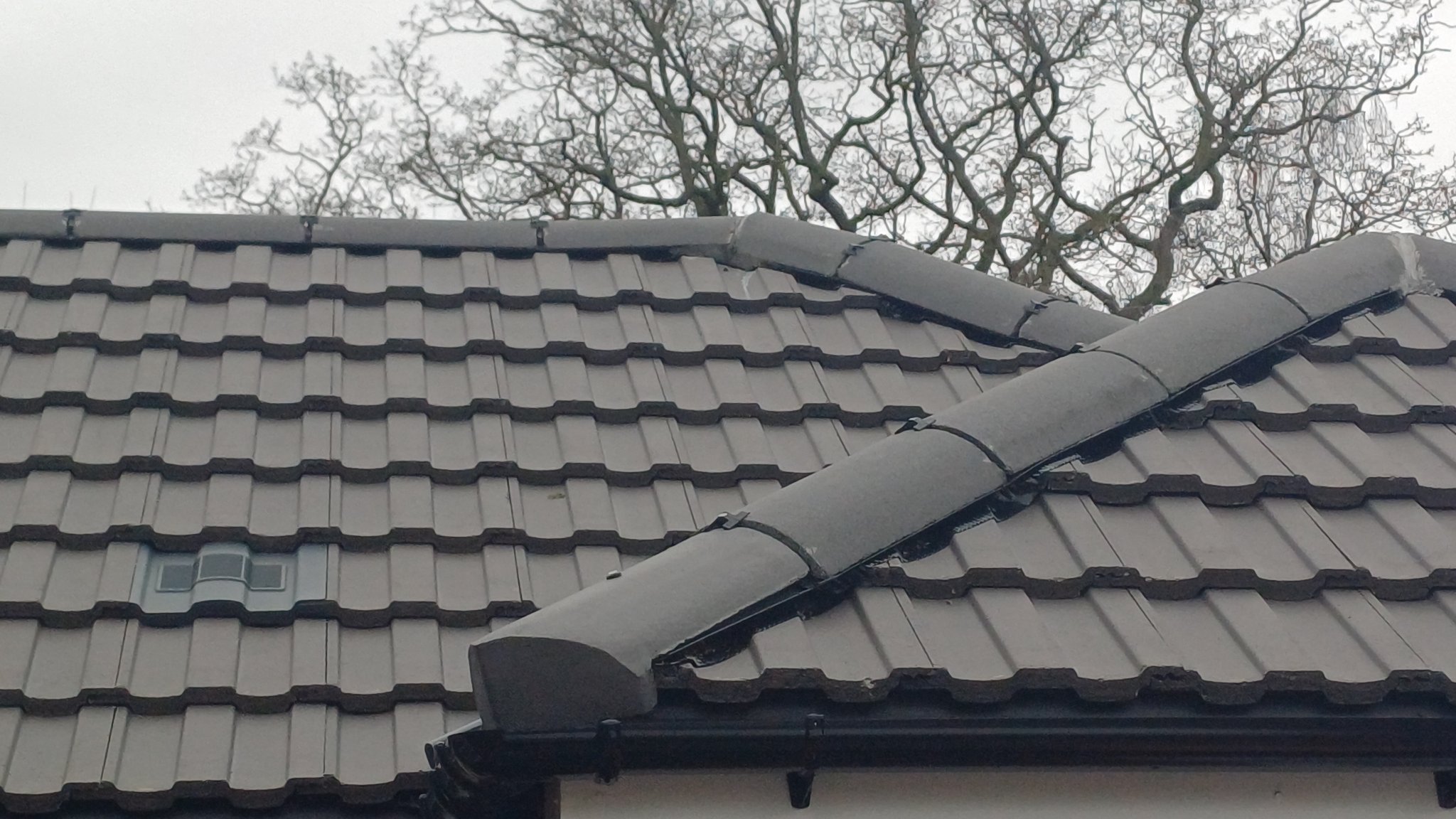

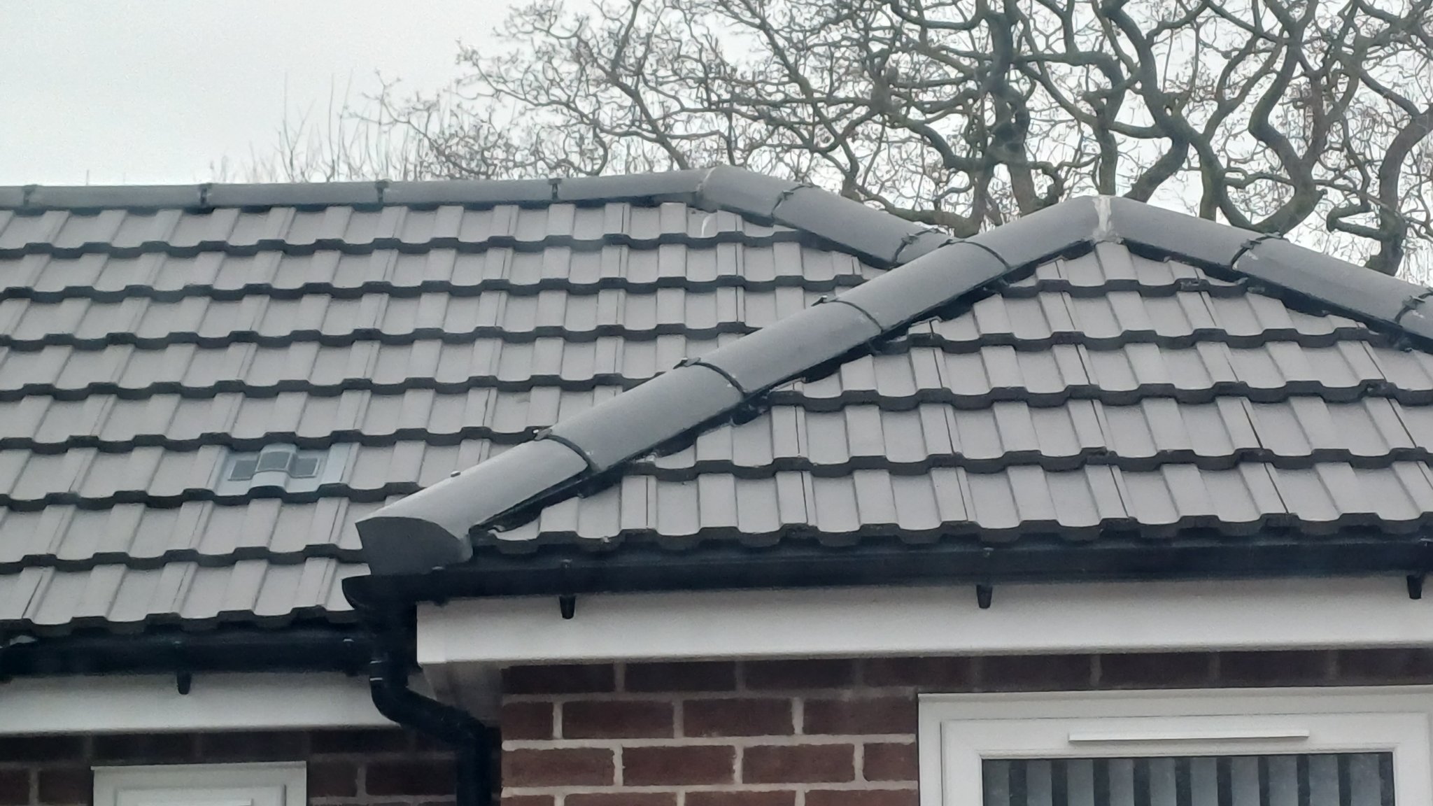

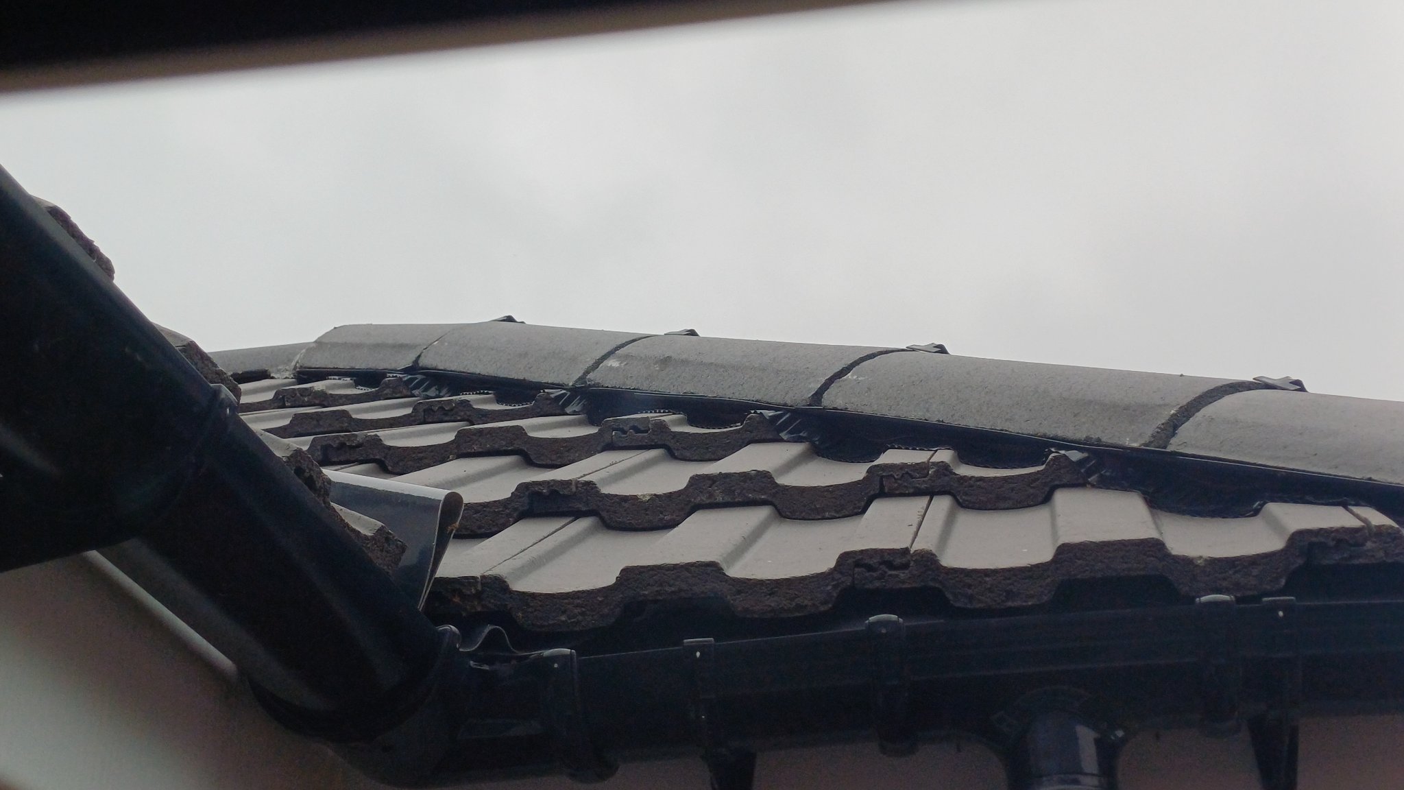

Hi everyone,

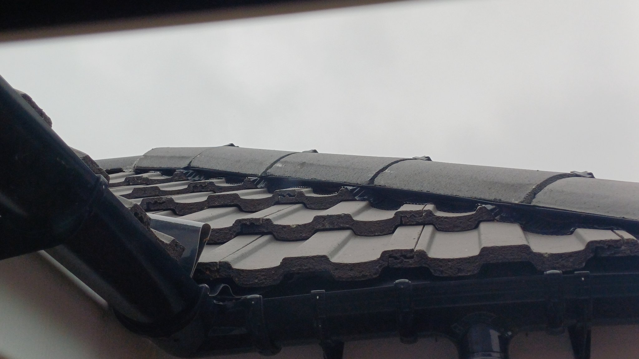

I had an extension added to my house last year which has a hipped roof. The builder has used half rounds on the hip slopes instead of third rounds. Does this matter from a practical point of view? It means they finish lower along their sides and make contact to some extent with the dry ridge materials beneath. Is this likely to do harm? I suppose you could argue that there is more cover from rain compared to thirds..? The main issue I can see is aesthetic as it doesn't look the best where the hip slopes meet the top ridge and he has had a harder time blending them because the halves on the hip end up a bit higher than thirds would have.

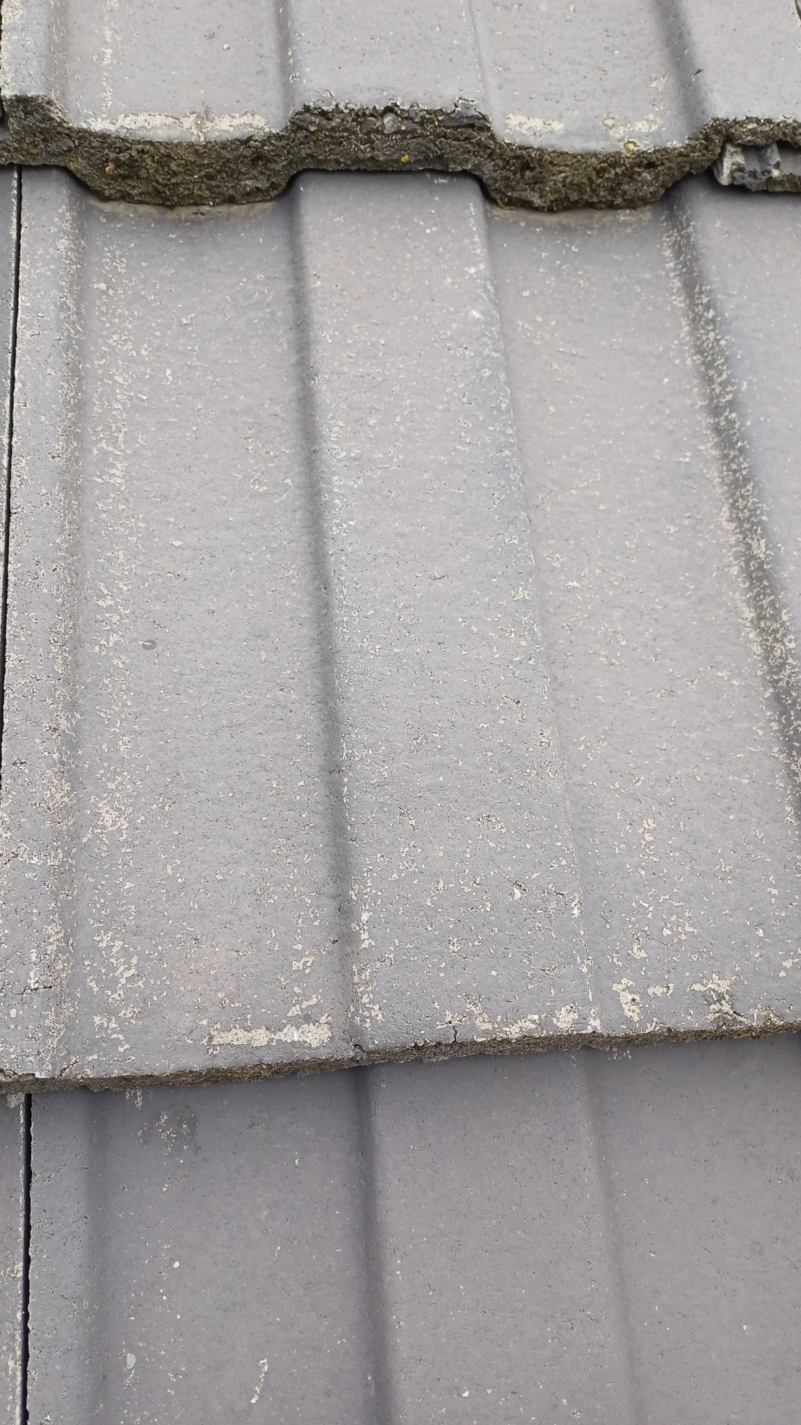

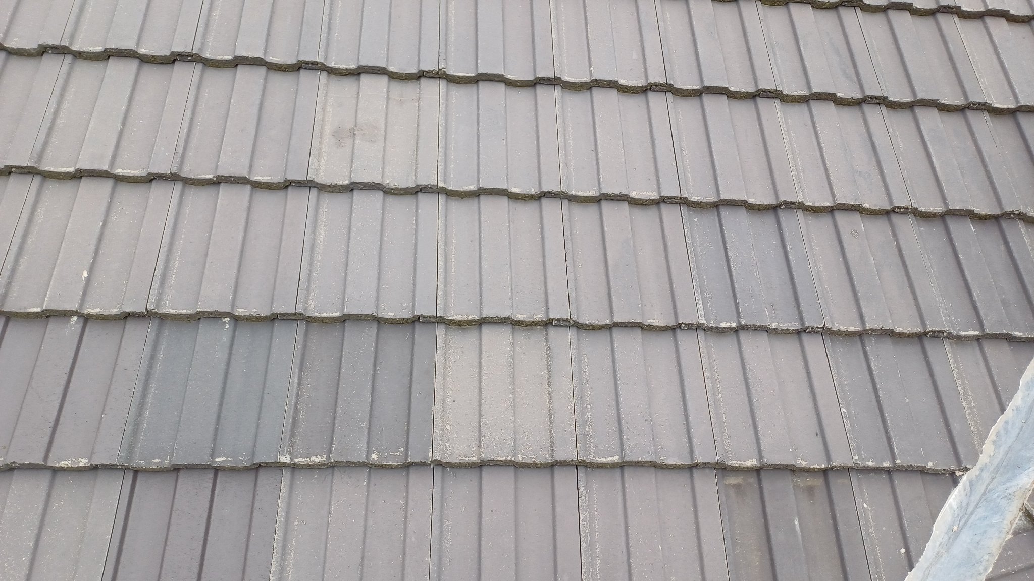

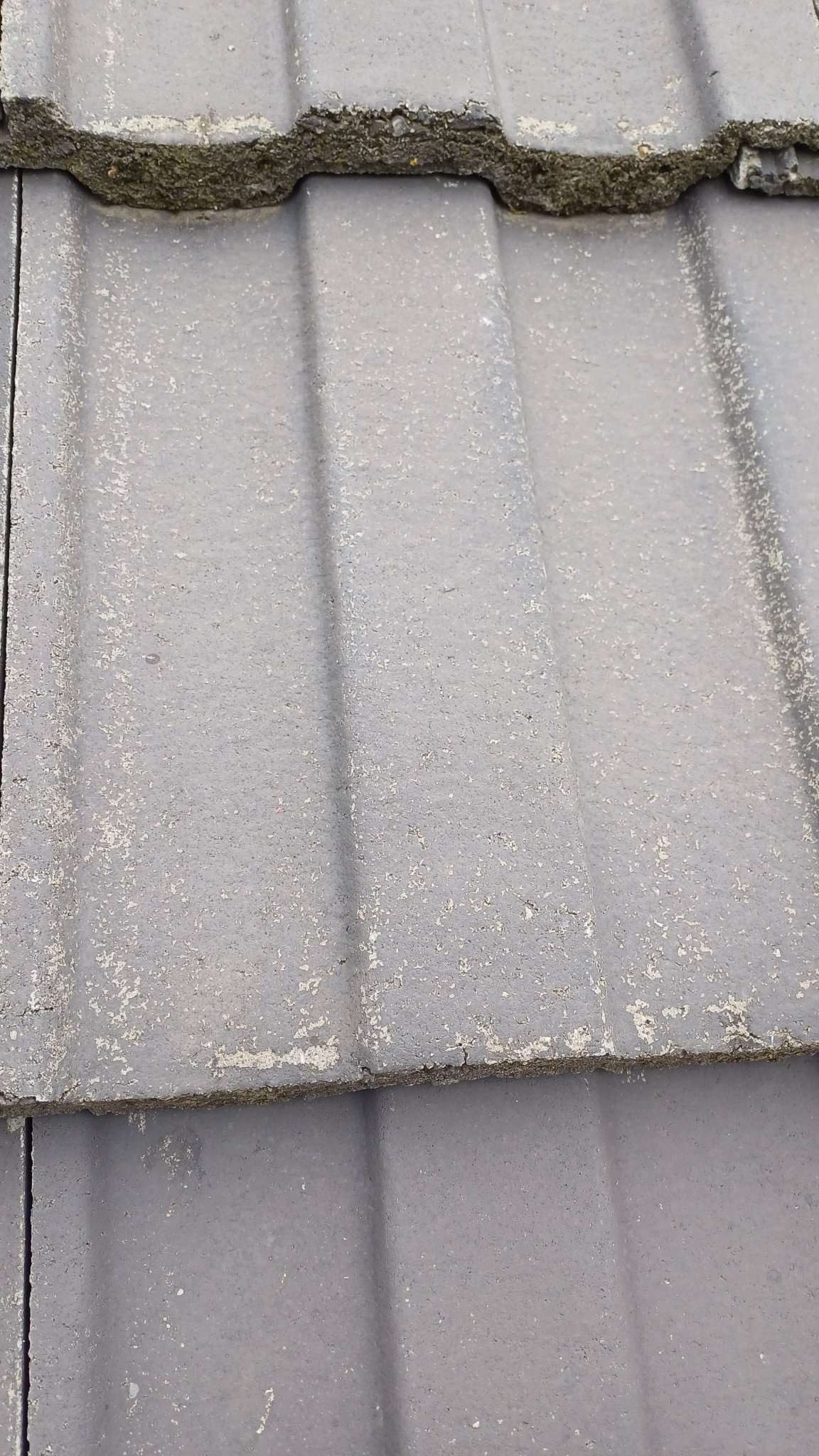

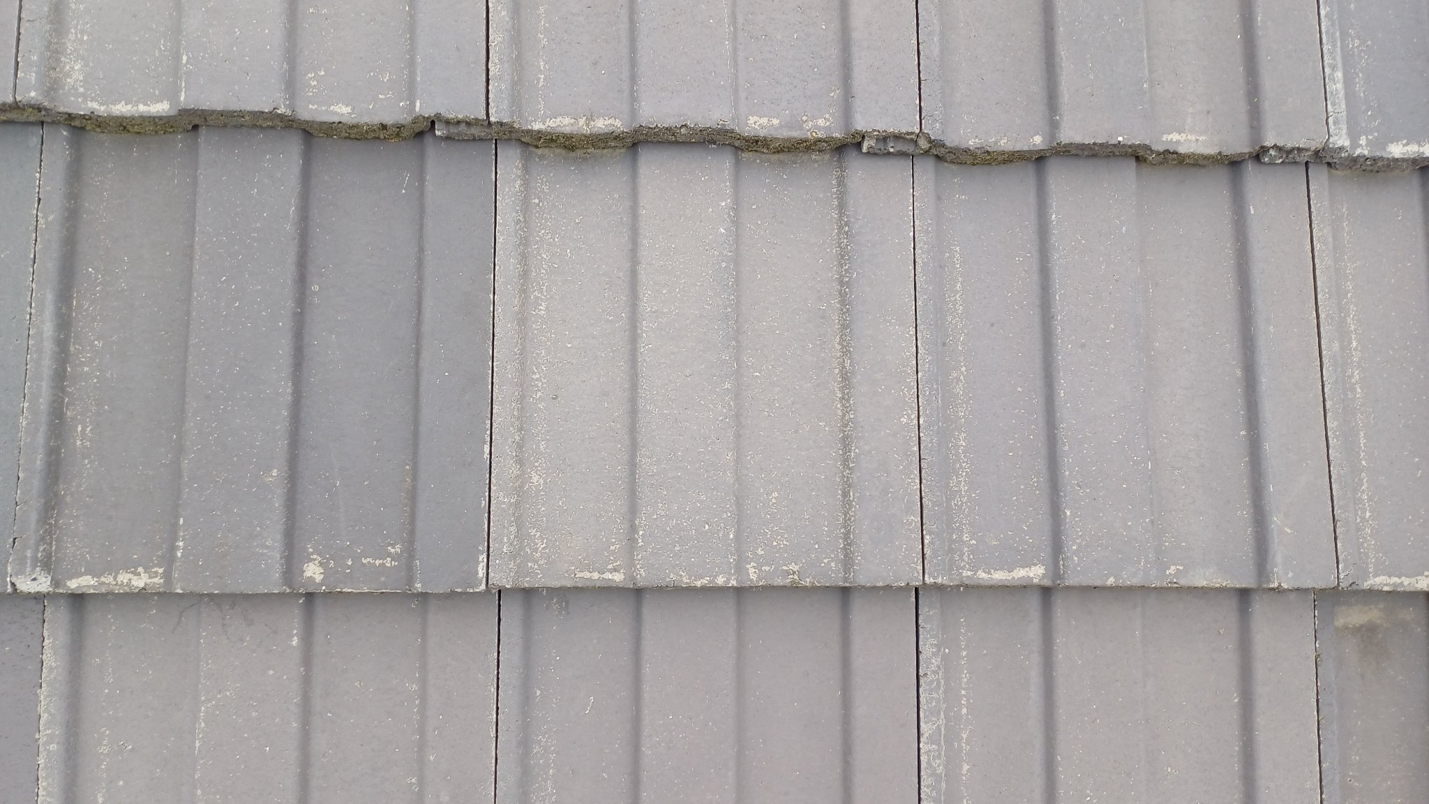

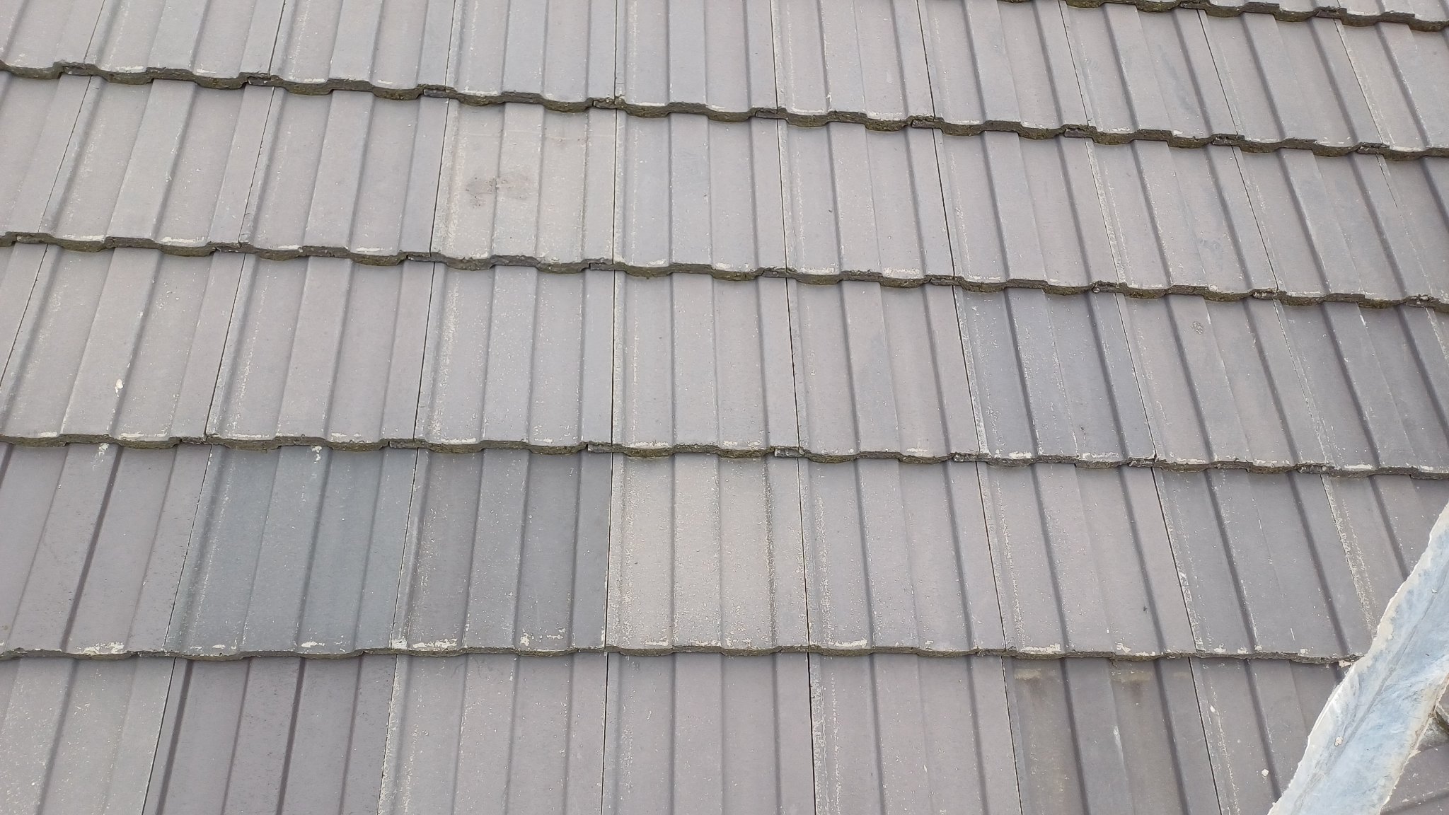

Also, on a separate note, I had the rest of my roof recovered with new tiles just under three years ago. The colour retention has been bloody awful. What should be anthracite grey is now more like a pail grey and it looks like only a matter of a few years more before the paint has come off completely. Any suggestions on how to remedy this?
Thanks!
not all manufacturers make third round hips . these look like Marley major tiles . Marley for one don't do third round .
one comment , looks like hip trays are missing

It just looks like your roof er is a bit lazy with lining up. The junction at the hip-ridge interface is always a bit clunky so you try and minimise the effect with a wee bit of jiggery.
It's because he has used half rounds on the hip. Had he used thirds, which are available, these would have met the halves on the top ridge with less height difference to make up between them.
Marley do make third rounds.
There are hip trays but you can't see them because the larger half tiles used on the hip cover them up more than thirds would.
