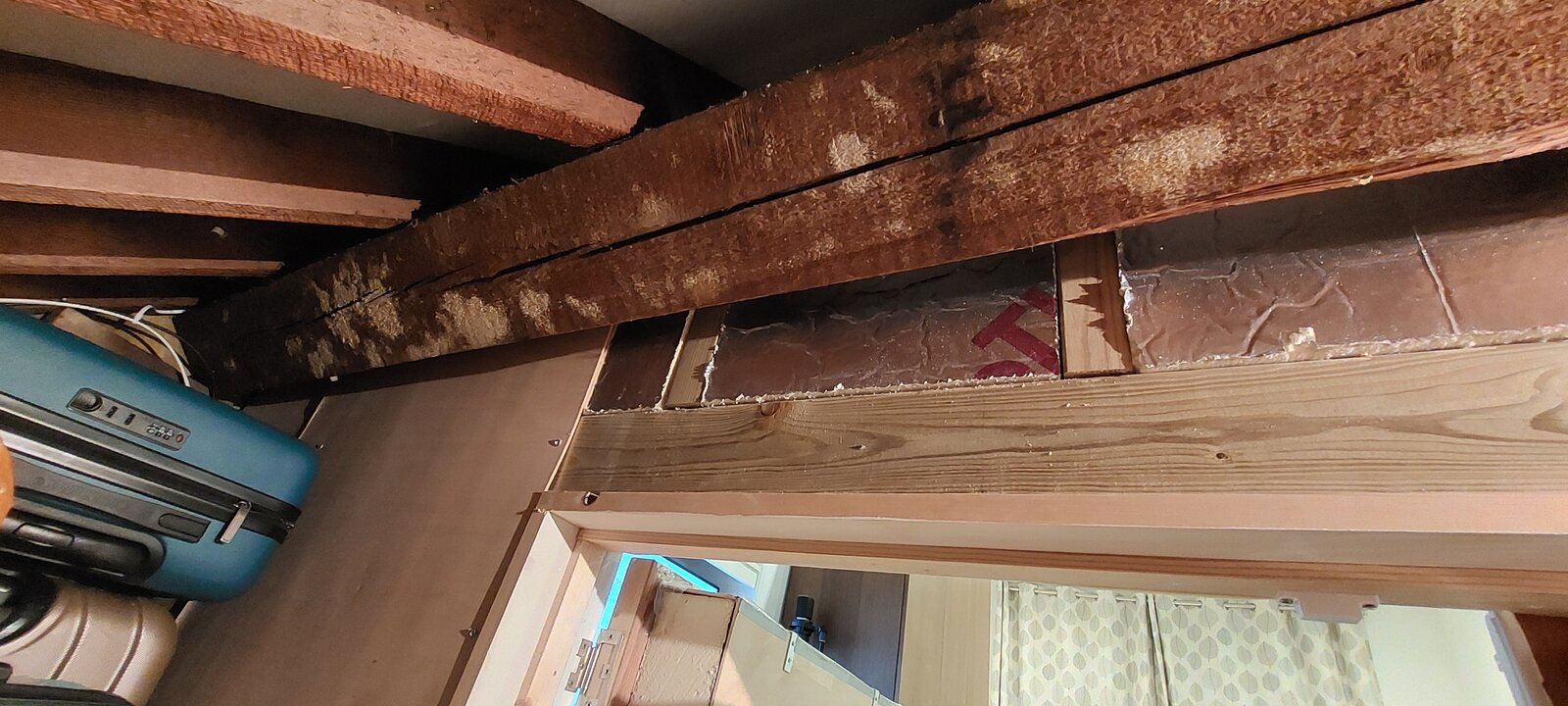

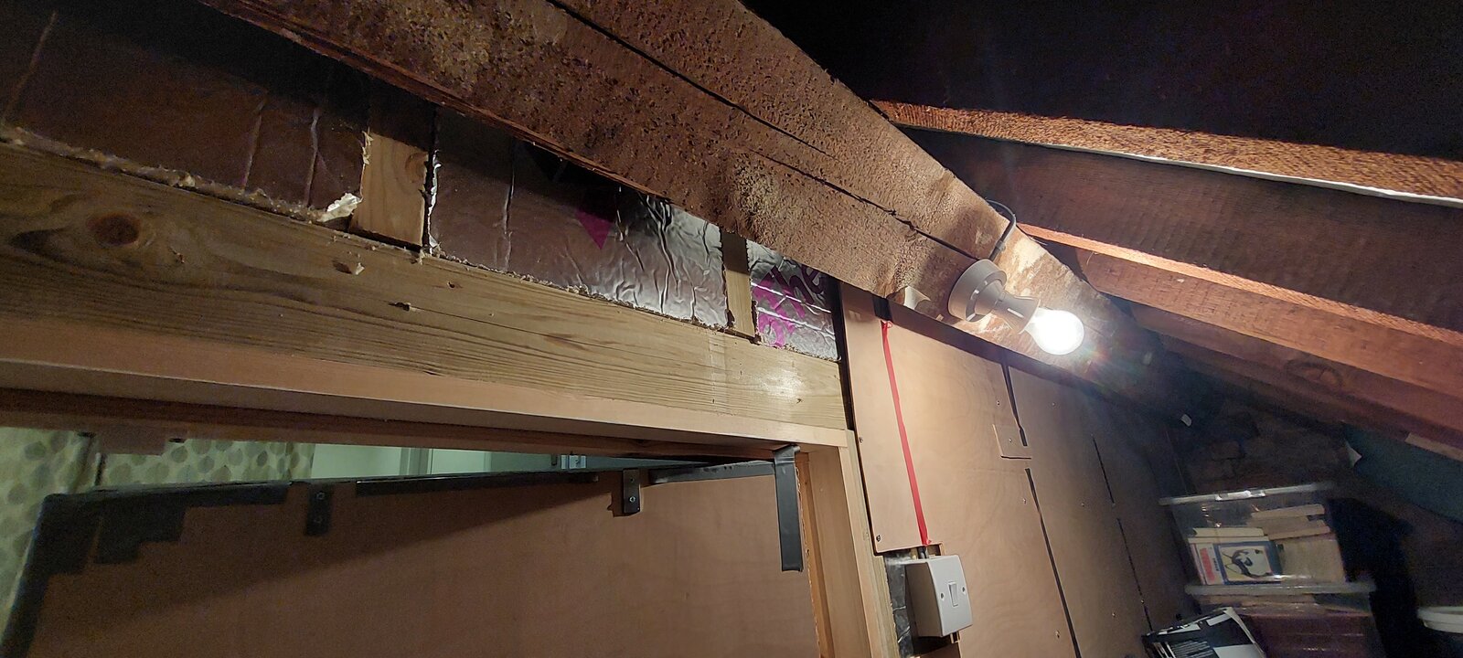

Hi - I live in a 1920s terraced house with a loft conversion. Inside the front eaves space, which is used for storage, there is a crossbeam running the whole width of the house about 3ft above the loft floor level.
I have noticed growing patches of light dusty wood on the beam, and splits along its centre that are slowly growing in number and now run almost the whole length of the beam.
There are no obvious signs of instability or movement anywhere, but it is a concern. Any insight into what this issue is, and how serious it might be, would be appreciated.

If the loft conversion structure was calculated by a structural engineer, I wouldn't worry.
The vertical structure that you can see in your pictures should take the roof load off that beam which I suppose has been left in place because it's hidden inside the eaves cabinets.
Can't really see what the white spots are, never seen such thing.
Is it damp in there?
Looks like the old purlin has been incorporated in the new ashlar wall, so it won't be a problem.
Those spot will be remnants of the original roof torching.

No it's not damp, in fact the wood seems very dry. The patches are powdery to touch and have appeared in the last 6-12 months - am slightly concerned they could be insect related and therefore prone to spreading to other rafters...
The light spots have only appeared in the last 6-12 months and are powdery to touch (we've been in the property 14 yrs). Could they be insect related?
The loft conversion was done 2017.
