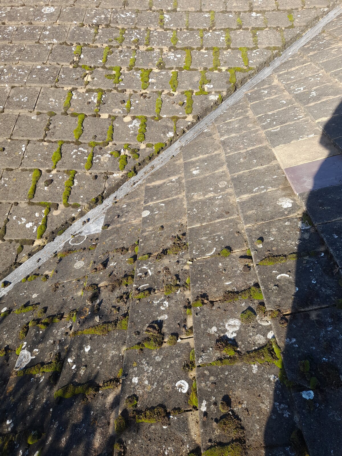

All the pics I can manage at moment as roof still a bit slippy

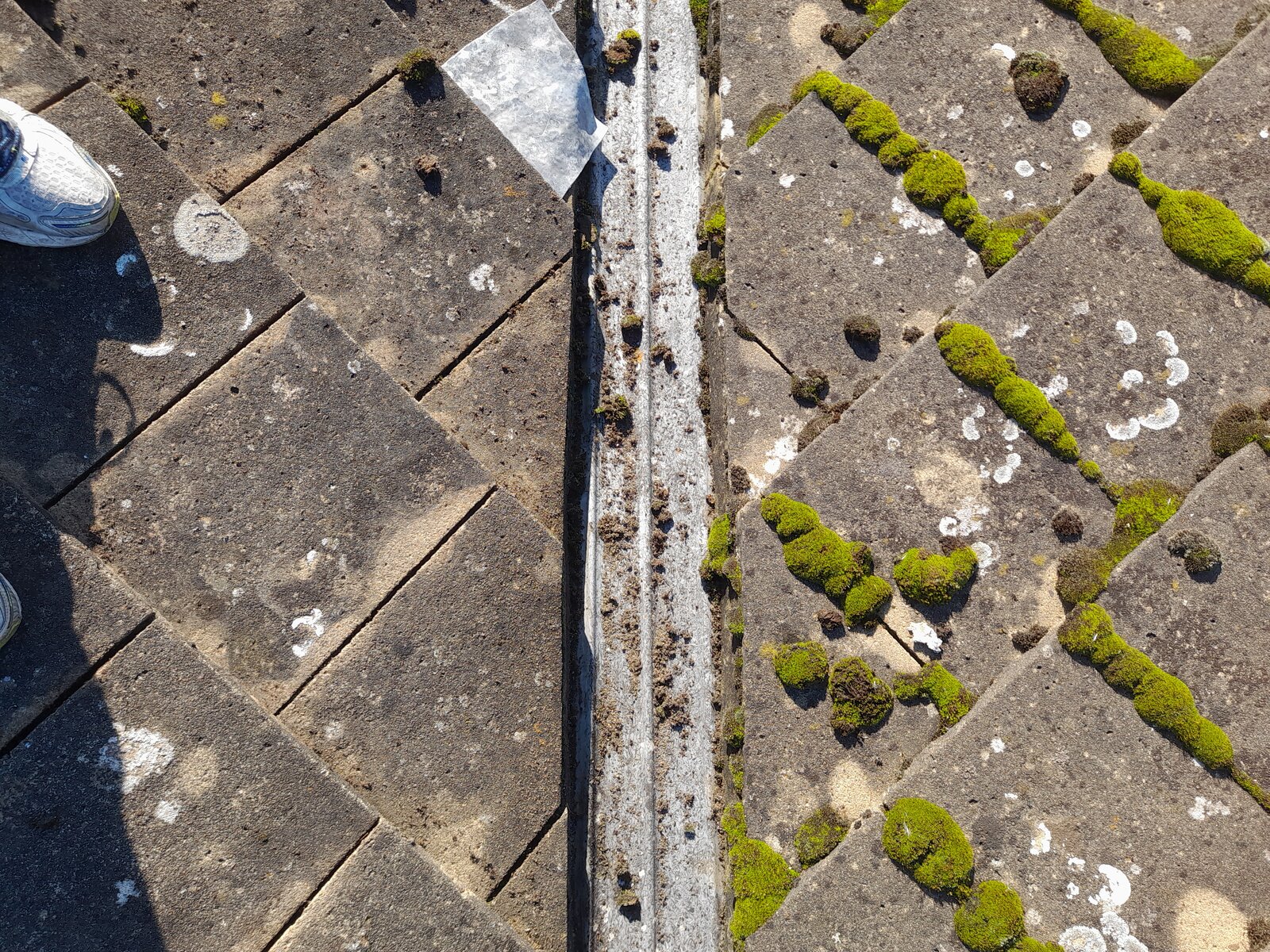

Is this the original valley you mentioned?
The edge pointing is failing but its hard to see it clearly? Plus a missing cut tile.
Otherwise it appears to be a well constructed valley with well cut tiles.
All the moss needs to be removed - it needs to be done manually.
Do you actually have a lead valley - if you clean off the moss & debris for 300mm from the valley pointing, & post a pic then things might be a little more clear?

Ree this is the same valley mentioned at the beginning of this thread. Its defo a grp one. There is a cracked tile below lead, I just put that on temporarily until I fit a new one. Will post a pic of damage in loft tomorrow. Can't get to eaves as next doors lean to with a perspex roof is in the way. When I pulled some of the tiles off you could see that the mortar under the valley did not have a gap behind for water to get by, it was spilling over the edge of the grp.
There is definitely too wide a gap between the tiles down each side . If you zoom in too the tile with the lead you can see that the mortar and tile are back from the rib if the grp.

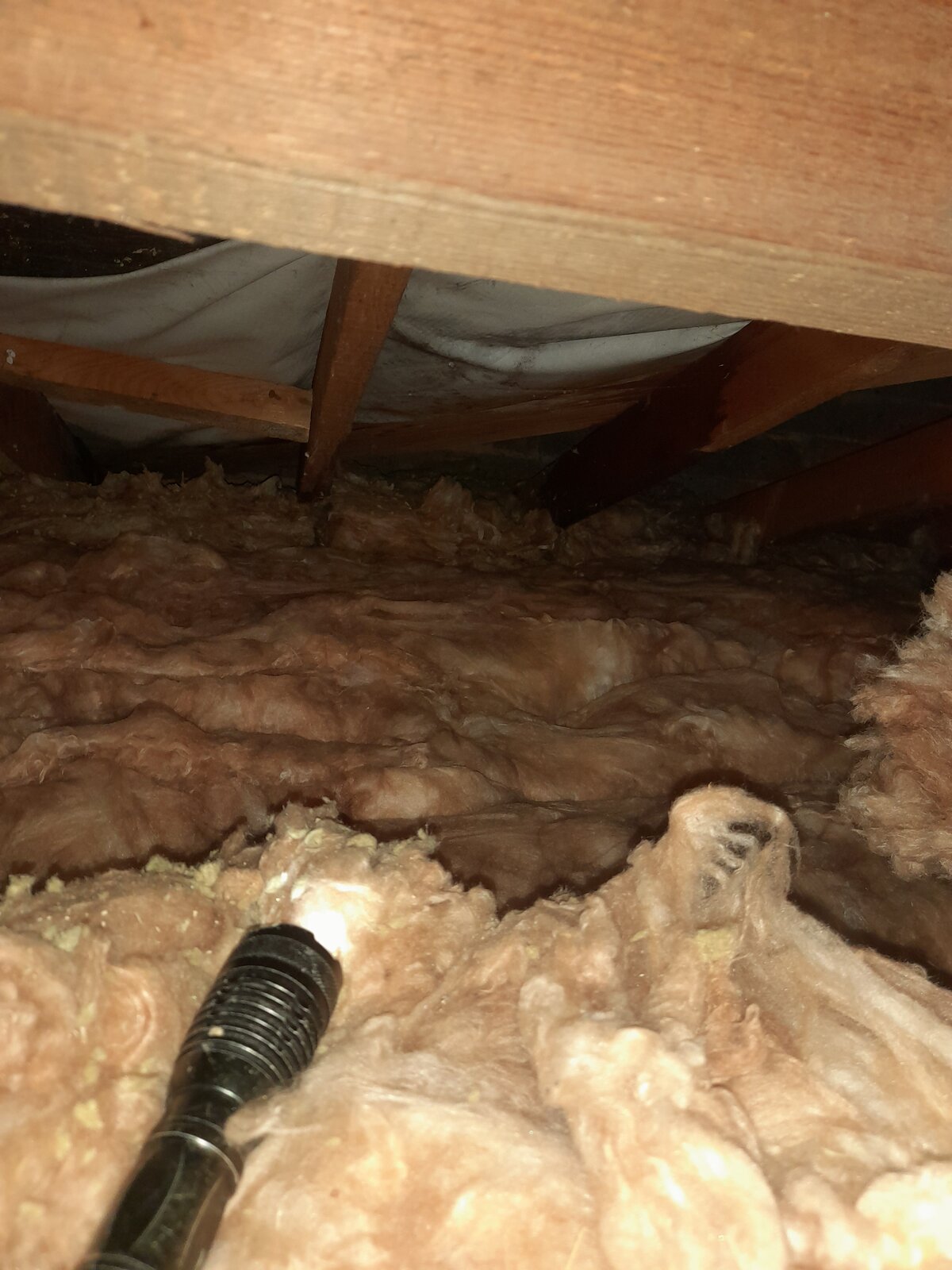

Water on this rafter as well now after I had cleared moss off roof and moss between valley mortar and tile.
OP,
Thanks for the pic - but it doesn't take me much further in terms of identifying how the valley carpentry was constructed?
I can barely see what might be sagging black roofing felt?
And the makeshift white sheet thats maybe pooling water - did you insert the sheet or is it original?
