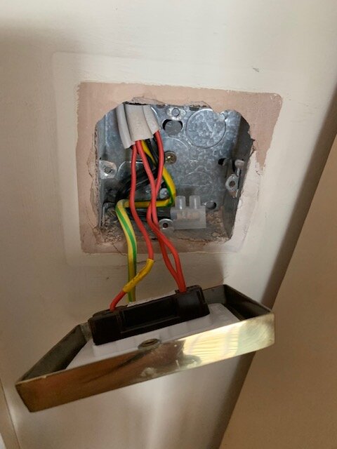

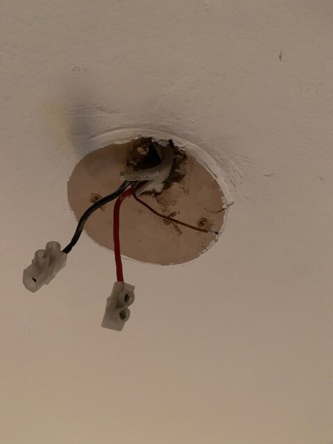

The ceiling room light flickered and then went out. I checked the bulb on another light and it is working. I tried another bulb but the light still doesn't work. Fuses not tripped. I checked the connections of the bulb holder and at the ceiling rose and they are all ok. I connected another bulb holder but still no light. The room switch controls only this light. When I switch on, the brown wire becomes live but the blue stays dead even when a working bulb is used. What else can I check?

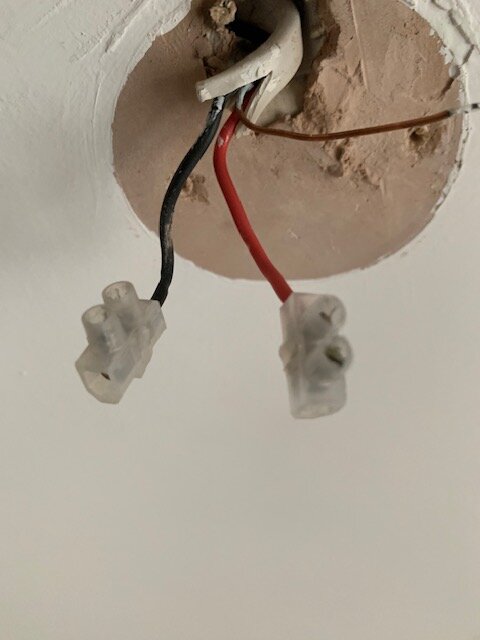

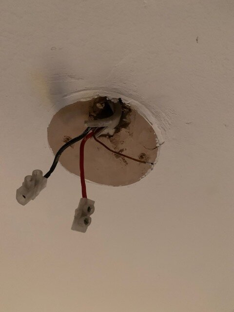

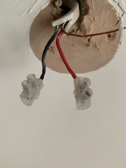

Can you show us some pics of the wiring / ceiling light ?
Not enough light but if it is no good I will try again
Not much to go wrong there, other than both connector blocks screws being tight against the copper wires ,and the bare copper earth conductor should be sleeved in green/ yellow.
Is it a basic pendant and rose that you have removed ?
Yes, both metal to look ..old fashion. It was working for almost 20 years.

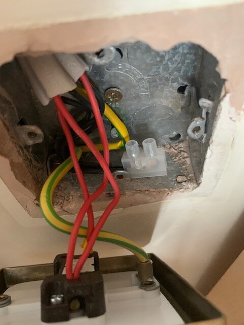

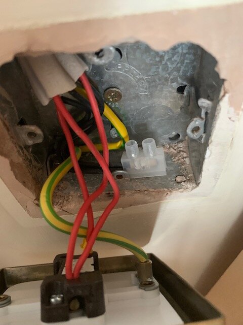

In case the fault is at the switch?

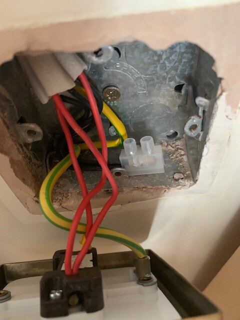

You can either obtain a testing instrument, as already advised ,or engage an electrician. Nothing visually looks out of the ordinary on the pics you have posted so far.
I suggest that with the power off, you try this: First and very important, mark the red on its own(this is your switched wire, Then put all red wires into one terminal.
when power is restored thi light may be on, indicating a faulty switch

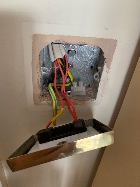

Thank you for the advice. I tested the switch with the Draper screwdriver: when the switch is off, the top red wires are live but the bottom, also red wire is off. When I switch it on both bottom and top red wires are live. The switch only have red wires, the black are not connected to the switch. However, at the ceiling rose there is one red and one black. The red shows light on the Draper and the black remains dead whether the switch is off or on. Given that the switch has only red wires and the ceiling rose one red and one blue, maybe there is another connection in the loft that it is not healthy? I would be grateful for an opinion please.
