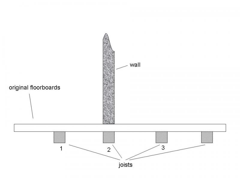

Hi Tony,

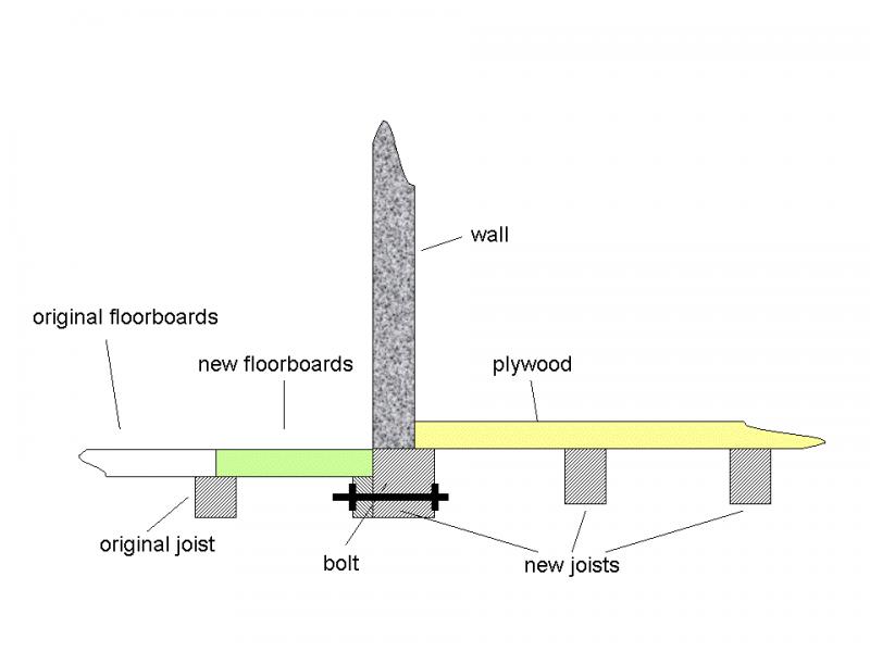

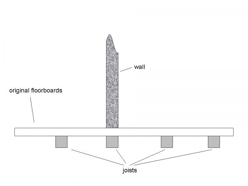

Yes, exactly, the problem was how to squeeze the new floorboards between the joists and the wall. We didn't. Here are diagrams of the original construction and the new one.
All the joists in the bathroom were rotten and had to be changed, so it wasn't a problem to level them with the joist under the wall.
In your case if there is no joist under the wall, I would put one. Something like this perhaps
You can bolt the separate parts through vertically. Replace the rotten joists, put noggins between the closest joists from both sides of the wall, attach the newly engineered joist to the noggins directly under the wall and you can screw the new floorboards to the protruding part of that joist.

Many thanks, again, vv2806, great diagrams! Is till don't see how, if you have a gap between the upper and lower wall, where the joist has rotted away and you remove the floorboards, you can replace the joist and still get a snug fit between the two walls so that the upper wall is supported properly.
I think I will only have a short section of joist to replace (fingers crossed!) under the wall. All other joists are fine and I don't want to be replacing all the joist in the bathroom, so your first option will not work for me. Your second option I sort of understand but still don't see how to get a snug fit as discussed above.

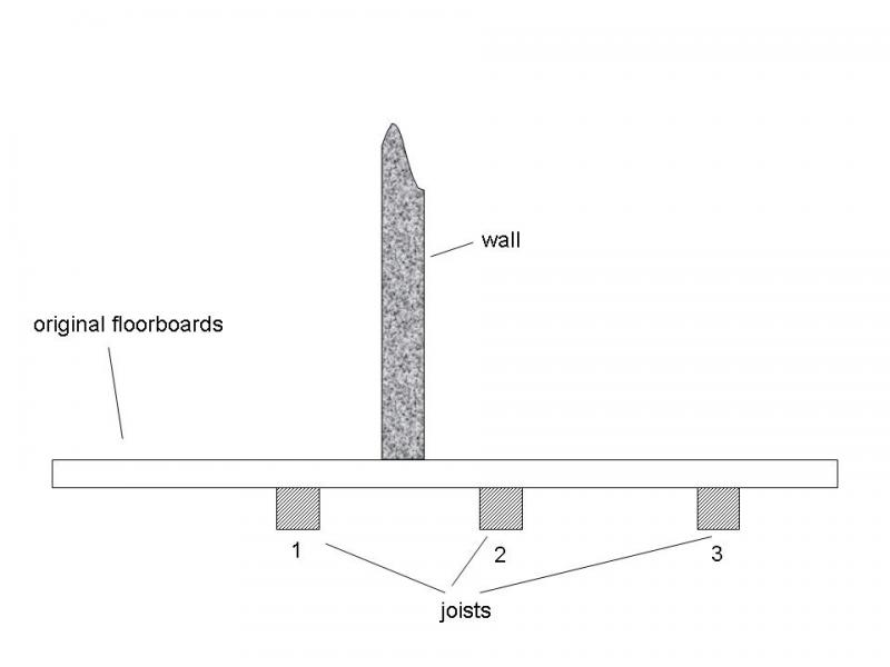

Tony, I am a little bit confused about what exactly you are asking. Here are 2 diagrams, which of them shows the situation in your flat? Which joists are rotten - number 1, 2, 3? Is the wall solid masonry or a stud wall?
Tony - you seem a bit fixated on having the floorboards running under the upstairs wall the way they used to. There's no need for this. All you have to do is whack into the gap where the joist has rotted away a piece of timber that is the thickness of the original boards + joist. Doesn't even need to be 1 piece of wood. You could build it up from separate slices.
Then follow Joe90's advice about splinting new joists both sides of the old one, possibly using joist hangers at the wall end. New floor will finish at the wall, not under it.
My house has got several walls like yours and the only reason for them is builders saving time and money. There's no need to replicate what was there before.
Sorry, vv2806, not having a drawing makes it a bit confusing. It is the same as your first diagram and it is joist number 2 that has rotted. The wall is masonry - probably about 4 inches thick.
