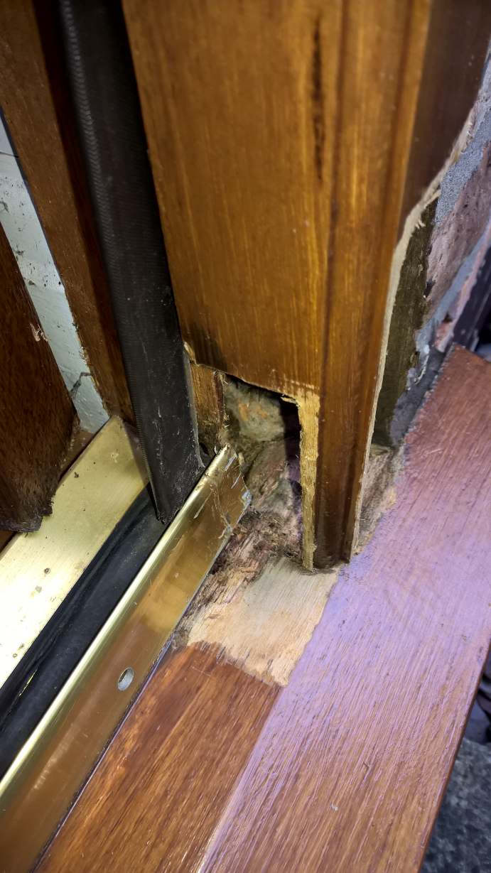

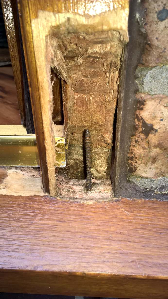

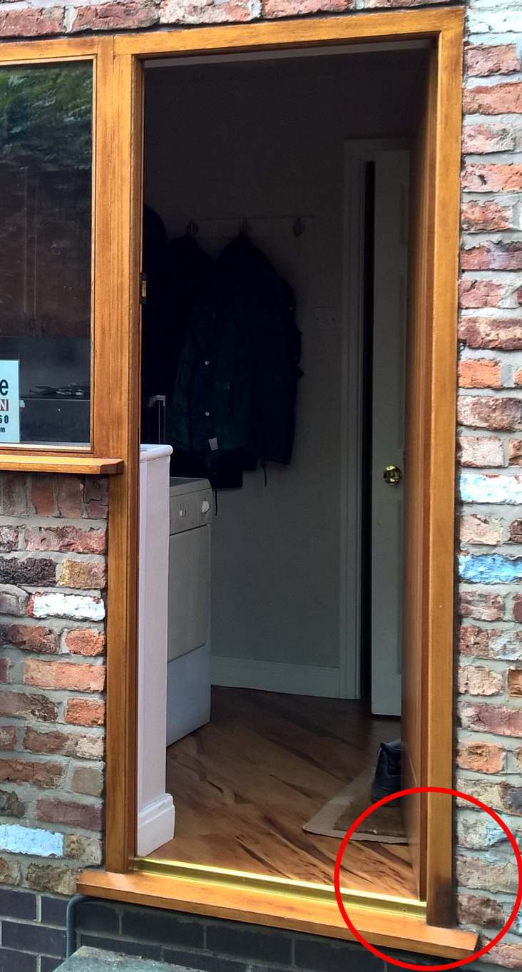

Hello,
I have a hard wood door and frame (Sapele) on the rear of the house. It's about 12 years old. It's re-painted with Saddolin exterior timber paint every 3 years or so. I do follow the instructions on the tin.
I noticed the bottom of the frame was going dark and there was water beneath the paint, so I used a (blunt) painters scraping knife to pull the paint back. While doing this I noticed the wood was very soft. You could just push the scraping knife right in.
So....I went digging to see how much of the frame was rotten. About 6 inches on one side, all the way back.. Pictures attached.
It looks as though water has run into the weather strip from the door and on the frame at the bottom. I should have added a drip strip to the door when it was fitted 12 years ago, and a porch roof so it's not wet every time it rains. Live and learn.
My question is; can this be repaired? It will need a new block of hardwood knocking in with waterproof PVA. It will then need to be stained again to match the rest of the door and frame (both Sapele). Maybe do both side of the frame so it all matches. Seems a shame to condemn the whole installation just because of 6 inches of rot. The actual door is fine. What do you think?

Thanks for the reply.
I've telephoned few joinery businesses and none are interested. They only want to create a whole frame. The term for cutting out and replacing the bottom leg of a frame is called 'splicing', so I'm told. That means a day of installation and a whole lot of painting to get it to match the door.
This seems to be a common problem for external timber frames. Of all the videos I've seen on youtube about this, people are painting the frame a flat opaque colour and this hides any differences in the new timber spliced in. If you have a light stained frame like mine then it's many times more difficult. The stain has been built up over many years using different stain types. Even if you could get the same timber, you'd need a specialist to match it, or just keep applying paint every 24 hours until it looks right.
Then there's the issue of the edge profile to match. It's not a simple right angle. Custom frame (recessed edge), so I have no idea where to get the profile used.
I'm beginning to see why people love UPVC / Composite external doors.
Looks like I'm going to have to botch it, or go for a whole new frame. If the frame is write off then I may as well try the botch first. Thinking cap on....

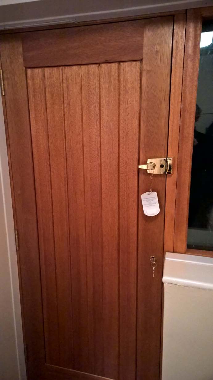

A few questions
  • Why do you think you need the adjoining window, your first pic shows they are two seperate frames
  • Why do you need custom, is the opening brick size not standard, what size is the door itself
  • B&Q/Howdens sell off the shelf hardwood self assembly frames(4 piece) in stock for £50/80, why are you trying to buy just the jambs?
A few questions
I've attached a picture of the door & window from the inside. The frame of both is visible. Notice how it's all flush and stained the same colour. That's the appeal, at least to me. It looks nice. I want to keep that. If I just replace the door frame, it has to be the exact same depth front to back, or the new door frame is going to be shallow / proud. I want to avoid that. The depth of the door frame is 95mm. This appears to be a non-standard size. Howdens go up to 90mm in hardwood. So...if replace the door frame, then it makes sense to do the window frame as well, so it will remain flush & look as though it matches, but only because I cannot find a frame that's the exact same depth as existing.

Finally finished the repair during the hot weather.
Had a new jamb made. 60 Quid. They couldn't match the timber and the new jamb was darker so I had to re-stain the rest of the frame to match.
I can understand why the joiners I had round to quote only wanted to fit a new frame. Pulling out the old jamb without wrecking the existing frame was time consuming. M&T joint with a long screw on top of that. Then digging out all the rotten timber and cutting new timber down to fill the large hole. Rotted wood hardener. Two part filler on top of that. Then sanding. Cutting the new jamb profile with a chisel (it's not just a right angle cut - see pictures).
Used four 6 inch PH3 screws to hold the new jamb to the wall (hidden by timber plugs) in and made a make shift M&T joint using some plugs on the base of the jam. There's no other way to create a M&T joint (that I know of) *without* pulling the frame out and apart. Using screws on the base not an option. That's why the frame rotted in the first place. Waterproof PVA top and bottom duing install as well.
The door is solid hard wood. 30KG at least. Was a pain to re-hang. I'd forgotten how to hang a door and it took me all day by myself to get it to close properly ;-O Almost needed back physio. No joke.
For anyone that's interested, the frame rotted because the joiner that put the aluminium weather guard in on the threshold used screws. Water runs down the door into the alu guard and out to the ends where the screws were. There's a hole in the alu guard but that doesn't seem to work very well. After chopping out the old jamb, the rest of it was fine, so the paint did its job of protecting the timber.
Removal and fitting took 3 days with another 3 for staining (24hr between coats).
Pictures attached.
