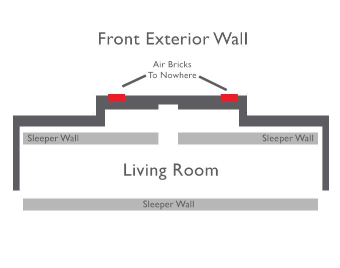

I've finally removed all of the timber from the floor, and I've found the source of the problem... which is that the air bricks don't actually go anywhere!
The front wall is three bricks thick at the foot of the small bay window, and on the outside there is one air brick in either corner of the bay. However, on the inside there's no correlating hole. There's a gap in the bricks in the middle of the bay that's two bricks deep, and this just dead-ends against the outer wall. The sleeper wall nearest the bay also has a venting gap in the middle, but none of the others have.
It makes no sense. I even had a rummage around, to see if there was an early rudimentary cavity wall that the air bricks channeled into for some reason... but nothing. The sub-floor has never ever had ventilation, except for when it collapses every 50 or so years.

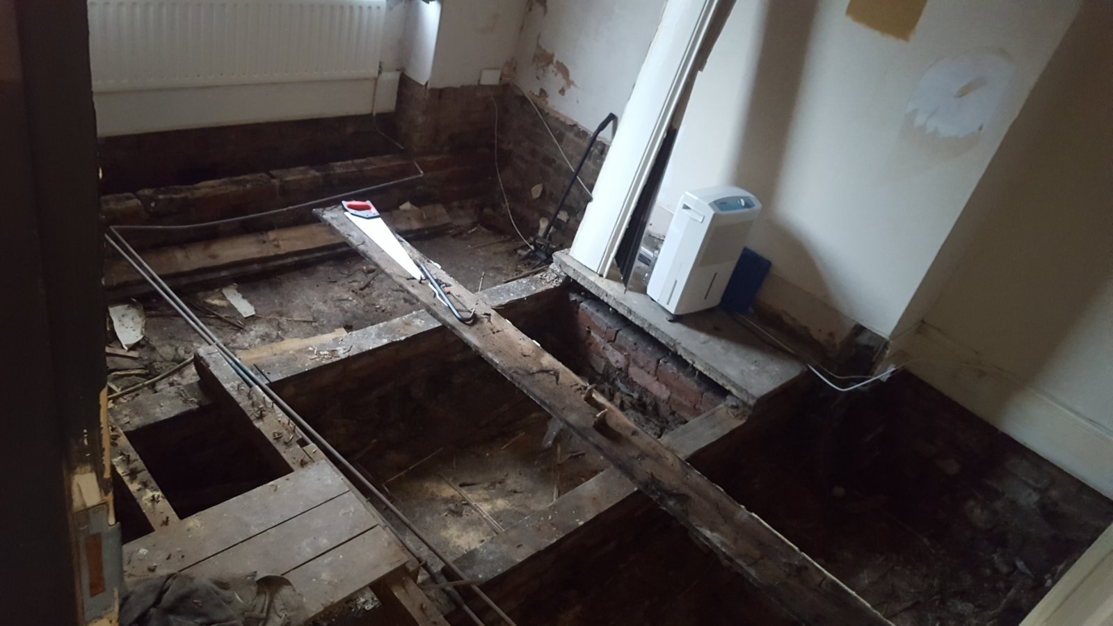

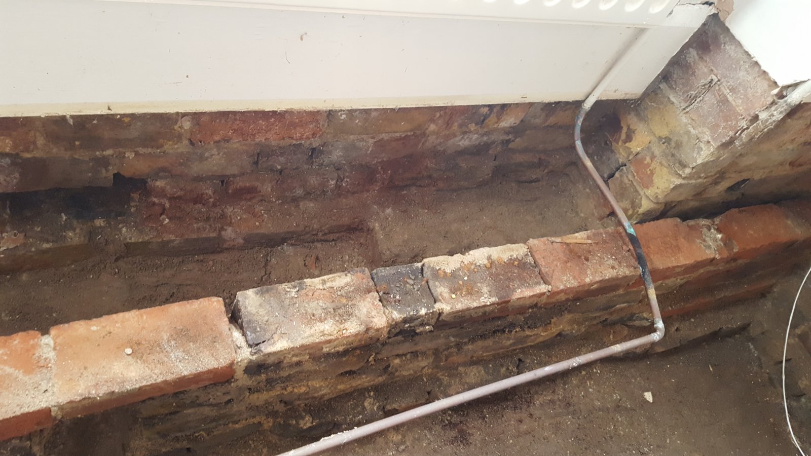

I've knocked out a few bricks from the sleeper walls to aid ventilation, and it turns out that there was a DPC... or an attempt at one.
There were engineering bricks, but not laid in a single, continuous course - just dotted about at random. And then there were some layers of a bituminous substance used as a mortar, but again not forming a continuous layer - just blobbed between some of the bricks at random intervals. The wall between living room and dining room does have a layer of bitumen right along the base of it, but not the other three walls.

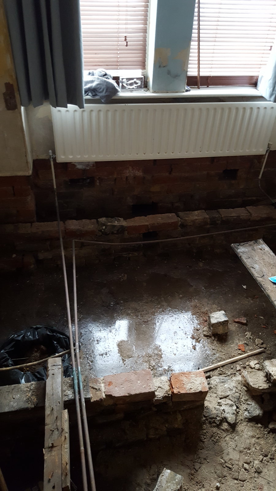

Okay, everything's been given a thorough scrape-out and sweep down. A few unearthed revelations...

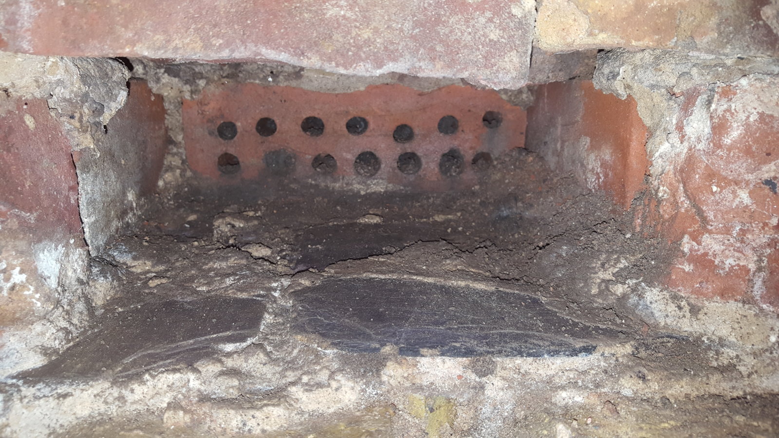

The hole in the middle of the bay leads to a perforated brick that butts up against the soil outside, and the hole is actually a slate-lined channel. What would be the function of actively letting ground water into the subfloor, as this must?
Also, there are holes for the air-bricks... they're just much higher up the wall than I thought they would be and are mostly covered by the skirting board. The street is on a slight slope, with my house near the top, and with subsequent houses in the terrace getting larger steps to their front door as the ground falls away. I assume, rather than dig out the ground, they just crammed the air bricks in.
Would chiseling a slope into the lower bricks to create more of a hole below the floor be useful?
Also, I noticed that the foundation of the building seems to be engineering brick, and on top of this is a layer of slate - but it's all very much underneath ground level, and always would have been. Seems pointless, even more so with a perforated brick channelling water over these layers.

the knee wall nearest the bay is a later remedial measure.its not original.
why not knock it down and set your DPCwrapped joist tails in pockets cut in the brickwork like it would have been originaly.
you could also knock dpwn both middle knee walls and rebuild one true honeycombed knee wall in the ceentre of the span.

I think the sleeper wall nearest the bay is original - it's made of the same bodge of random engineering bricks and bitumen as the others. There's no indication that the joists were ever in pockets, except in the hallway. With regards honeycombing them properly, I've never actually done any bricklaying before and whilst I know they don't have to look pretty... I'd still rather not start mucking about too much with the structure of the building on my own. Currently, I've knocked out holes in the centres of the sleepers that are one brick wide and two bricks tall - a little larger than the hole in the sleeper nearest the bay.
The air bricks aren't completely covered by the skirting - it's about 50% in/out. At the moment, although it would be ideal, taking them lower or installing double-height ones would mean cutting out the concrete in the front garden. It's why I wondered about cutting a slope in the (internal) brick below, so when I've time/money to excavate the front garden a little I can fit in some larger air bricks.
The slate and bitumen is very much below ground level - they're right above the foundation where the bricks are arranged in wide tiers. It's possible there's another layer of slate buried in the mortar higher up, as the one I've found so far wasn't very obvious.
The joists in the alcoves are/were supported by a mini sleeper wall 1 brick wide built up against the breast.
fair enough, im wrong about that wall. thing is that three sleeper walls and a dividing wall will cut down on ventilation.
knee walls arent structural and brickwork can take lots of cut pockets.
true honeycomb gaps are often only half a brick openings staggered in each course of brick.
clean out the air holes in the air bricks and all the muck built up on the slate .

After about 12 hours of heavy rain, the living room is now a collection of very modest ponds (about 1-2cm deep) - no sign of it pouring in, or it being the product of a leak, but rather just seeping up where the ground is lowest. I guess a high water table would explain the squelchiness of the ground when the boards were first lifted.
I assume that adequate ventilation will be fine for dealing with this, and that putting a DPC on the soil itself, as has been suggested elsewhere, would just create permanent ponds?
