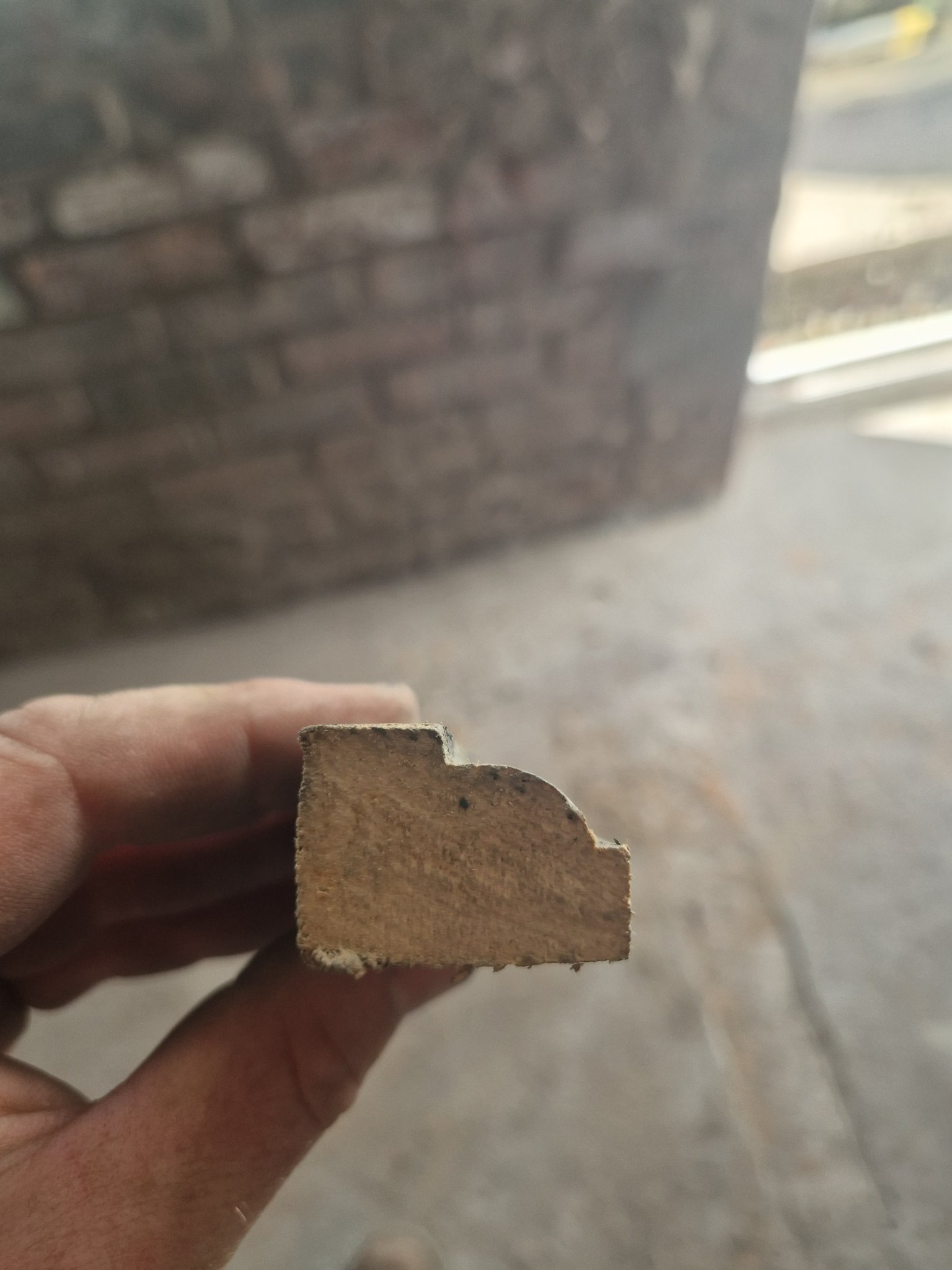

Hi guys got abit of rotten fascia board that has this detail on the end and then this sort of trim nailed onto
Can anyone guide me to the router bit needed to machine this detail on the end of the planks ?
Cheers
Go to the Axminster Tools website and search for "ovolo".
Ok thanks ive had a look there
I suppose there is diffrent ovolo depending on how much curve you want
Wealden have an extensive r and clear measurements on their website for the different sizes available
what is the radius ?
one of these "Round Over Bits" will probably do if the radiuses match - take the wheel off and set up a proper jig. One of the most dangerous tools in the workshop so make sure you know what you are doing!
