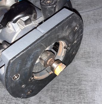

Can I ask what is the cause of the wood smoking when using a router.

Blunt cutter
Too slow feed speed
Wrong rpm
trying use a non plunge cutter for bottom cutting
deep cuts need several passes around half the shank in depth
say 44mm deep with a say half inch router would be around 6mm passes so 7 passes at 6.5mm or at a push 6 at 7.5mm deep
experiance will let you know iff 5 passes off 9mm are daft:whistle:

Thanks for the reply

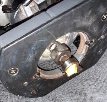

Is there anyway to tell if the cutter is blunt, I've hardly used it but have had it fir a while, I assumed(wrongly obviously) that feeding too fast would cause the smoking, the router only had one speed, I'm not plunging with it.
It's also worth cleaning your cutter. This is a bearing guided cutter which has been used - it isn't smoking, but you can see signs of resin (from the MDF) build-up on the cutter which is making it blunter and more likely to smoke:
A scorched blade will be dark brown to black and may be beyond redemption, however. Even a basic quick partial clean with squirt of WD40 and a quick scrub up with an old tooth brush cleans it up enough to get another few cuts done before it needs to be thoroughly cleaned:
The cutter should be sharp enough to be able to scrape some of your thumb nail away easily. The carbide faces shoud be clean.
Ciould you describe the cut you are doing (style of cutter - e.g straight or profiled, depth, width, material being cut, cuter material type - HSS or TCT) together with the router (watts) so that someone could give you better advice?

If you feed too slowly the cutter spends too long in contact with the wood that is eventually "burning", hence the resin build up.
