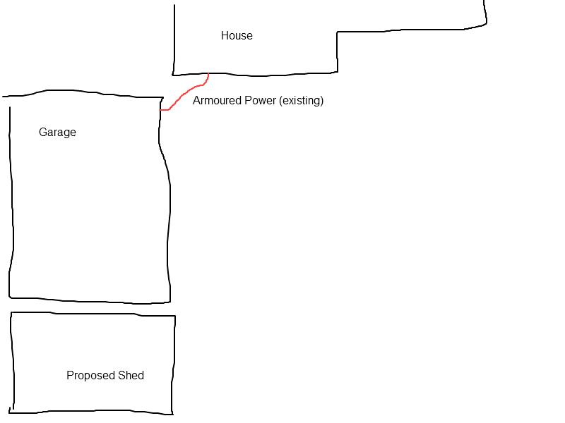

When I've finally got my garden office sorted (see other posts) I'll want to have access to my home network. Obviously wireless is an option, but the wireless signal in the garden is poor. My electrician will be laying armoured cable to the shed, so I'm wondering if there's some sort of equivalent for network cable? I could just piggy-back on the armoured elec cable...

So assuming this project goes ahead, what's the best way do you think of getting the Cat5E cable to the garage (see sketch above)? The area in front of the garage is block paving and the area behind the house, to right of garage, is flag stones. I really don't want to have to lift them.
Depends. Having put in a armoured mains cable to the garage at my parents and nothing else there is then a bit of an umbilical strung between the gap (circa 8ft) which has water and a network cable in it suspended on a cable.
Its not ideal, but its an option, even if you have to swap the suspened lenght of cable every 2-4years (terminate that cable in the house and garage in preparation for this). Otherwise, as you know, your looking at lifting some of the paving.
Daniel
Distance from corner of kitchen to corner of garage is a couple of feet so I guess an "umbilical" arrangement might work. And a good call to terminate the overhanging wire in the house and garage for easy replacement ;) I'll have a ponder. Thanks all for the tips.
