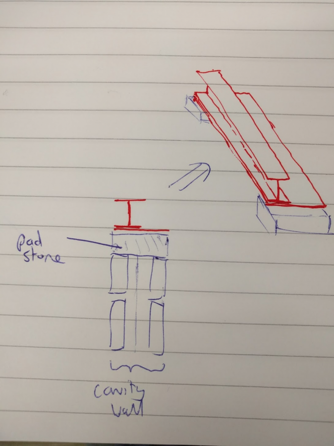

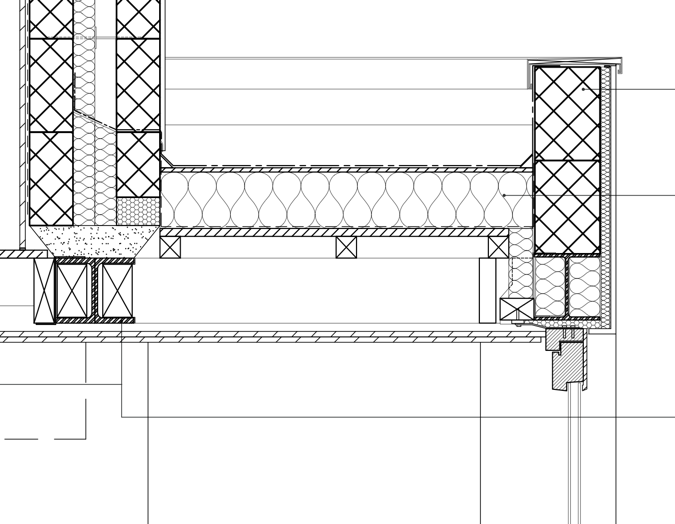

Here is a section through the beam as drawn (the one on the right), although the beam fitted is incorrect in that it has a extra wide bottom flange. You can see the insulation on the outside of the parapet it should supposedly cover the whole external wall and into the reveal.
Another useful point is that we haven't yet ordered the doors, so we can reduce the size of them no problem to fit insulation.
So you are going with a solid wall, why not put ewi on? 100/150mm of graphite eps. You have kind of mitigated the thermal bridge with your iwi in the roof.
Hi Tom thanks for replying again, that's helpful. Would you continue the graphite eps around into the top reveal and make the window frame 100mm smaller? To stop the heat conducting through the steel from inside to outside. If that, I'm not sure how to hang the window.

Hi Tom that's ok. The walls at the sides are 100mm concrete block, 50mm celotex, 50mm space, 100mm block.
See the attached sketch of the beam as fitted currently. I drew a kind of perpective view as well as the section to make it more clear hopefully.
Inside is the left hand side in both.
I see SHS is a square hollow section, I can always ask the SE to calculate for that and just pay for a replacement. But wouldn't they "fall off" the wall without some serious tying together? And I don't think I need a lintel on both leaves as the inside one doesn't actually need anything built over it.

Why hasn't the Architect specified a properly detailed solution without a thermal bridge, and why hasn't the SE taken this into account with his design?
You've got two numpties there without a clue between them.

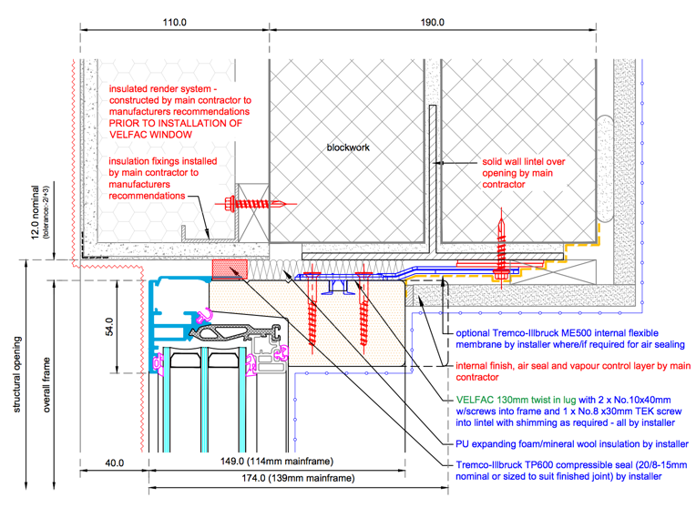

Good idea Tom, so more like this? (standard detail from the window supplier)
Whatever happened to a timber beam on the inside, and using the window frame on the outside?
At least that's how we did it when I started out.
If you need to extend the fixings out from the uc you can use some ply and stop it short of the external finish.
