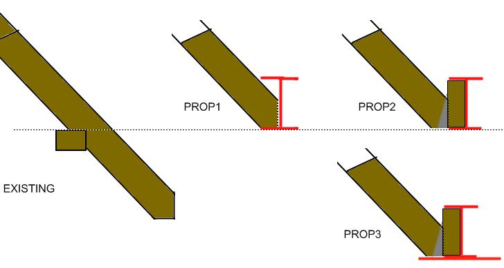

I think I have a problem with my plans the RSJ I'm using to support my rafters. Although my SE has proved it will take the loadings, the designer (me) didn't fully think through the installation in terms of rotational support.
The thought process was as follows:
In 'existing' on the diagram below, the rafter sits on the wall plate.
Proposed1 shows the initial concept where the rafters are trimmed at wall plate level then the existing birdsmouth is sat on the bottom flange of the RSJ.
Proposed2 is a progression on this concept to bolt a captive wooden joist into the RSJ so that hangers can be used, rather than having to fix noggins between every rafter.
This is where the problem lies. Because this joist is up at wall plate level there will be very little masonry to stop any downward force from the rafter feet rotating the joist counter-clockwise as you look at it.
So perhaps I should have asked the steel firm to have welded a couple of large feet to the joist as per Proposed3. But it's too late now.
So I want to return to Proposed1. Can I fix noggins between the rafters using framing anchors, or will each 400mm noggin need to be bolted in place?
Thanks as always!

Hi Tim00 - Proposal 3 has a much larger flange welded to the RSJ therefore preventing any rotation. No rafters cut yet. Steel is on site, not in situ.
The purpose of the RSJ is to support the rafters/wallplate where a wall is to be removed on the first floor to knock through to an extension. The SE has calculated the loadings and specified the RSJ and padstone required.
I could fit the RSJ directly below the existing wall plate, but I don't have the ceiling height for that.

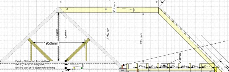

Oldun - Thanks! The RSJ is directly beneath the 'fly-in' where the new extension meets the house.
Gary
The RSJ is in the heart of this cross section, currently labelled 'doubled up joists'
This plan view shows the existing house rafters, and new extension at joist level with lay boards to support fly-in.
Plan at rafter level
If that beam is the red bit in the second image, then it seems like the beam is not doing much because those existing rafters are redundant.

I am open to correction, but I always thought that there was minimal loading on hip rafters in normal situations - which is why they have never been in any span tables.
I can't see why there is a need for that beam. Nor can I see why the engineer did not design a working solution.
However, the engineer should have designed a beam to take any loads, so if that is his design then it should work, shouldn't it?
The RSJ is only 79mm x 127mm x 13, so it's a tidler, and that probably reflects the small loadings involved.
The SE specified the beam to take the load and told me that it doesn't matter if the after tails sit on the top flange or bottom flange, but I'm getting hung up on the detail of how to actually do this. My intuition tells me it's not stable.
I'll go back to the SE for clarification.

Gary, Questions, and every one has a purpose..
1. Is first floor proposed level and existing first floor level the same, or is there a step.
2. Height of top of existing wall plate above floor level
3. Ditto new extension.
4. Confirm existing house has a raised tie ceiling.
6. If so height of existing ceiling joists above plate and method of securing joists to rafters.
7. Size of existing rafters and ceiling joists
8. Will joists of new extension sit on plate or be raised tie.
9. From memory existing house was 50mm cavity and new extension 85mm thereby changing HAP where roofs join. Is this correct
10.Note that internal width of new extension is 4044 and would appear that knock through is same width. If so what end bearings have you allowed for on USB and what size is USB.
Quick observations. Until we receive your answers, would appear that USB will be above HAP of rafters at both ends and will need to be chamfered down and a new 7.8mm flange welded to web. We are not SE, but we note that you say your SE has proved the beam loading, but we ask the question has he proved the loading, rotation and deflection in the way that you intend to use it???
Looking at the existing house from back garden, you can use a lay board on the right hand side where valley gutter runs up, but not on the left hand side where roofs join into one and other. on the (hopefully) same plane.. You will not get a straight run from ridge to HAP with a layboard underneath jacks. Think about it, draw a small sketch and you will see what we mean. Two ways of getting round this situation.. 1. Treat existing hip rafter as valley rafter and run valley jacks up to ridge in as near a straight line as possible to existing hip jacks. At times we have laminated in between existing hip jacks 100mm onto hip rafter to make this possible. 2. If existing rafters deep enough, drop layboard down onto noggins between existing hip jacks and then fly jacks from this to ridge. .

If the beam is adequate for the loads, then I'd go with prop 2, but with another timber bolted through the web on the back (like a flitched beam), and then with some timber braces across the top of the beam at 90° - and fixed to the existing rafters (every third rafter)and across a few of the new ceiling joists
This should deal with any possible rotation
Hi Oldun - thanks for the long reply!
1. Yes, new floor level matches existing floor level.
2. Top of existing wall plate is 2590 above floor level.
3. Top of proposed wall plate is 2550 (40mm difference allow for extra depth from 195mm rafters after birdsmouthing etc)
4. Yes, existing ceiling joists are raised tie.
6. Top of existing wall plate is 154mm below existing joists/ties. Ties are nailed into rafters by two nails.
7. Existing rafters are 100mm x 50mm @400c. Existing joists 100mm x 50mm @ 400c
8. New extension joists will sit on wall plate.
9. Yes, this is correct. CONFIRMED - This is a 20mm difference. I need to revise my 40mm planned difference in wall plate heights in point 3 above as previously I expected this difference to be 35mm.
10. End bearing on the perpendicular wall is 100mm. On the corner wall it is 150mm.

1. Sorry for delay.
2. According to your figures, storey heights are high, even for 50s build.
3. With that in mind would be tempted to fit your sardine can (steel) underneath the plate.
4. Reasons. Stronger and easier. Will save cutting beam. Solves problem of possible rotation and deflection Will still leave you with 2380 headroom which is approx modern day storey height..
5. If you do not like thought of dropped beam at this point then disguise it with either semi circle or elliptical pre formed arch turners at each end with bridging piece and make a feature of the beam.
6. If you still wish to stick beam up into void, then go along with the suggestion of woody. Proposal 2, but strut against any possible rotation in the ceiling joists of new extension
