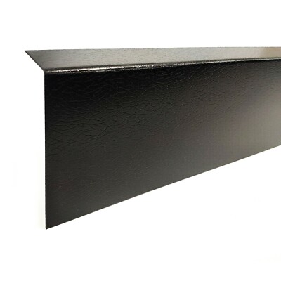

I am using a rubber roof for a lean to shed, going against the house wall. I’m wondering how I should finish the ends.
I’ve come across this:
I will have the roof over hanging on the side by 50mm. Is this extra patch necessary or can I fold the rubber in a way that this is watertight?
I will also be using a metal flashing.
Thanks in advance.

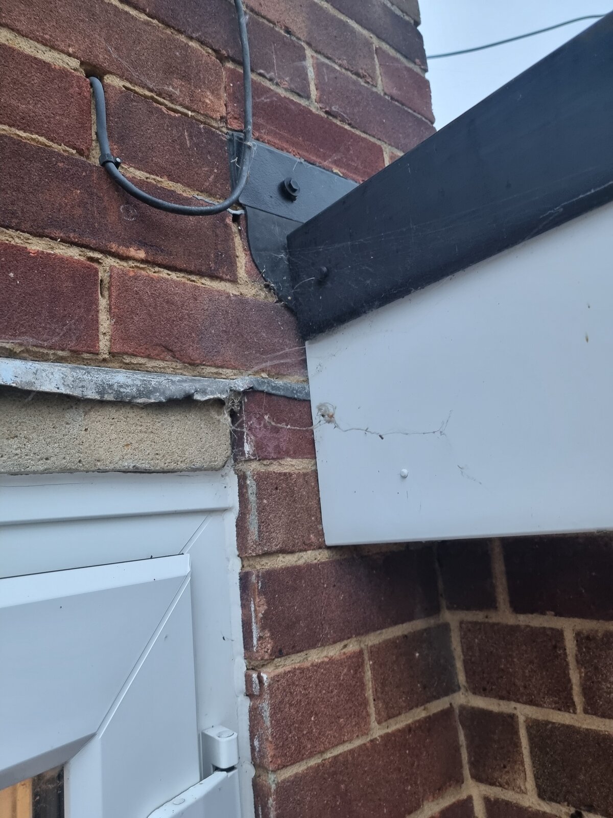

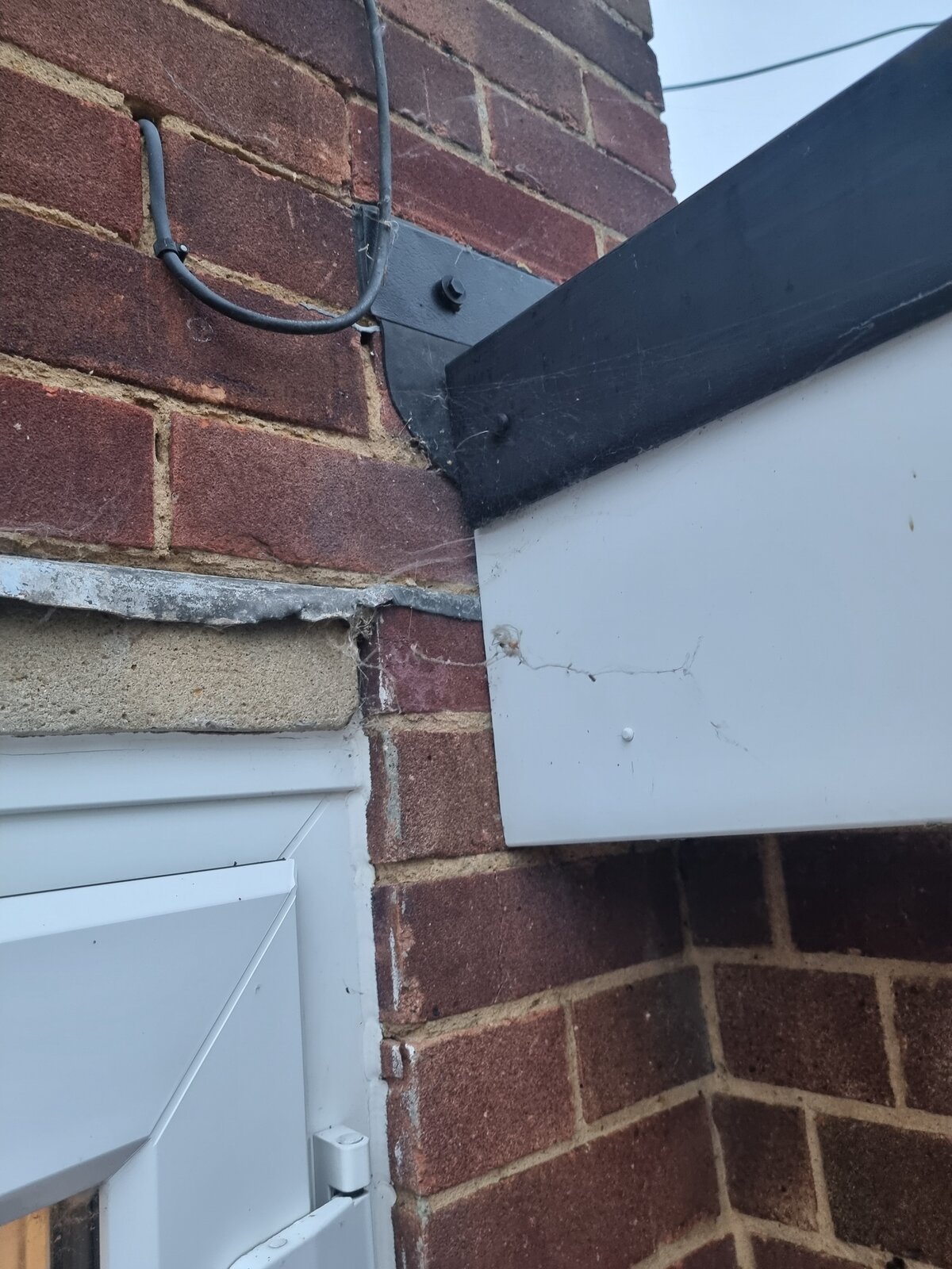

Also, how do I handle the rubber roof folds? In the video, the chap is using some extra tape for these. Is there a way to dispense of this and fold the rubber roof to get the watertight fit in these corners?
Have you got a picture of the area you are talking about? The wall flashing trim is fine
The horizontal line is where the roof is going and the vertical line is the side of this shed.
I want to understand how I fold the rubber roof at the ends.
You can't fold the ends. You have to cut the rubber and use the flexi flashing in the video.

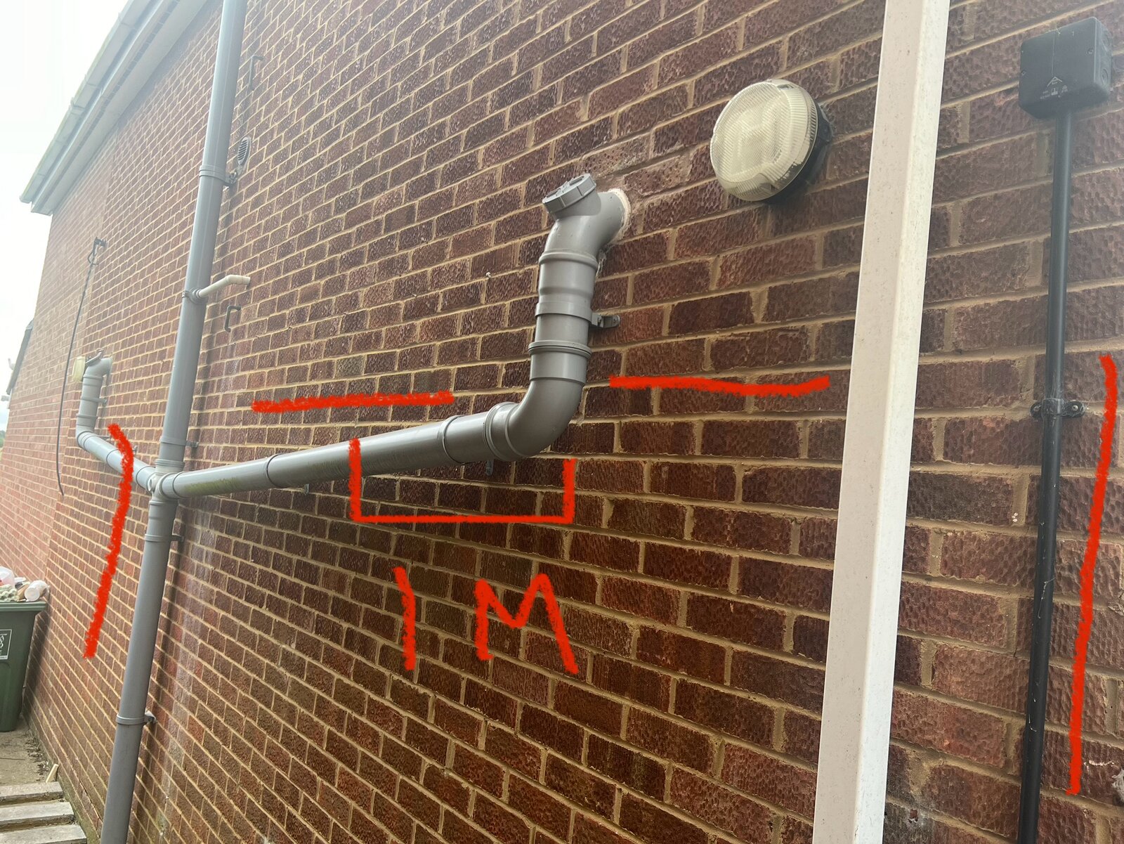

Below is my roof. I would be more concerned with all the drain pipes. The more detail you have the more complicated is rubber. Have you looked at fiberglass?
That image is very helpful.
Can I buy those bits of tape in the right size and shape or do they have to be cut to size?
I’ve purchased some retrofit rubber boots for the vertical pipes. Some of them will be enclosed within the lean to shed.
You could have rejigged that soil pipe arrangement so most of it was all above your shed.
Yes, probably but decided against it. Probably created more work by doing it this way!
I can do the shed project over a number of weeks as I only have the evenings to work on this and it would have been stressful to take out the bathrooms by moving the soil pipes around.
