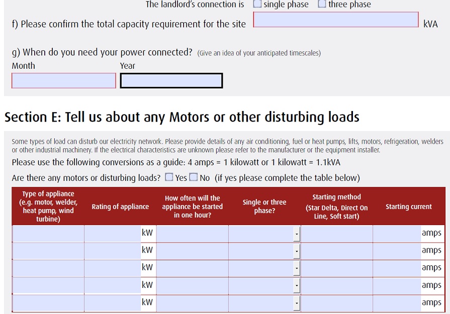

You or your land lord will need to contact the DNO ( details HERE ).
The contract to supply invariable requires that the DNO is informed of any disturbng loads that are to be connected to an existing supply
This is a typical application for supply form.

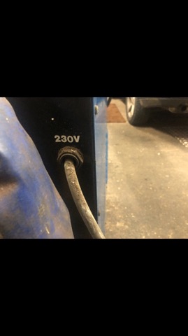

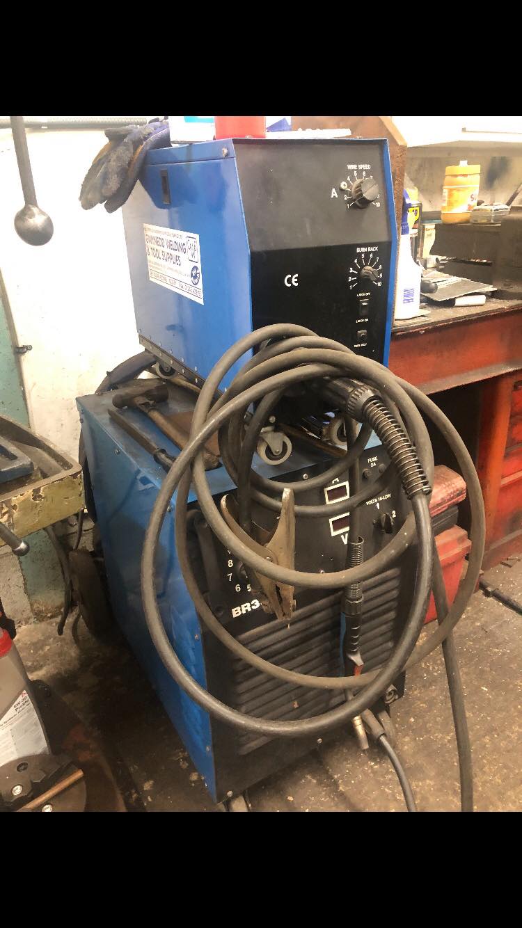

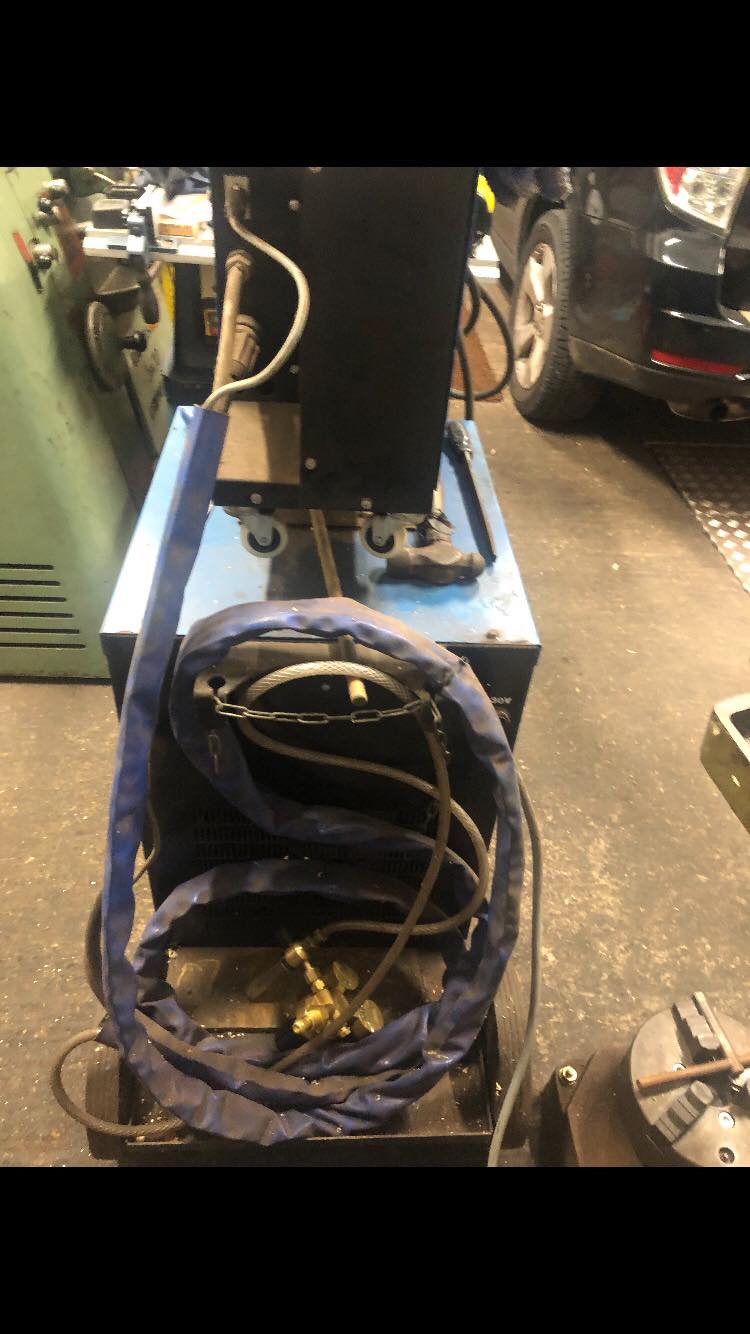

i know nothing regards the above calculations but the welder is deffo a 300 amp 230v single phase if that makes a difference
