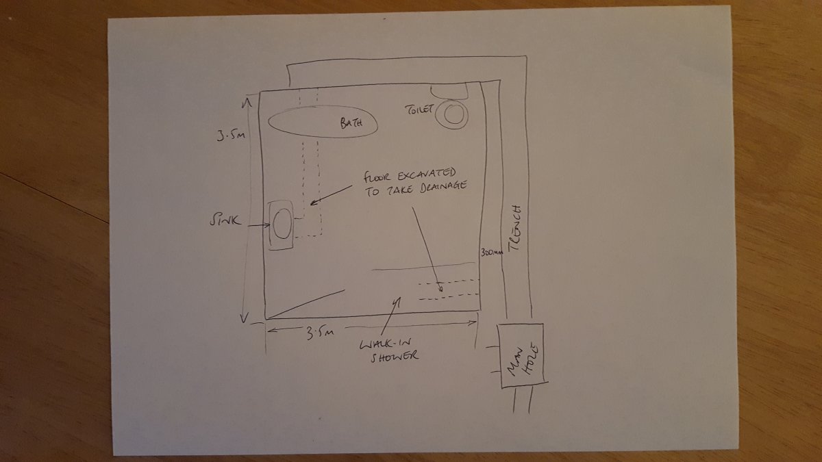

Hi All.
I'm installing a new bathroom into my bungalow, and am looking to run the bath, sink and shower waste out under floor level. I have a soil pipe extremely close by, and wondered if I would be able to connect straight into it? Failing that, given that the wastes will be below floor level, how would I get into the main drain?
Any help greatly appreciated.

Thanks for the replies guys (and the welcome note).
The floor is a concrete one. I've cut through the concrete, and dug a channel for each of the wastes. There is plenty of fall between the actual outlets (in the bathroom) and the soil pipe (outside the property); my question is how to tap into the soil pipe itself. Can I (satisfying building regs) go straight into it (underground, outside the property), or do I have to create a 'drain', then run from the drain into a man-hole / inspection pit? So, regardless of levels (which, incidentally, are 'good'), can I go directly into the soil?
I hope that clarifies what I need to do?!
Thanks again,
John.

Could you scan and post a rough sketch of your proposition - showing layout and soil pipe and manhole?

Are the wastes below ground level where they exit the building? If they are, then connect directly into a 110mm pipe, as close as possible to where they exit the building. If above ground, then options are, connect to existing stack, (as its a bungalow I'll assume there are no discharges from upper floors, so 450mm rule doesn't apply), take into a gulley or connect to a stub stack. Both stub stack and gulley will need direct connection to the drain.
Hi All.
Hugh - that's exactly what I wanted to hear, thanks. Actually, two of the three outlets (sink and shower) are below ground level, the bath will be just above ground, as it's a free-standing bath, so will just come out on a shallow P-trap, straight through the wall. I'll be running a new section of 110mm round to the toilet, so I was thinking I would just extend it by a few feet, and pick up the sink outlet when it comes through the wall.
How does that sound??
Thanks again for all your time!
John.
If that trench is external, you'll need a manhole on the corner where the pipe turns 90°, if pipework isn't deep then a shallow access chamber will suffice.
Thanks Hugh, that's great. The pipework isn't deep at all, about 300mm to centre of pipework - so I'll fit a shallow access chamber as you suggest.
Thanks again, john.
