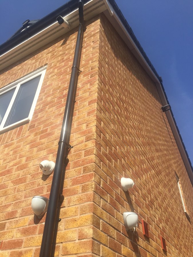

On my own new build house, I took off the rainwater down pipes and ran black 20mm conduit behind. With the pipe back in place, it pretty much totally conceals the conduit. You can sort of see what I mean in the photo.

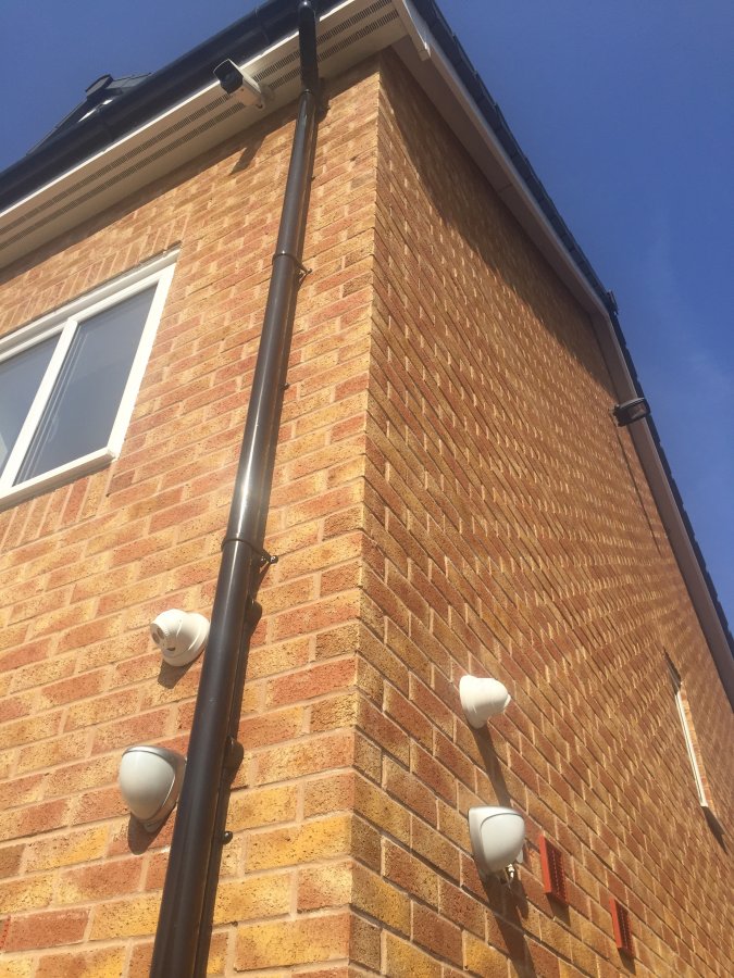

Thanks everyone for your posts.
Wow, now that is clever! I can just make it out behind the gutter.
How about the camera on the right hand side? Where is cable going for that one?
I drilled through from the conduit at a steep angle into the wall cavity, then from the camera position I drilled a 25mm hole to meet up with the first hole (roughly). A bit of scrap cable poked into the cavity and a bit of hooking about from the 25mm hole and there you go :) You'd need a decent SDS drill and it will depend on how the cavity is insulated (ours is insulated with those polystyrene beads, Kingspan or foam might cause a problem!)
