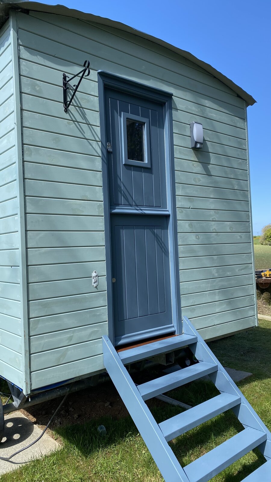

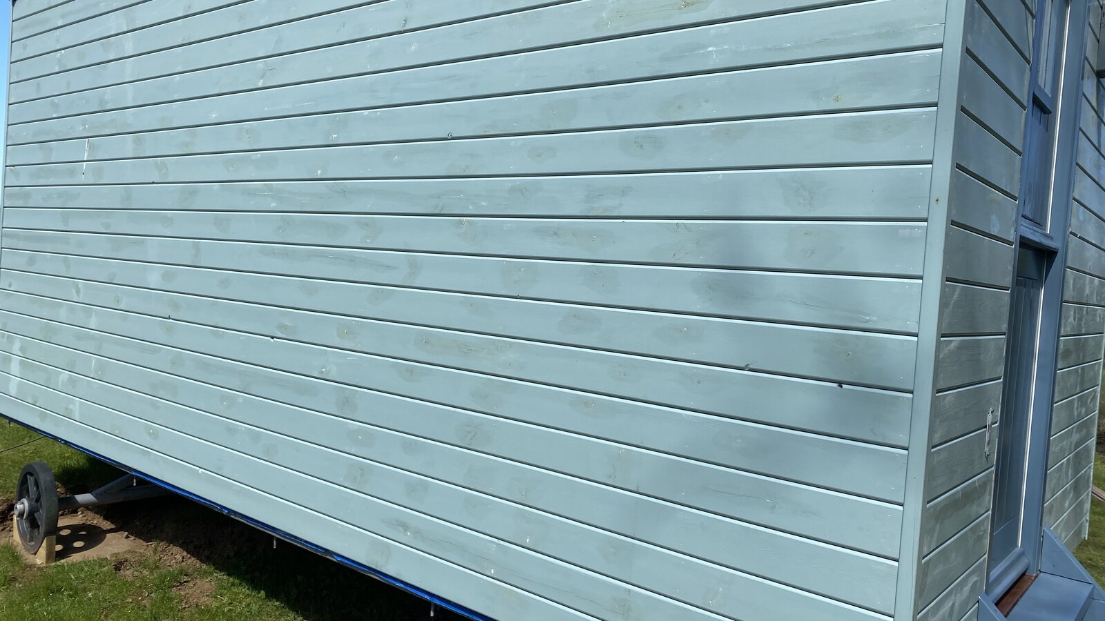

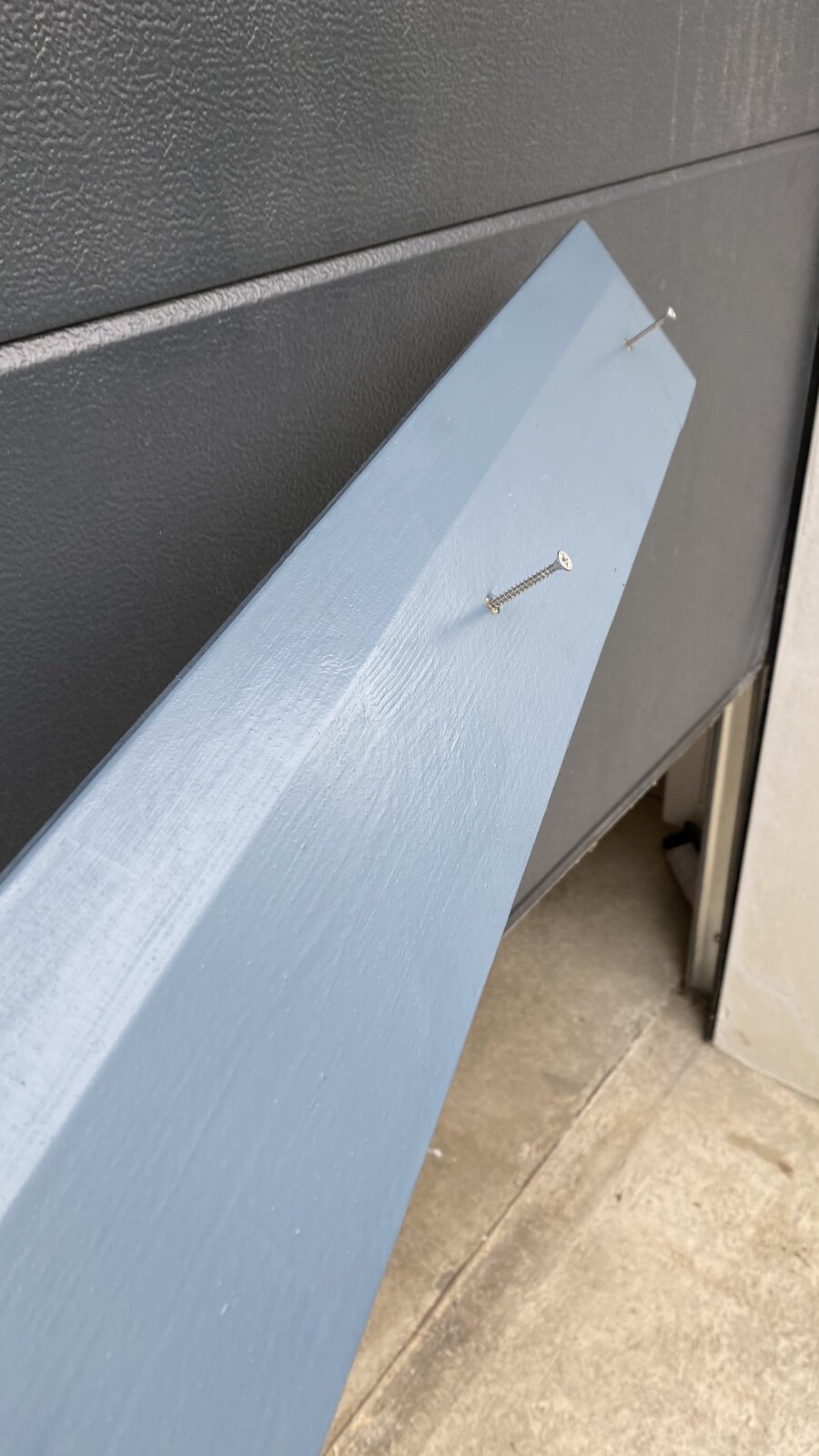

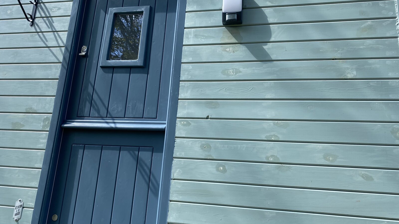

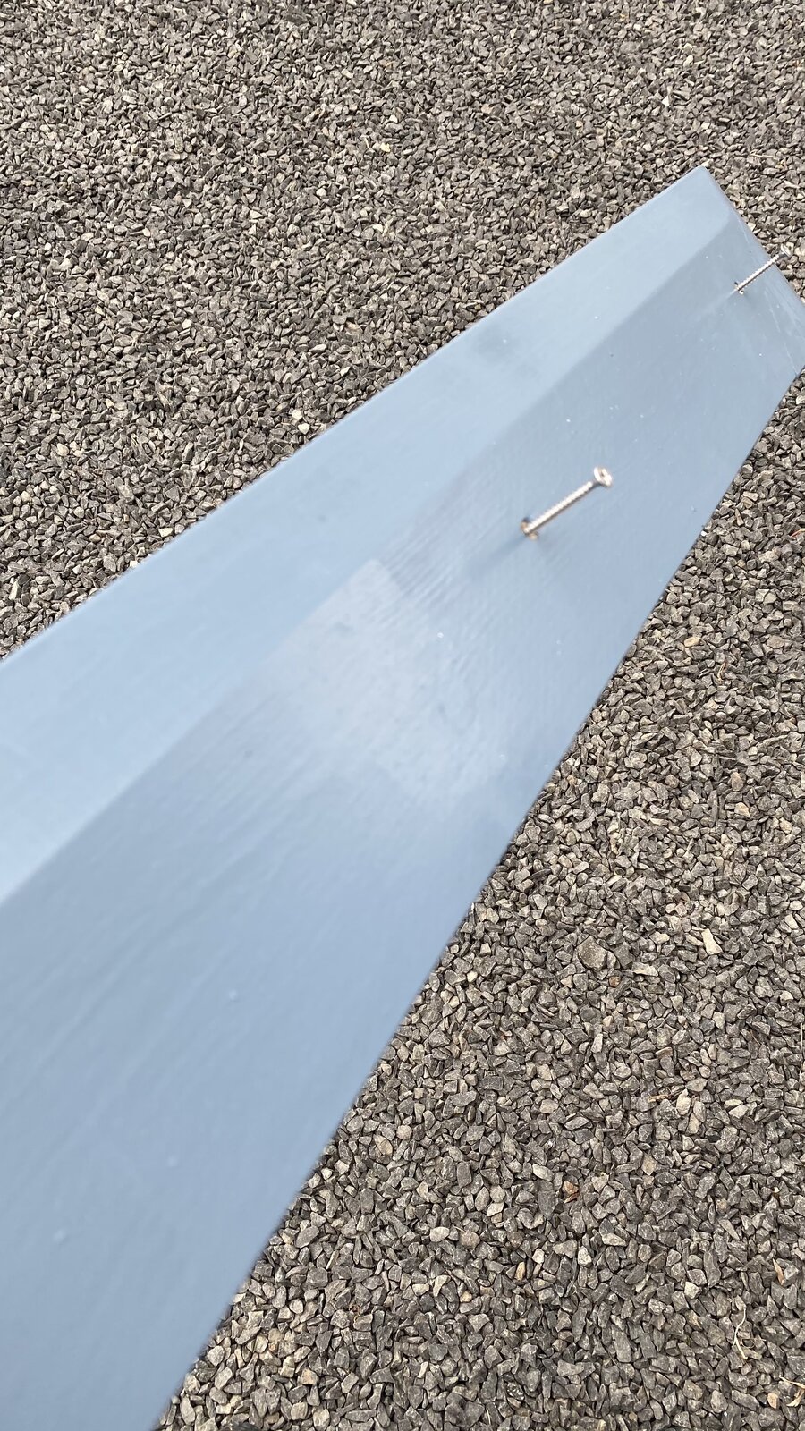

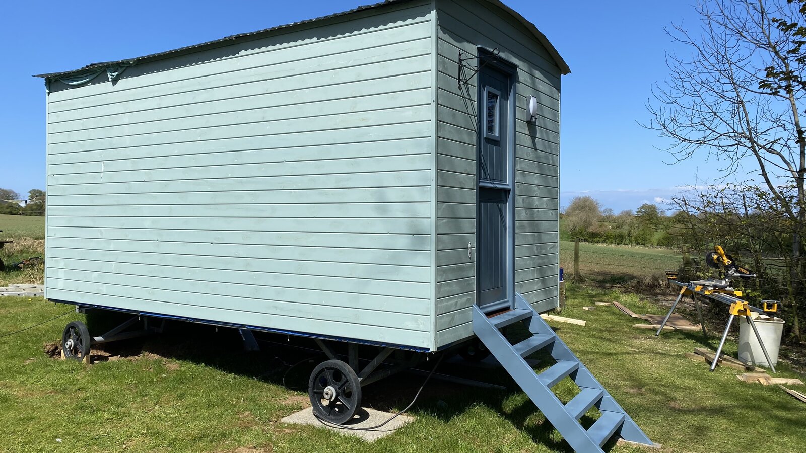

Hi guys, I've got an issue where I have treated every knot on a shepherds hut that I'm about to repaint (same colour) and am 100% sure that it will flash through as also treated some internal wood with the same solution and covered with a darker paint.
Is there a product that I could go over the Rustins Knotting with prior to repainting?
The paint that I've been using is Dulux Ultimate Opaque Paint (@ £100 per tin!), that is solvent based and supposably suitable.
Any thoughts or suggestions would be helpful.
Many thanks.

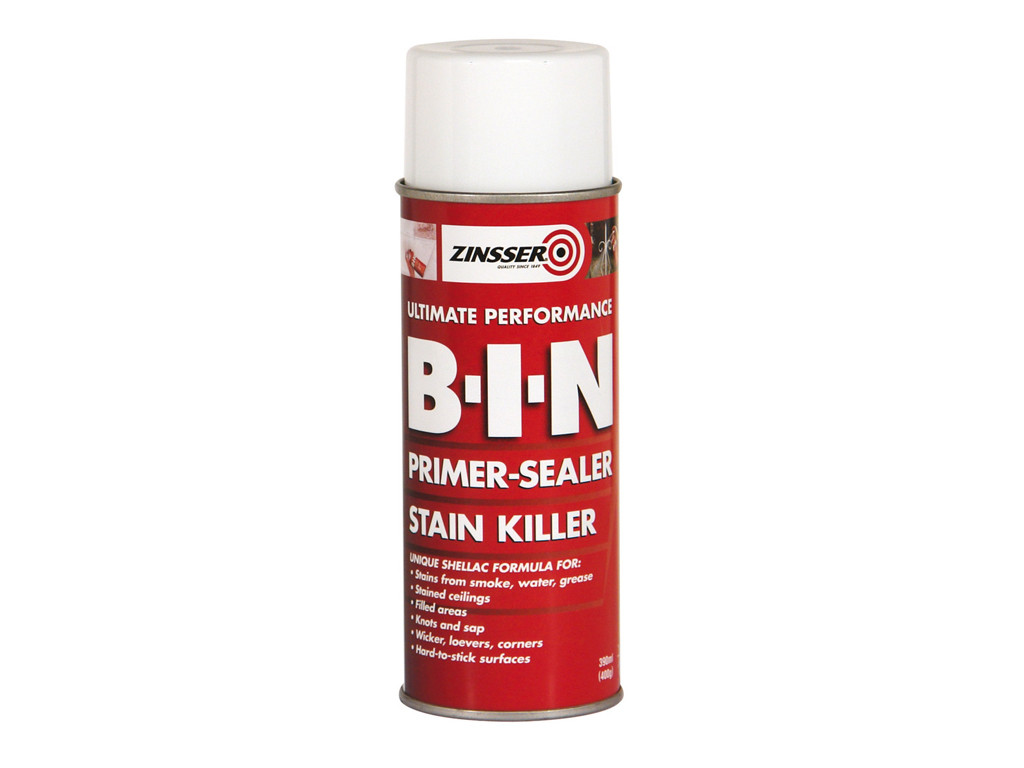

No idea about compatibility for outdoors: I used zinnser bin matt white shellac spray on knots before painting untreated wood / fire surround / architraves.
Worked perfectly, no bleed through.
Maybe?

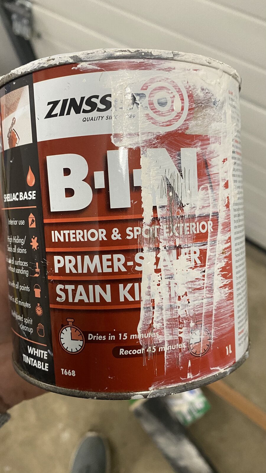

Thanks guys is this the same product, spot outdoors? If so I have used it before on some painted brickwork outdoors and it melted through when painted over.
Just wanted to check as I'm a little reluctant to use again and have the same issue. Thanks.

I used this - the shellac spray.
No experience with the tinned stuff. Not sure if its the same or not.
Didn't melt when I applied gloss (both oil and water based, on different things). Really resinous pine knots didn't bleed or flash.
