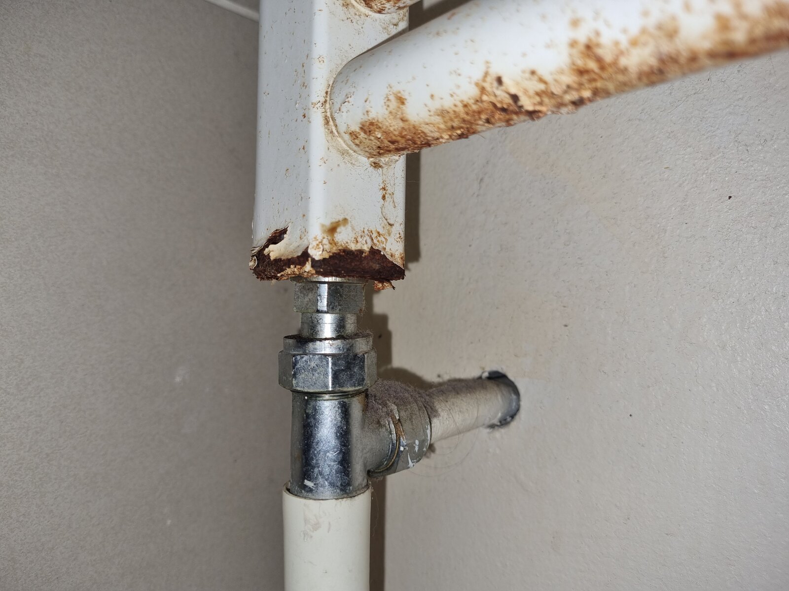

Bathroom fitted over 12 years ago,should I be concerned about this leaking soon please? Assume it needs drain down of 1st floor to swap the towel rad out?
Thanks!

The main part of the radiator appears to have just surface rust, but the bit where the valve tail screws in does look quite serious. I would be concerned about this leaking - it'll probably only be a weep at first, but I would get the towel rad changed reasonably soon.
If you want to avoid having to alter the pipework you'll need to look for a replacement with exactly the same dimensions, which may take a while to find
Thank you Chris, how much of a drain down would be required, I'm worried about the amount of labour involved
