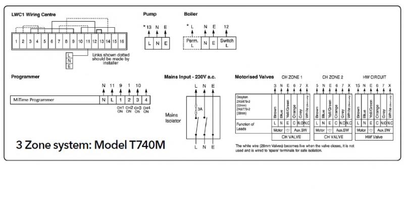

S plan fully pumped boiler switch off every 2-3 minutes
Still in Limbo!! I replaced the programmer today from Drayton 740m to Heatmiser tm4-ts....still no luck...boiler shuts off every 1 or 2 mins....Can I replace the pump? or 2 port valves? Any advise will be appreciated

I thought it might be faulty programmer and this programmer is cheap and I had this as spare and thought will give it a go!! it does the same work as T740m any way...
Guys we update!! after Air bleeding the pump, zone 2 with 28mm 2 port valve zone started working with no issues boiler was on for 1hr.30mins without switching off.....however boiler is still switching off for zone 1 and 2 which runs off 22mm port valve any advice please

Hello all thanks very much for help specially Mogget. I managed to source out the root cause....it turned out that ABV is faulty. I.e. it was not closed properly and water was pumped back to boiler before it reach to radiators!! I have ordered Mayson this time Honeywell has been returned. I have fitted 15mm old gate valve and balanced system as required...all the zones are working without boiler switching off!!! I am also returning Drayton Mitime programmer and settling to Heatmiser 4 channel programmer with wired cylinder stat and room stat!!
