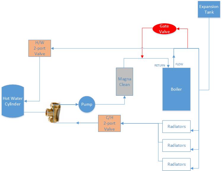

i am hoping someone can help me. I am an enthusiastic DIYer trying to establish if my boiler configuration is correct, having had it professionally installed back in 2013. Specifically, I am concerned at the:
- placement of the pump on the boiler return
- placement of the heating 2port motorised valve on the return from the radiators
- use of a gate valve instead of an automatic bypass valve
- placement of the bypass gate valve in relation to the other components
I have created and uploaded a diagram describing the key components.
Note that all the radiators are fitted with TRVs, and the boiler is a Vaillant ecoTEC plus 428.
Any help much appreciated.
From your diagram, the only issue from what I can see if your pumps on the return so if you had a leak, it could suck air in instead of leaking water out. You have a combined cold feed and expansion so won't have issues with pumping over.
BG fit this design of system quite a lot with Baxi Precisions.
A lot of people prefer a manual bypass rather than an automatic.
Dan
Arrows point the wrong way regarding flow for by-pass.
The system layout will cause nothing but trouble.
Gate valves are not allowed any more, has to be an automatic bypass, very poor design/install

So how does the bypass work?
Potty precision doesn't require a pump over run. i didn't clock the position of it. If they moved the pump closer to he boiler (after he bypass) then it'd work.
It's wrong either way.

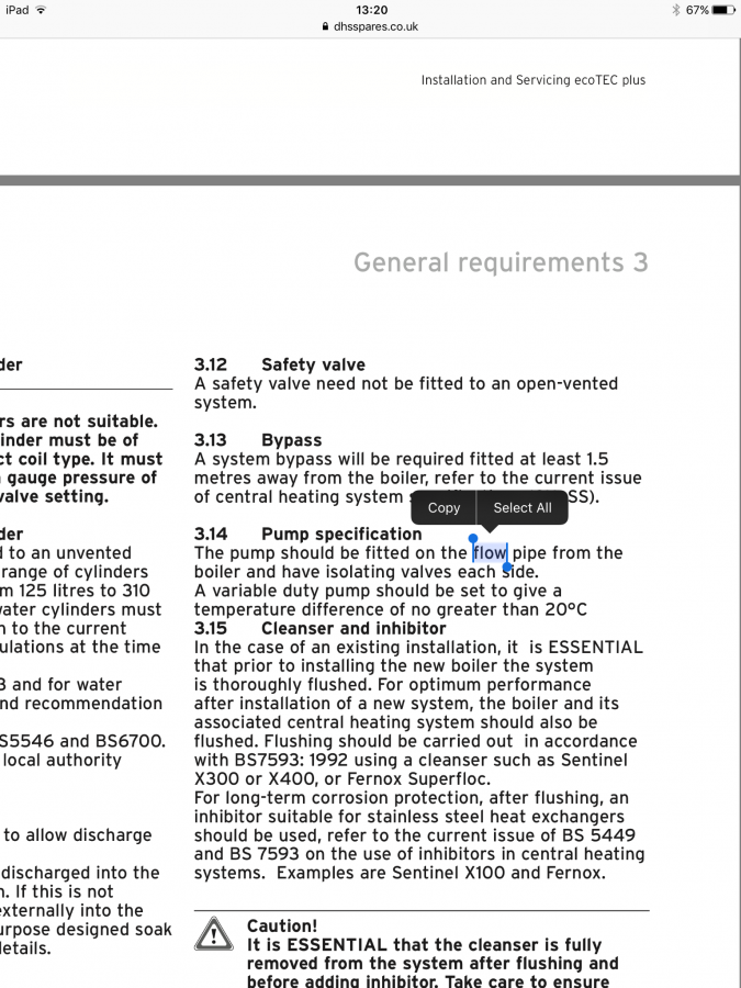

Thankyou all. Two things are clear:
1) The pump should be placed on the boiler flow, not the return
2) An automatic bypass valve should have been fitted, instead of a gate valve
