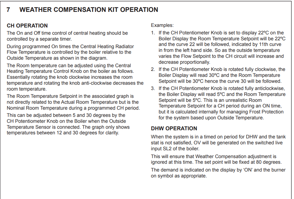

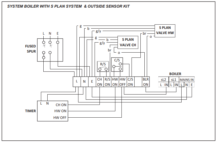

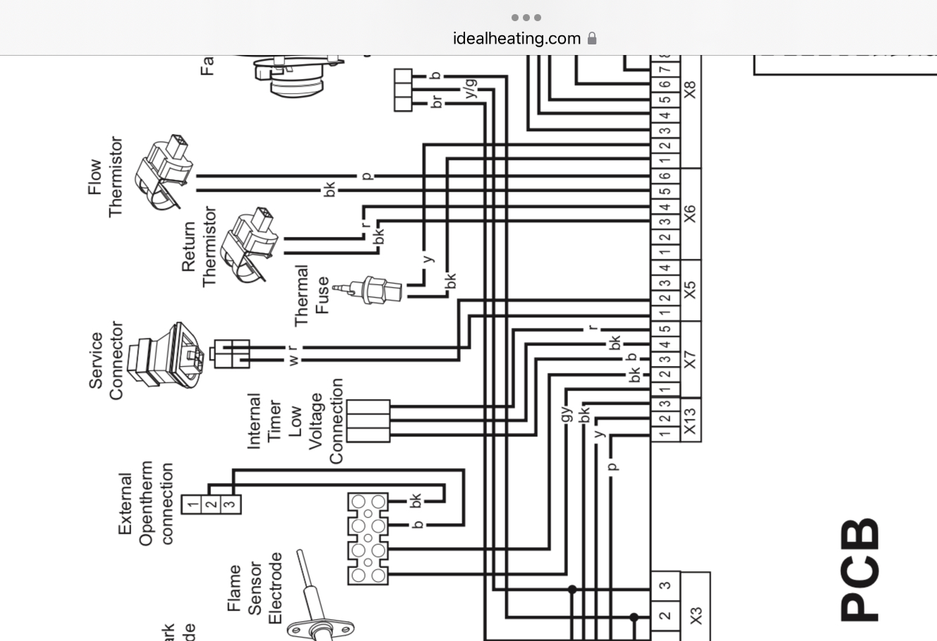

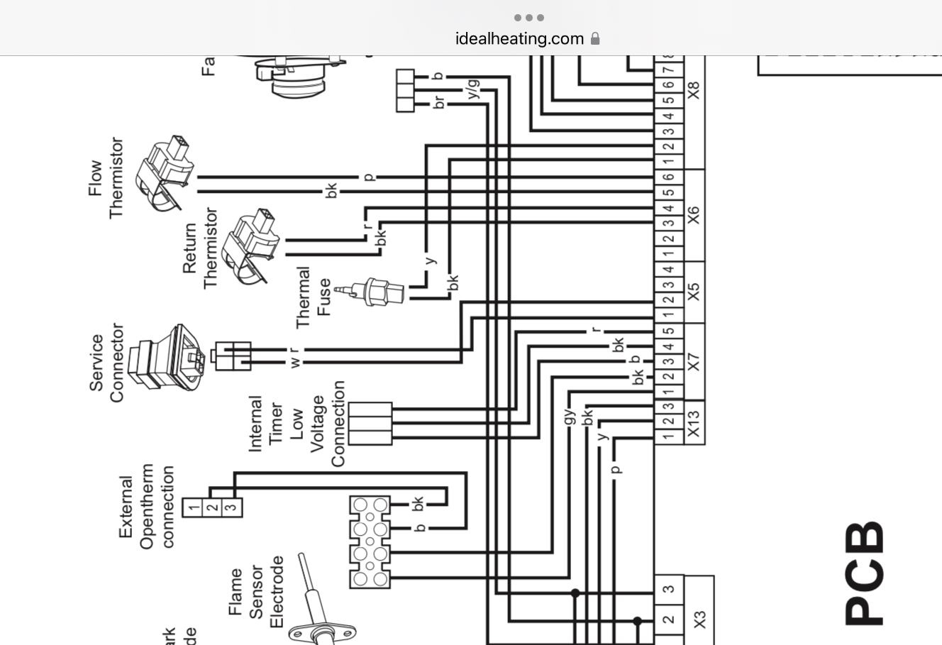

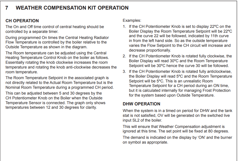

Here are some screenshots, and it appears your boiler has opentherm connections and weather compensation. It should be a case of wiring the Tado near to the wiring center and use the existing thermostat wiring for the opentherm connections on the Tado.

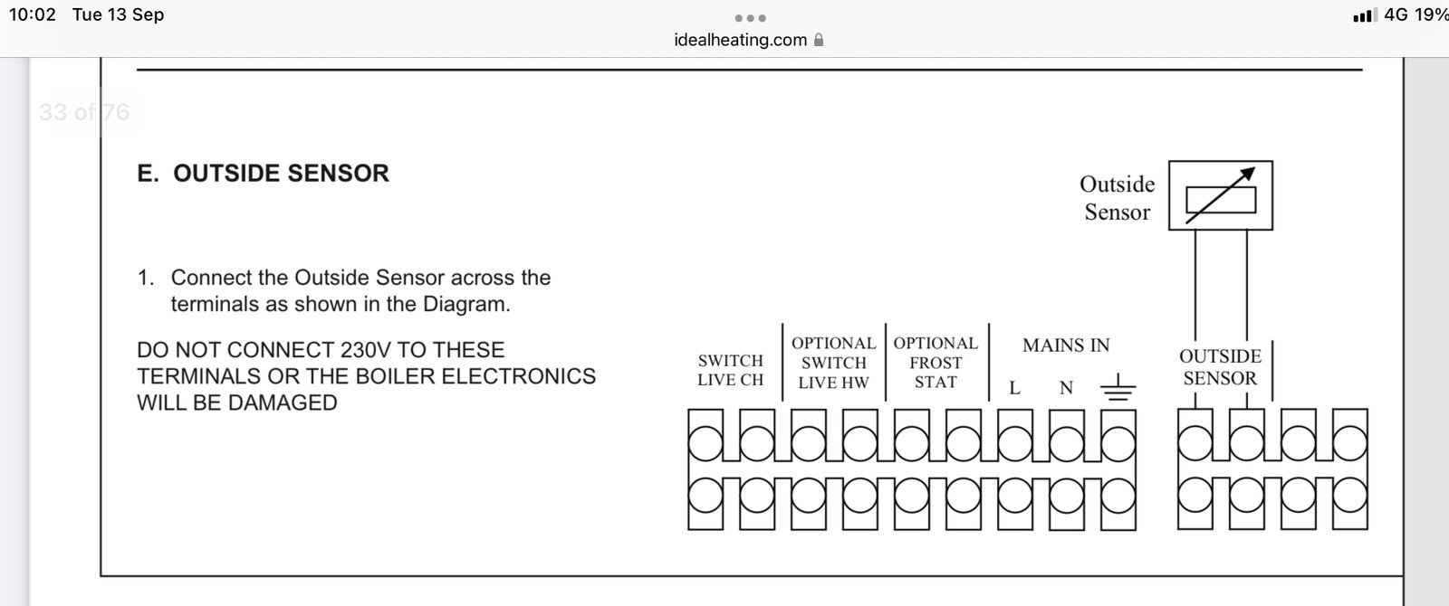

The Tado wireless smart thermostat does have a build in wheather comp using the internet and won't require a sensor. In that respect, how would the wheather comp wiring go?

My understanding is once PDHW is in place then the OT will be a simple connection of the + - on the OT connectors.

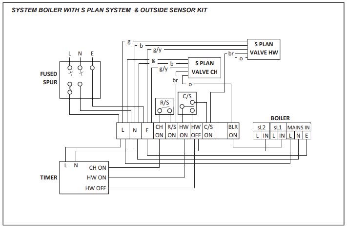

You wont get OT with an S plan system, the receivers open and close the zone valves and the valve scontrol the boiler , so no OT Im afraid
Not necessarily Ian, it is doable with EPH controls, receivers open and close the valves, OT controls boiler firing and temperature. Tado might be similar but I've never used Tado.
It is frustrating … nobody has a concrete answer if TADO EU model supports the ability to work on Opentherm and PDHW.
S plan will be converted to X Plan as the CH zone valve will then be NormallyOpen.
The only issue is how the wiring go …
The vogue smax does support opentherm when used in an adjusted s plan system. As it has 2 switch live inputs. Adjust the S PLAN piping to a PDHW Priority hot water design, with a norm open zone valve on htg. Then have an opentherm stat or wifi base receiver wired to send a switch live to s2 and also the low voltage opentherm connections made. and a usually seperate switch controller to the S1 connection . Nest does this all in 1 unit but nest don't have Smart trvs. for those who want them Tado (eu version) combi set £199 in conjuction with its seperate wired in wall stat £100 ish ,wired and programmed only as an on off water timer . Drayton can do this using there combi stat and base receiver £100 ish and there 16amp max relay unit wified to a 2nd wall thermostat £170 ish programmed to just do on and off times.this will allow these 2 brands to have in App control of HW and HTG and the wall stats can be given a name in the apps as hot water controllers. temp settings will have to be set at max and minimum.for both brands to avoid the temp reading function having an effect ie set off times to min -5 and on time to max +30 .for tado and drayton this is a work around as they Do not provide a 2 channel controller with opentherm at this time. So in affect the 2nd wall stats from each manufacturer are used as remote Hot water cylinder on off switches controllable in App. The cylinders own mounted thermostat sets hot water temp. And you can also have the these brands smart trvs on radiators. If your NOT bothered about HW in App controller then any WiFi or manual controlled switch/programmer in theory can be used to turn HW on when required.
