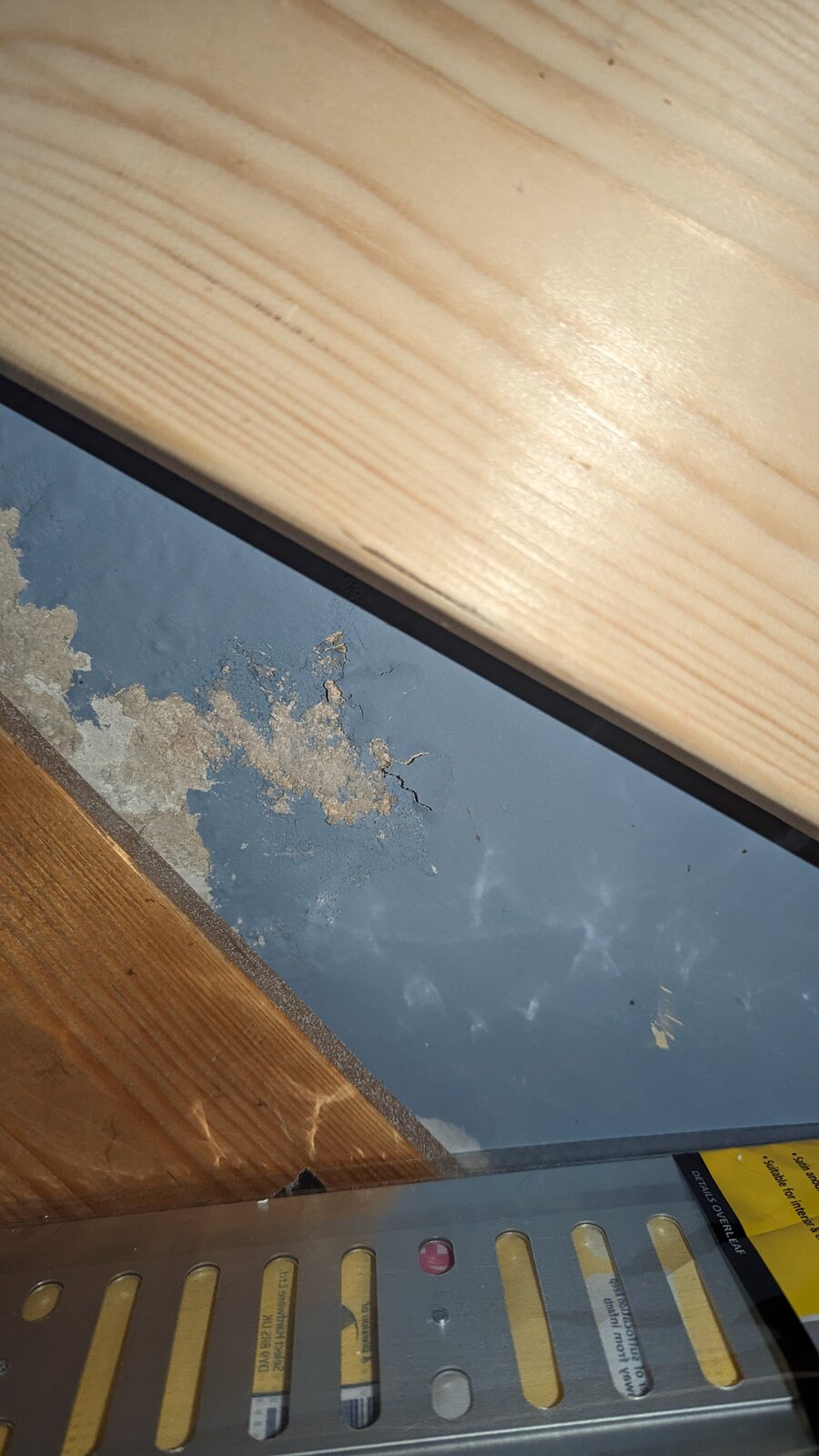

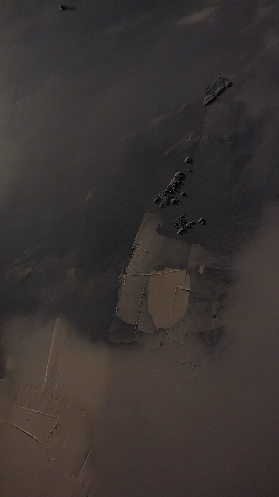

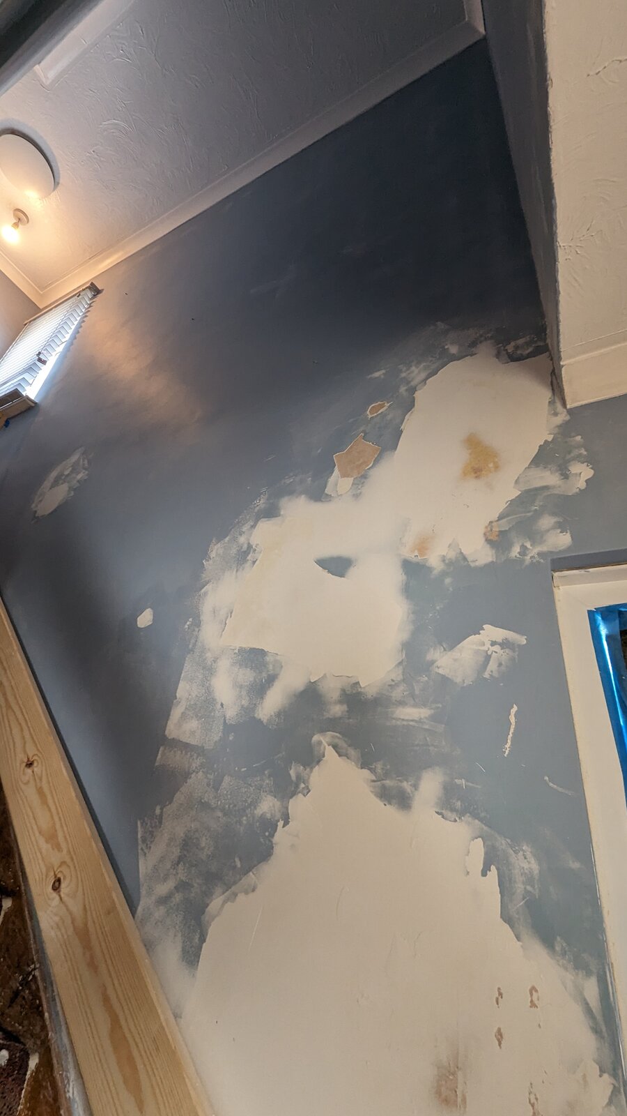

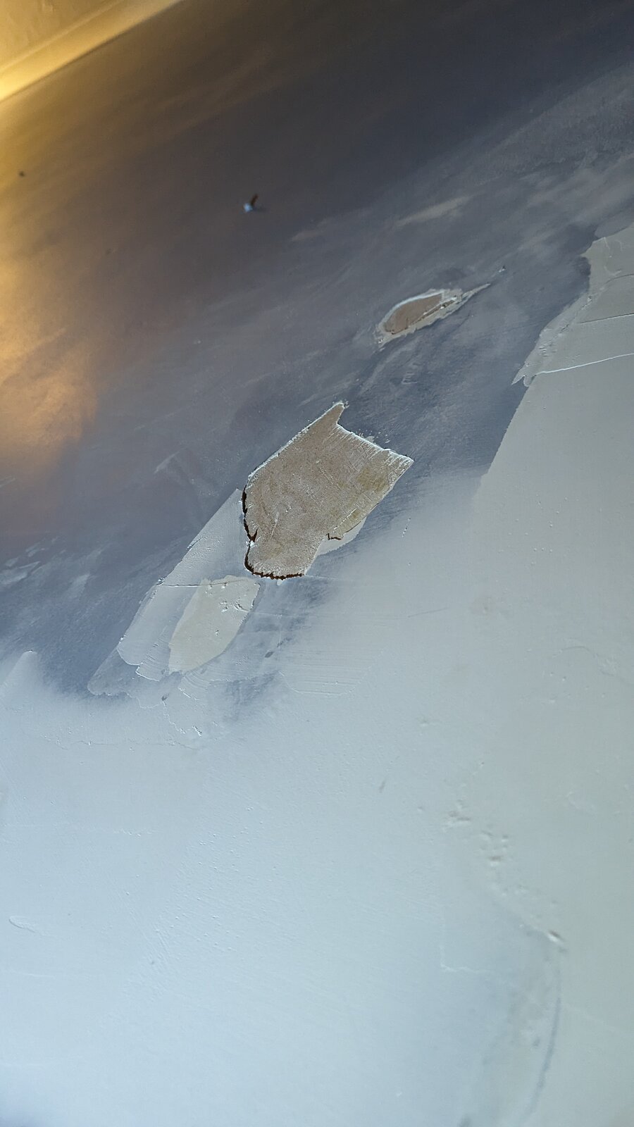

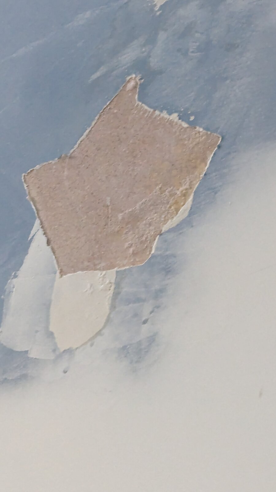

Before we started decorating the stairs we saw nothing wrong with the walls just that there weren't as smooth as could be. We then were advised to use skim on top to save taking all the paint off to set a smooth as possible with no skills. Once paint was applied we started getting the salt coming through. Went back to plaster and SBR it, reskim, whitewash then paint. Still the salts were coming through and going higher.
From what I have read that some are for salt neutraliser some are not.
It's a cavity wall. We have looked on outside there is wood/gate on the other side. House could do with a paint.
I have noticed that the salts seem to be travelling up a little.
I haven't touched this wall since January.
Would it be worth getting a day specialist out?
Checking the damp levels myself?
Any other things I can try myself?
Any advice?
Cheers
23/3
5/4
14/4
Paint smart times as rest of the wall currently has a couple.of long bits of wood stored along sideup the stairs. Never like this before we removed paint and painted

What the pics show is damp damage.
Moisture might be crossing the cavity if there are blockages or damp CWI bridging the cavity.
Is the outside rendered?
There's also the possibility of moisture coming down from the roof area? Have a look in the loft for signs of leaks.
Have you examined further down or other areas of the wall for similar blistering?

The area height from 18in to 8ft high from floor. The area above this so far looks free.
Outside has been rendered.
When looked before whilst raining and not raining no signs.

In your photos, always include something to show scale. A ruler will do.
Please show photos of the entire wall, top to bottom. Include any plumbing. On the outside, include the roof, gutters and downpipes.
Is there a bathroom above this water damage?

I'll show photos later. No bathroom above. A bedroom cupboard overhangs the stairs and then it's straight the ceiling.
Probably not best image I can get but I'm not currently home

You have penetrating damp of some description. No amount of stain blocker is going to solve your problem.
You need to find out how the moisture is getting it and address the route cause.
''Outside has been rendered'' - It would be worth checking the integrity of the render.
