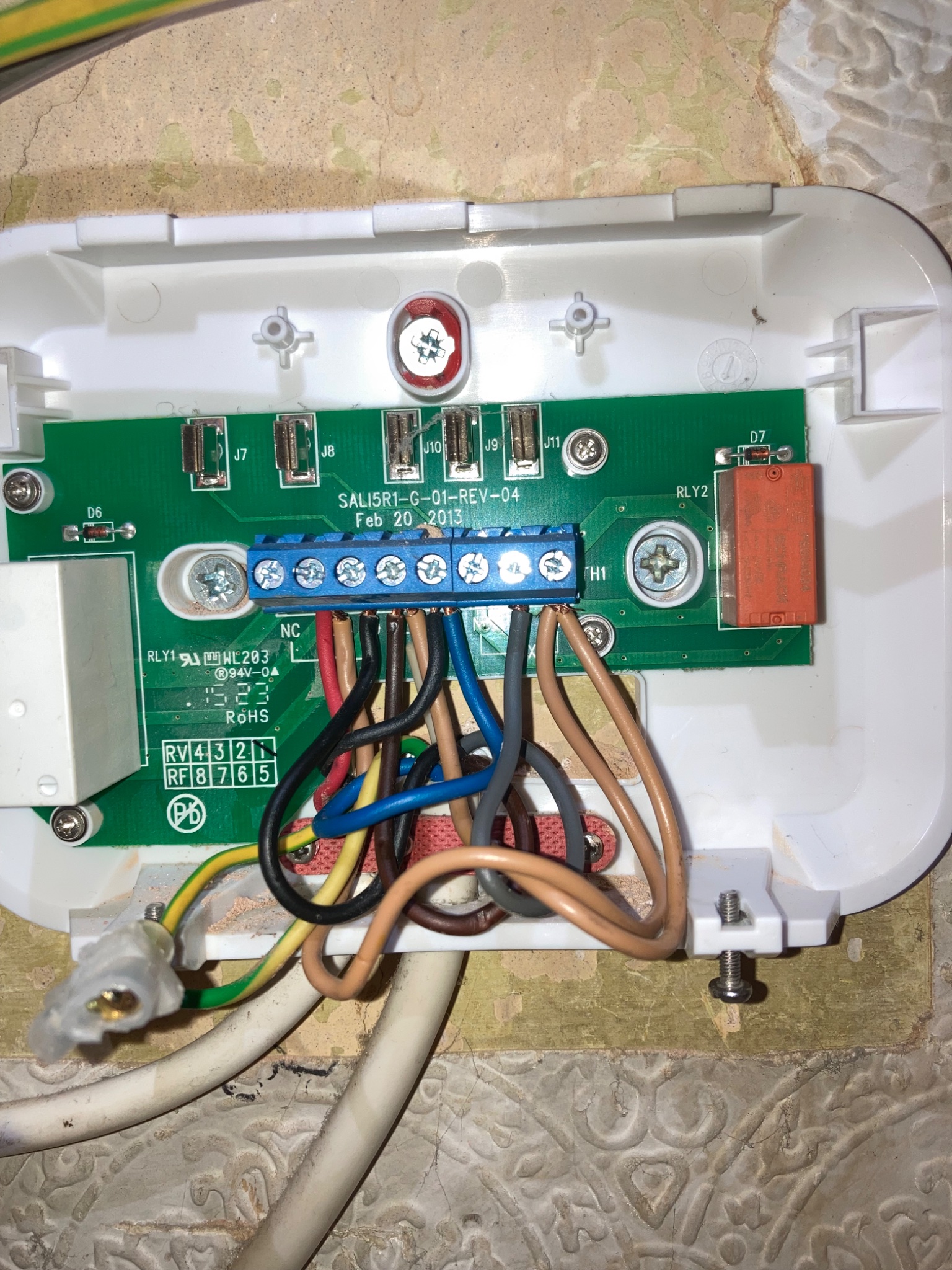

If stem is viewing post Hi,you recently gave advice regarding a dead Salus iT500 receiver to JWz12 in which you advised to join Aux No and Aux Com wires to get hot water until a permanent fix was able to be done.Is there the same sort of fix to get heating only on temporary,as I have an immersion heater,until I can a permanent fix.Typically it’s bank holiday
Should be similar joining wires. Can you post a photo of what you have?
Hi,hope this helps.

Hi,hope this helps.
It appears the Aux is on the right, so you want the left side No and com joining together, which appear to be the red and brown to join the single black. (Not the black and blue which appear to be neutral). Should be printed to confirm which is which terminal
I’ll give that a go,thanks for taking your time to help out,much appreciated.
It’s seems to be heating up the rads so thanks,I presume it won’t be communicating with the thermostat so do you see any problems that I should be aware of,as in how long I leave it on.
No, just be mindful it won't regulate temperature
