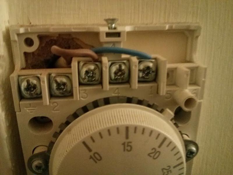

You have not mentioned the boiler model.
But is it an older one with 230v switched live input and you have a wall stat with a live, neutral and switched live wires back to the boiler?
In that case you can power the RX unit from the live and neutral and use it to send the switched live to the boiler.
Thus not needing any further supply connections to the RX unit.
Tony Glazier
its a Biasi Riva Compact (i think)
Its just a switched pair at the thermostat, no 230v.
Cheers

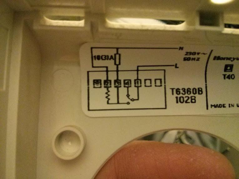

Are you quite sure there is no neutral at the stat?
Most older stats required a neutral connection to operate a heat anticipator.
One side of the Biasi connections is actually a live.
Tony
got a feeling it was bodged in a bit to be honest, it was in when we moved there.
I can see where there should have been a neutral as you say.
One of these definitely live then? What voltage?
