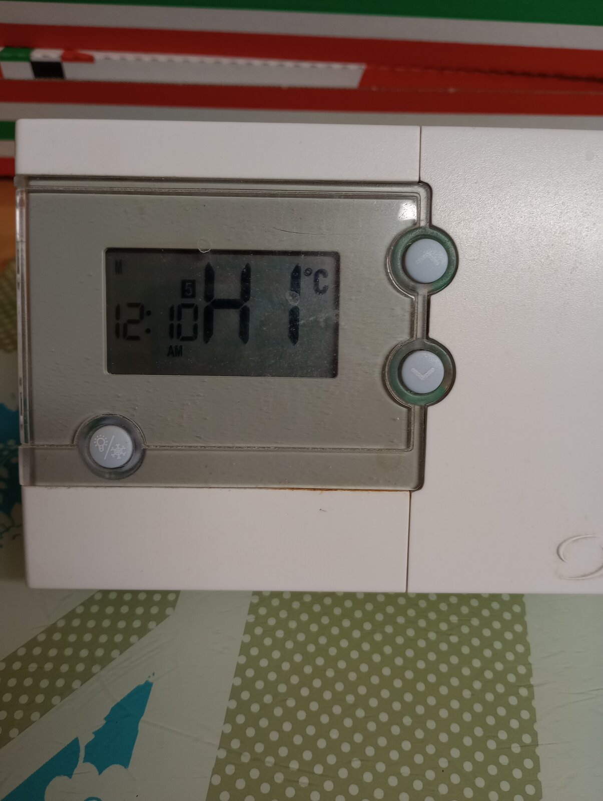

Hi there
I wonder if you can please help. I have a Salus RT500RF digital thermostat been working fine for years until just now. The digital display is showing the room temperature as HI°c meaning the room temperature is over 45° - it's very much not and now the heating won't come on - any idea as to how to override this?

Thanks Londoner2 - we have already done that we've had the batteries left out for about 30 minutes. We've also tried resetting it too.
Yes - we have the hard copy manual also. There's no help on there on how to troubleshoot this issue.
Here's a screenshot from the digital display
I think I've seen a recent post with a similar issue - the solution was to get a new thermostat.
Unfortunately Salus don't have a very good reputation around here!

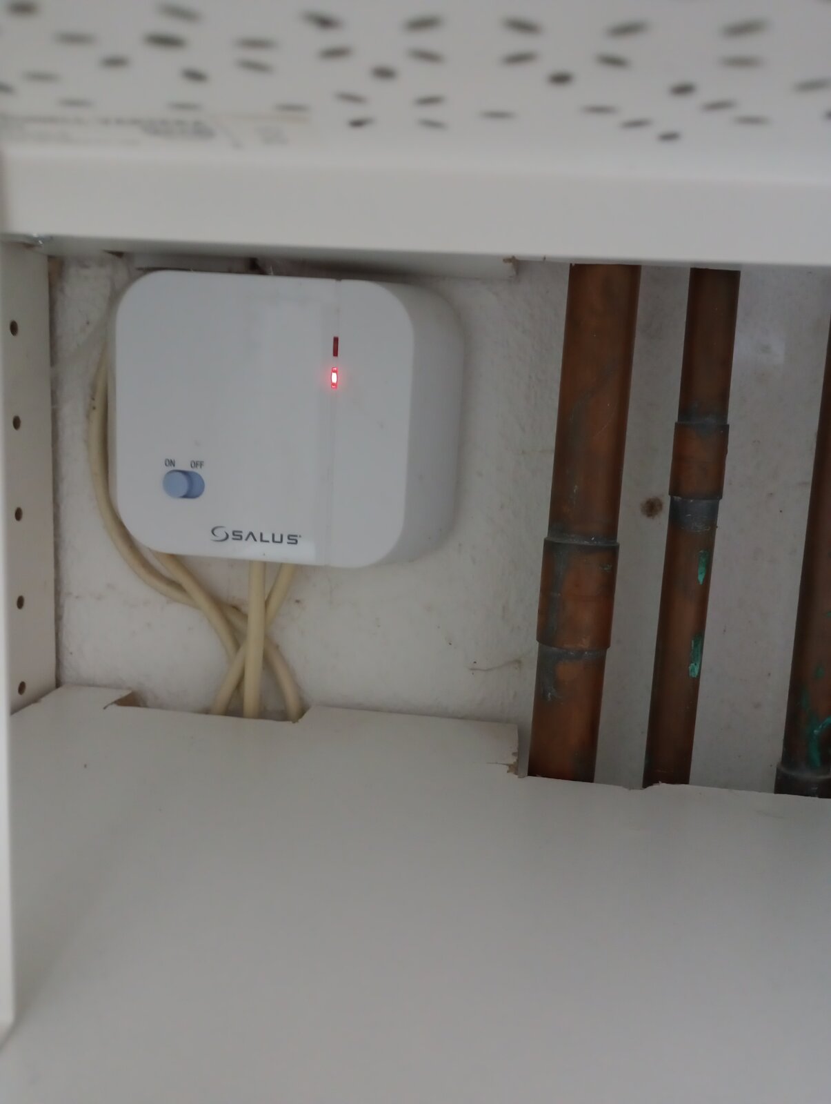

If you need heating now, show us a picture of your receiver, and we may be able to bypass it.
Doesn’t look like there’s an override. Is there a reset under the flap on the thermostat?
Hi there thank you - I feared that'd be the case! This is the receiver .
As @CBW , there's no override on the front of the receiver.

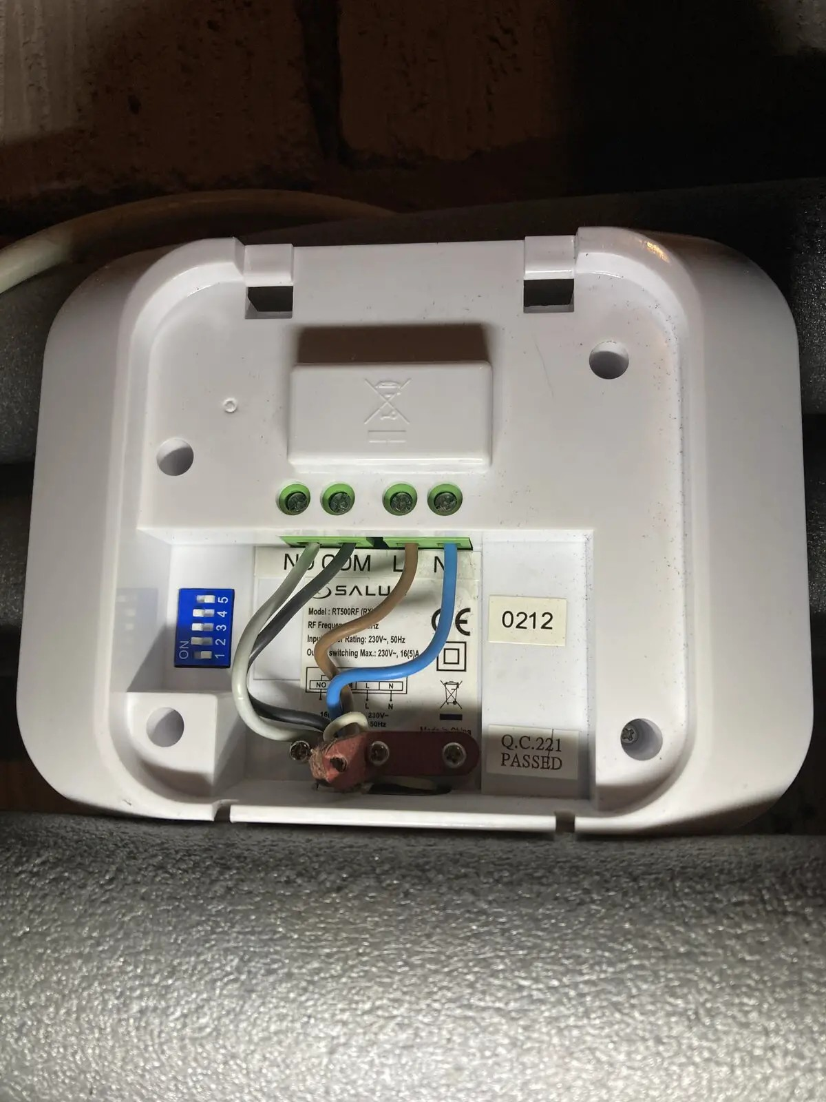

The rear of the receiver should look something like this...
With the power isolated, put the wires from NO and COM into the same terminal (it doesn't matter which - although for clarity, not L, or N!).
This should link out the receiver, and allow you to Use the controls on the front of your boiler, to control the heating.
