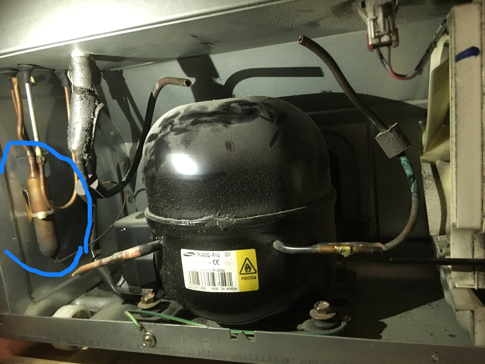

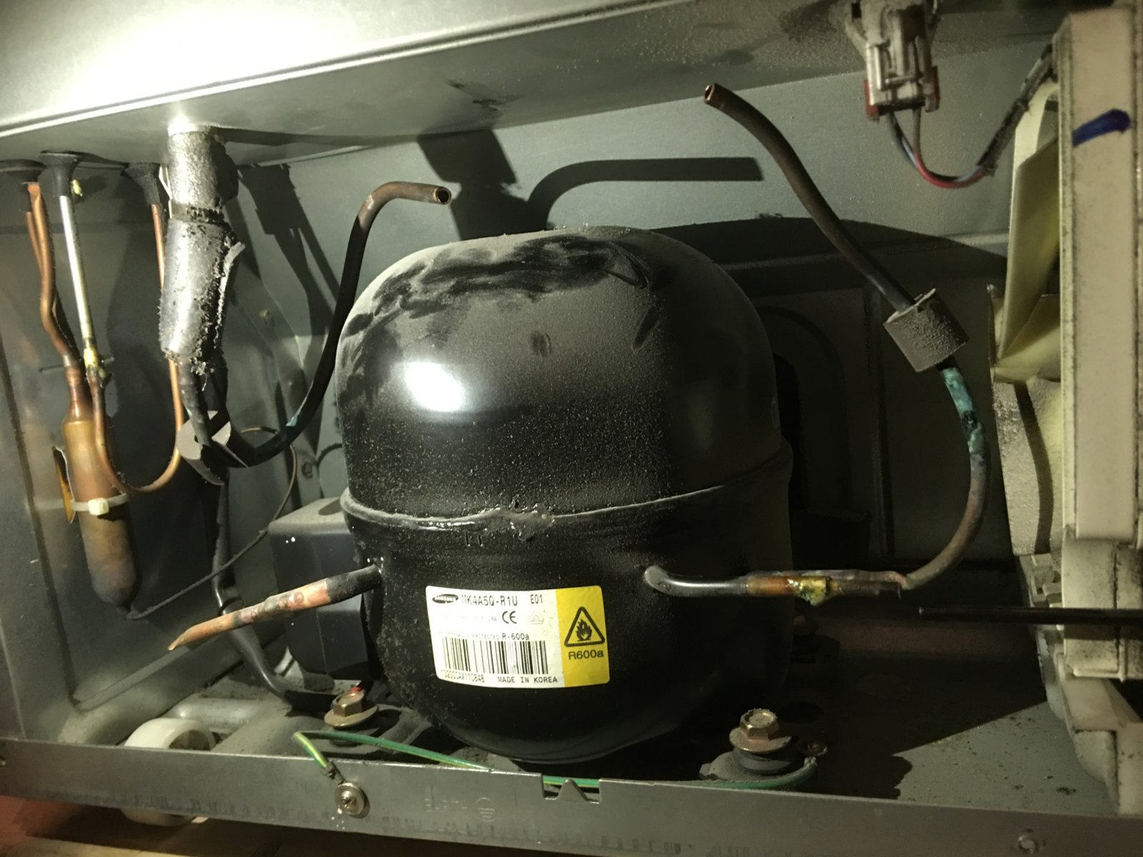

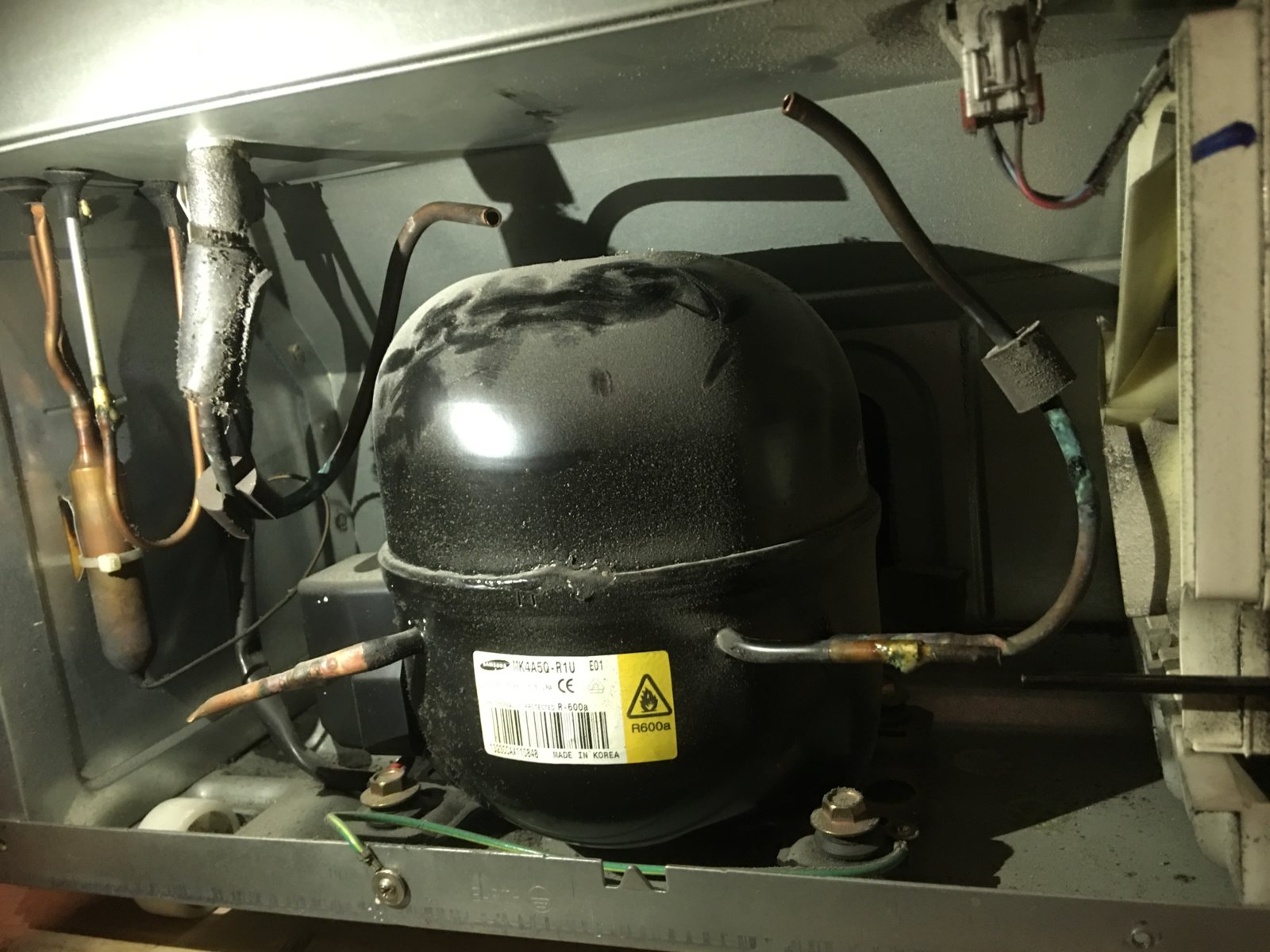

Hi guys my wife was home when the engineer called and she says he cut the pipes to take away the expansion bulb he said it had been leaking I’ve uploaded a photo ,anyway it’s that part that there saying is obsolete .
That looks as if they have removed the condensor, the heat radiator which usually cover a large part of the back of a fridge or freezer. Such a leak, if it was in fact leaking, could have been fixed by brazing it by a half competent refrigeration engineer and refilled. If a new part had been obtainable, it would have needed to be brazed in anyway, so why not just fix the leak?
Any condensor which would fit and be big enough to sink the heat, would have worked.
I very much doubt such a leak would cause your MCB to trip though. The explanation just doesn't hang together. Curiouser and curiouser!
I would be inclined to take this further with the company and ask them for a full written explanation of the fault and their attempt to fix it.

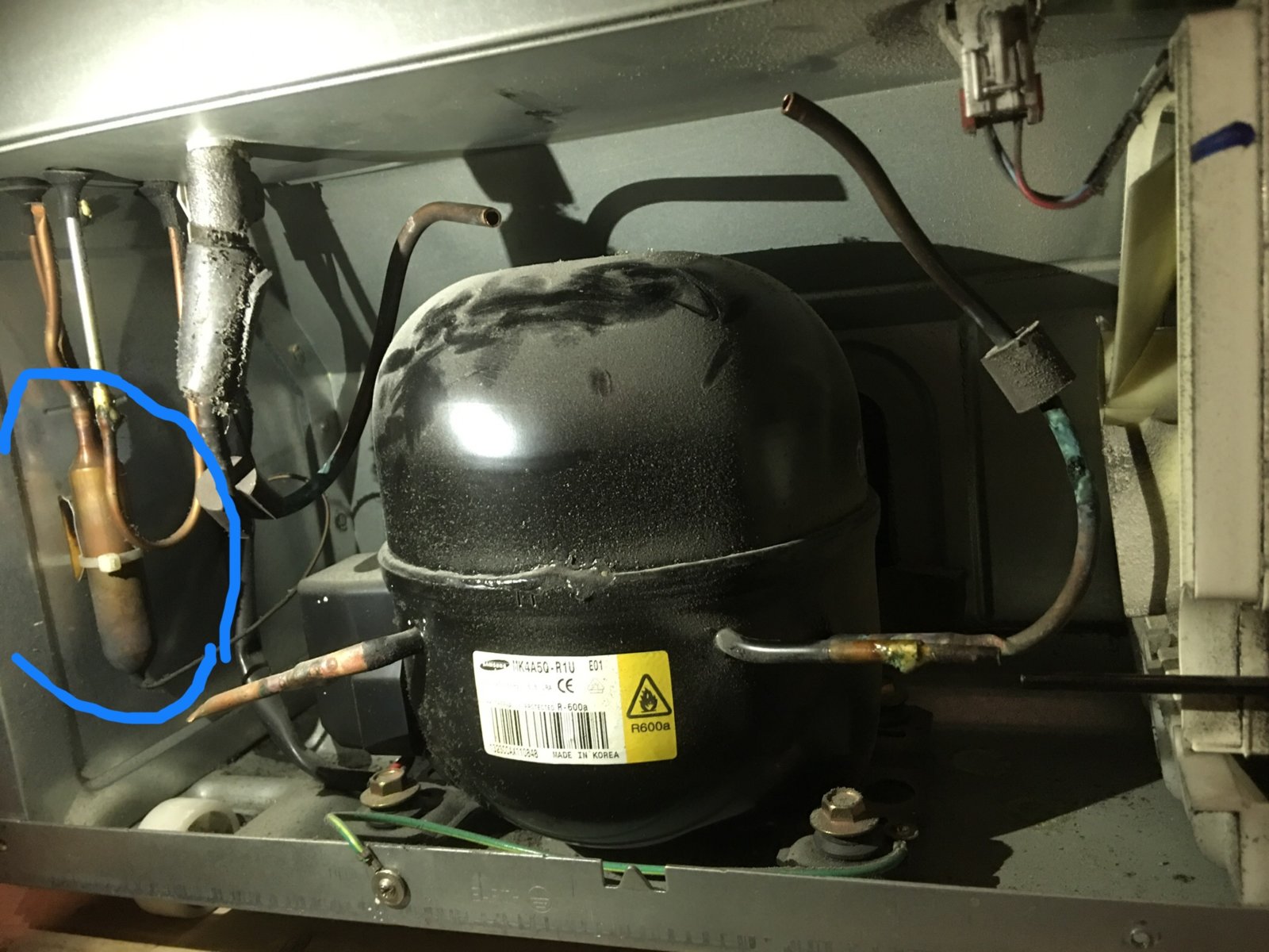

I’ve managed to speak to the engineer he says he hasn’t removed anything and that he needed a new expansion bulb to complete the job which repair care are saying is obsolete I’ve uploaded a photo can anyone tell me if the part circled is the expansion bulb and what’s its purpose.

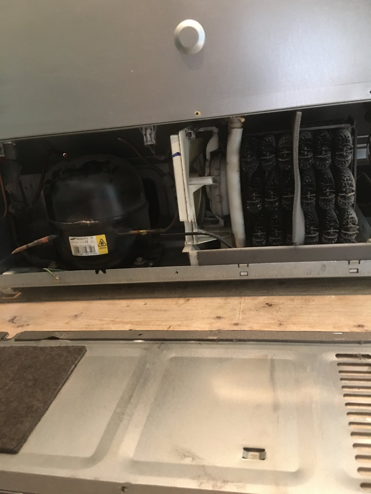

If you look at the back of any fridge or freezer, it will have a large radiator like condenser painted black and almost as big as the back of the unit. That seems to be completely absent in you photos, though none of your photos shows the entire rear of the unit - perhaps you could oblige with such a photo?
The bulb thingummy you have marked, I can only guess as to its purpose. My guess is that it is a dryer, to absorb any moisture in the system, once it has been built. A replacement would probably needed to be fitted, with any repairs to the refridgerent system. I will try and explore that some more..
Looking again at your photos - is that a fan there on the extreme right? If so that could well be the fan to cool the condenser.
If that is the case, I am back to square one. It is obvious those two pipes have been cut and something removed from the refrigeration circuit, but it is not electrical, so would not cause your MCB to trip. So it still doesn't hang together.
Is there any possibility that those two cut ends of pipe, might able to have one been joined as one pipe, rather than anything cut out of the pipe?
Hi Harry thanks for your quick reply,
It looks as if those two pipes could have been joined I’ve attached a pic of the back of the fridge freezer .
