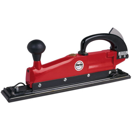

For the radiused edges, as per my previous suggestion unless you can get hold of an in-line sander with a profile maker kit (see the Festool LS130 to get an idea). These are very rare, though, and expensive. They follow the same principles as the pneumatic in-line sanders used in car body shops (but if course those, whilst relatively inexpensive require a very large compressor)

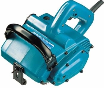

If you attempt to use any kind of brush head sander, such as an Engis head, there is a possibility of over sanding and changing the profile of the edges. Makita still make a portable brush head sander in some markets (model 9741J), but I haven't seen them advertised here in a long time (circa £450 to £500 imported)
At one time Black and Decker did a smaller DIY version of this, but I imagine you'd struggle to get abrasive for a tool which must have been out of production for at least 30 years old
