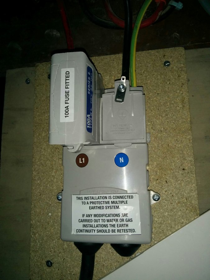

What is the existing supply ?

According to the sticker on the fuse installed by UKPN about 6 months ago (when replacing 'dangerously' located lead sheathed cable with newer stuff) "100A Fuse Fitted"
In that case, I would think that your present supply is probably plenty adequate for your needs.
Kind Regards, John

... but I don't think we are, after diversity. As I said to the OP, there probably aren't that many installations for which adding up all the potential 'maximum loads' would not produce a figure in excess of the rating of the cutout fuse. Don't forget that the DNO would probably regard the average load of the OP's installation (apply the sort of diversity that they do) as about 10A !!
