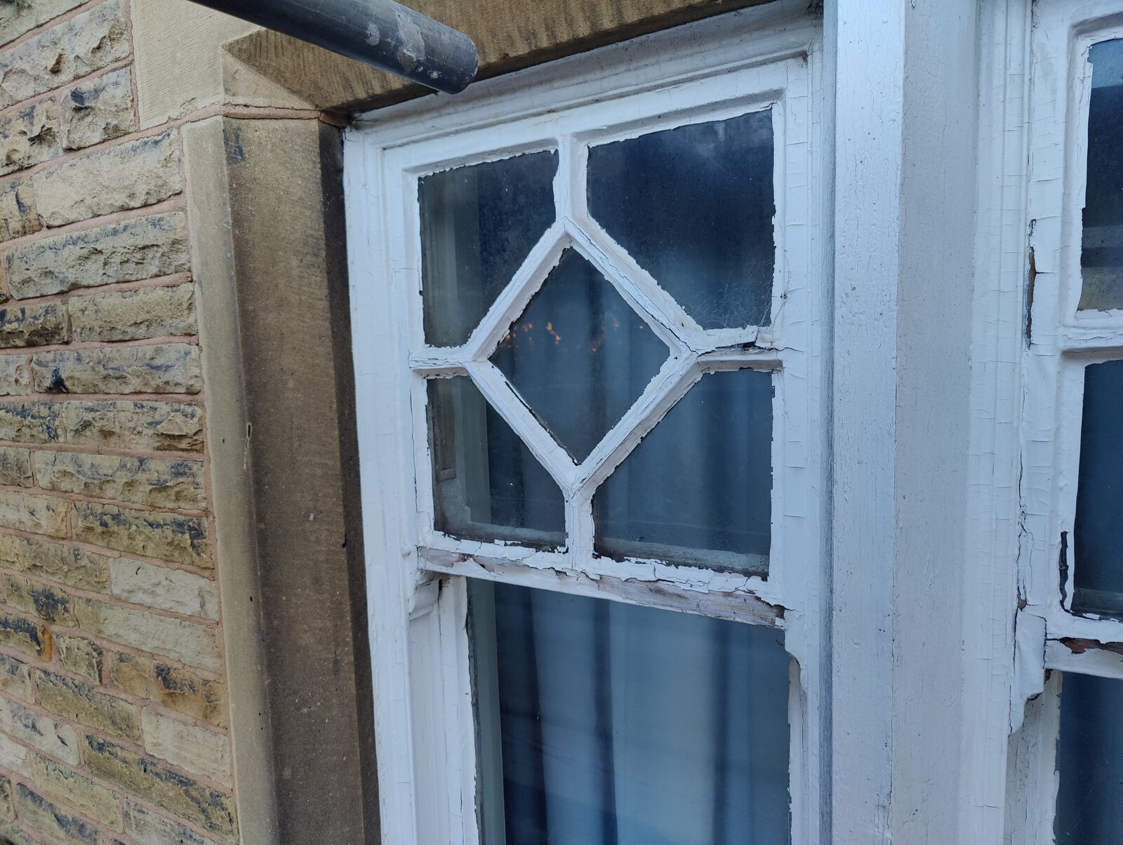

Hi,

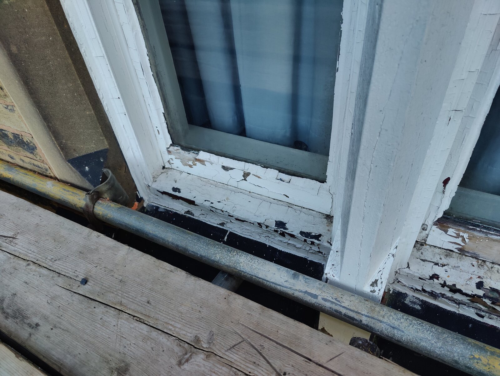

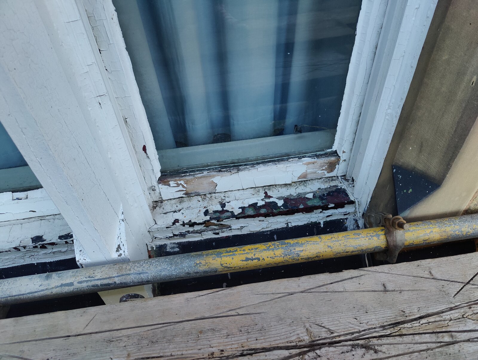

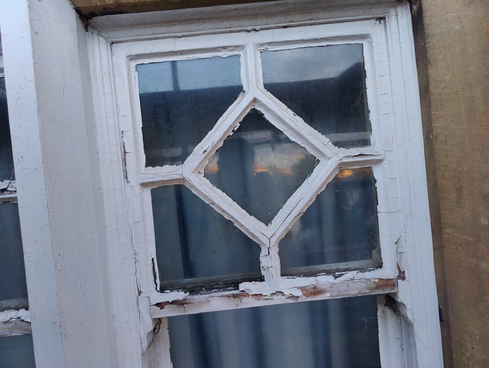

I have a pair of lovely original sash windows on the 3rd floor which are the last remaining in the house - everything else is standard uPVC. At the moment the side is scaffolded for other repairs, so the windows are accessible. It looks like the paint is cracked all over, putty missing in places and some paint missing - down to bare, grey wood but not rotten.
I can have a carpenter refurbish, said they would seal between frame and glass with silicone mastic and paint in 4 coats of Sadolin Superdec.
When I mentioned about linseed oil putty etc.. they can use putty if I want but that the world has moved on and modern products are available. Then said they can use a hardwood glazing bead instead. The price would be £240.

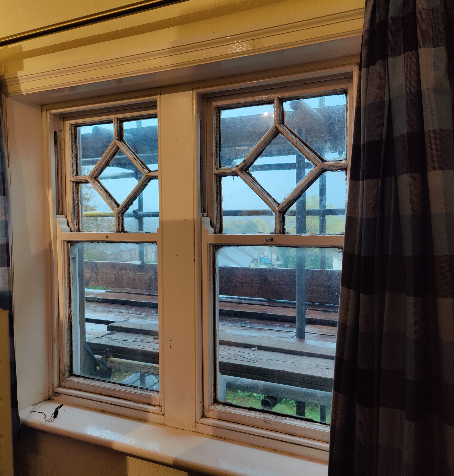

The room is used for storage and not heated - lots of water/moisture gathers on the inside and it's been covered in black mould - now tried to clean some off. I've never opened the windows but undid the bolts today and the left hand one opens and seems to work fine. The future plan is to use as a games room :giggle:
Just wondering what others would recommend options wise:
1. Try and putty myself then paint (risky option as I'm good at starting but bad at finishing projects)
2. Pay carpenter to refurbish at £240 to keep the windows going. But may need scaffolding in future (cost could be around £500)
3. Have the windows carefully removed, not destroyed to reuse elsewhere (how feasible is this) and replace with modern uPVC (could be expensive)?
4. Have some specialist completely restore the windows inside and out, maybe even making them double glazed (most expensive option)?
Thanks very much in advance.

Probably option 2. A lot of maintenance work on sash windows can be done from the inside, e.g. re-cording, removing the sashes, etc. The rebate in the masonry is also on the inside, so installation is also done from the inside.
As to keeping for use elsewhere, you have a vanishingly thin chance of ever doing this because sash windows are made to fit a specific opening with a specific masonry rebate.
DG conversion? Not always successfully done, and how will they deal with that fancy (and really nice, original) glazing bead detail on the upper sashes? It would be a real shame to lose that

I'm a bit confused here. The glass in a traditional sash window was bedded onto (linseed oil) putty and secured in place with a few glaziers sprigs (or small pins) and a bevelled bead of putty. That's what a clipped point putty knife is for. Putty has the advantages of setting rock hard, being weathertight for decades and being paintable. Neither timber beading nor silicone is a suitable replacement IMHO
The sealing around the outside of the window where it meets the wall masonry is traditionally sealed with something like trowelling mastic. Modern colour matched exterior sealant is a suitable replacement and probably better in that it is less prone to cracking

Get cracking on refurbishing them while the scaff is still up. Dont attempt to transfer them. Dont use flame.
Although the lift could have been, say, 300mm lower to give clear access to the sills?
Ease off the staff beads. Snip the pins when the beads are free.
One at a careful time bring back the sashes, & once the sashes are firmly grasped cut the cords. A helper would be useful. Only the sashes, leave the frame & sill in-situ.
Mark and note which sash went where.
Open the pockets & retrieve the weights.
Remove all furniture from the sashes. Treasure any solid brass.
Scrape then sand all remaining fixed woodwork ie the sill & box frame.
Remove the glazing: three sprigs per side two at top and bottom rails, various in glazing bars, & then the putty & any glazing beads.
Paint: in the pink, undercoat & two top coats including in the glazing rebates.
Use modern glazing sealants - never glazing beads - for fixing the DG.
Fixing the weights will be trial and error but its simple enough. Use only new sash cord.

As above have said, your windows could be repaired from inside, now and in future.
If the room is not used, perhaps you could repair and DIY a secondary glazing sheet on the inside for comfort/heat etc.

I wouldn’t use hardwood beading, the section would be minute, around 8mm x 8mm, the weather would get in at the mitres and rot away.
I would remove putty, clean up re seal with small bead of low Modulus silicone, then use dryseal acrylic putty - although it’s quite tricky to use but it dries within 24 hours and will last many years

As for improving the thermal efficiency you could consider having an internal window made, glazed with heritage grade double glazed glass.
All the decoration on a sash window can be done from inside the house if you take the sashes out, which is not a hard job.
The staff and parting beads can be replaced with beading with built in brush seals which makes them much less draughty. You could then add internal secondary glazing if you think you need it, but heavy curtains are a good substitute.
Putty is the right material to rebed the glass. So7nds like you need to find a sash specialist to restore them for you, which can be done without a scaffold. I’ve done loads, and always from inside the house.
