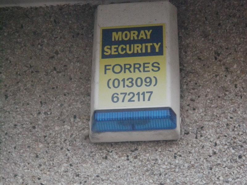

This bell had a red and a green LED flashing in flip flop fashion, this was the reason for opening the box in the first place, since it was a suspected fault, then it changed to green only after closing the lid back. With no manual, I don't know how it is supposed to operate in a healthy condition.

Thanks for the other info. This is the bell box, there are 2 large screws with plastic caps on the sides near the bottom, I want to identify the battery but as soon as I loosen a screw the alarm goes off, any guesses?
Regards
I don't know but it will almost certainly be a stack of Ni-Cd or Ni-mh cells.
Open the bell, ignore the noise, find the tamper switch and put your finger on it. The noise should stop. Then you can hunt for the battery, see what sort it is and whether it is easy to replace (soldered in :( or fly-leads into screw terminals :D ).
