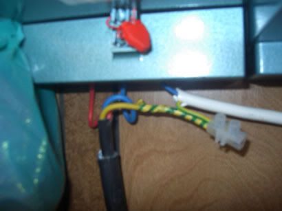

What's the bottom picture of? Is there Live, neutral and earth in the flex?
Meter - Typical on site maintenance man install!!!
Seen all to many times.
Yeah, forgive the poor images.
The bottom pic is a card meter fed via a 1.5 SWA with armour unterminated. The yellow's used as earth & the white flex feeds the CU.
It's not easy to see but the flex is 3 core.
Just a sh*tty install. YUK!
