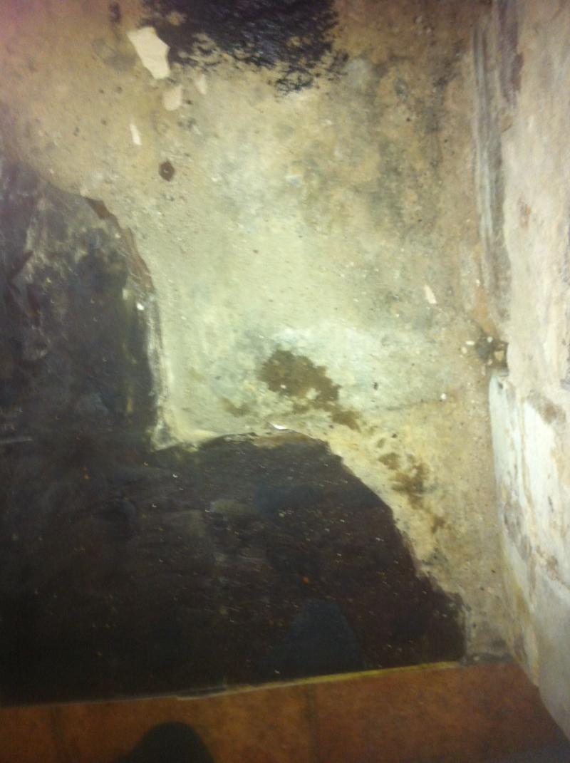

Hi I am soon to be starting on a new kitchen in my house and I'm after some advice regards the floor. The floor is a concrete sub base with a 20-25mm bitumen screed on top of that. The floor is not very level so I was hoping to use some self level on top of it so I can lay a wood floor. Is there a primer I can use and which would be the best self levelling compound to use.
Also is some areas in the kitchen the screed has come away near the edges. Would using a liquid dpm and then building it back up with mortar to the same level be the way forward with this.

Can you post some pictures. That will help.
Alot of people call it bitumen Ashpalt when it was done in the old days. See it alot in council houses. As long as no cracks in it you will be ok. I when over one a while ago but in wasn't complete so I screeded over it, used a liquid dpm then screed again. Not cheap but it will work.

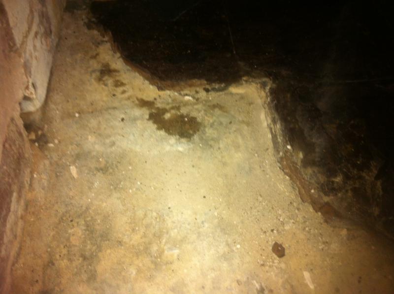

Hi Daz most of the kitchens looks fine where i have took some of the lino up to have a look. On the pictures shows where a section is missing at the chimney breast(old fire maybe). Somebody had already filled it in but put no dpm underneath so it basically came up in my hands.I have chipped any loose pieces away so whats left is solid. There is a small crack near the sink on the other side though about 120mm long cant tell how deep.
Hard to say looking at that, I would defo be putting a dpm over it or taking it up mate
