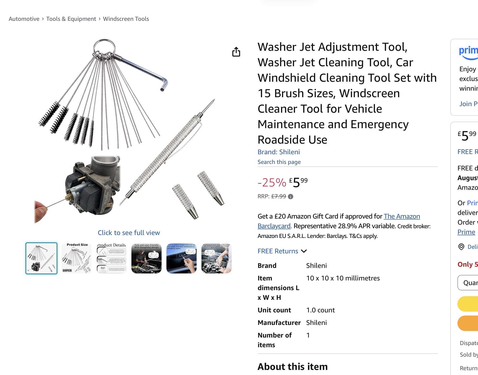

Can you take the hoses off the back of the jets , and see if water comes out from there when you run it?
Plenty of others to choose from…
