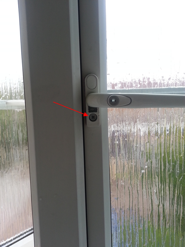

Hi,
I have some double glazing PVC type windows, and the screw has come loose in it's socket - see image below.
When I tighten it gently it holds then gives - there is a risk of it becoming threaded.
What do I do to solve this?
Thanks!
Alex
Remove and replace , if new screw will not hold, hole is damaged,[or screw has been cut too short, check length] a straightened paper staple poked in the hole will often give enough purchase to hold.
