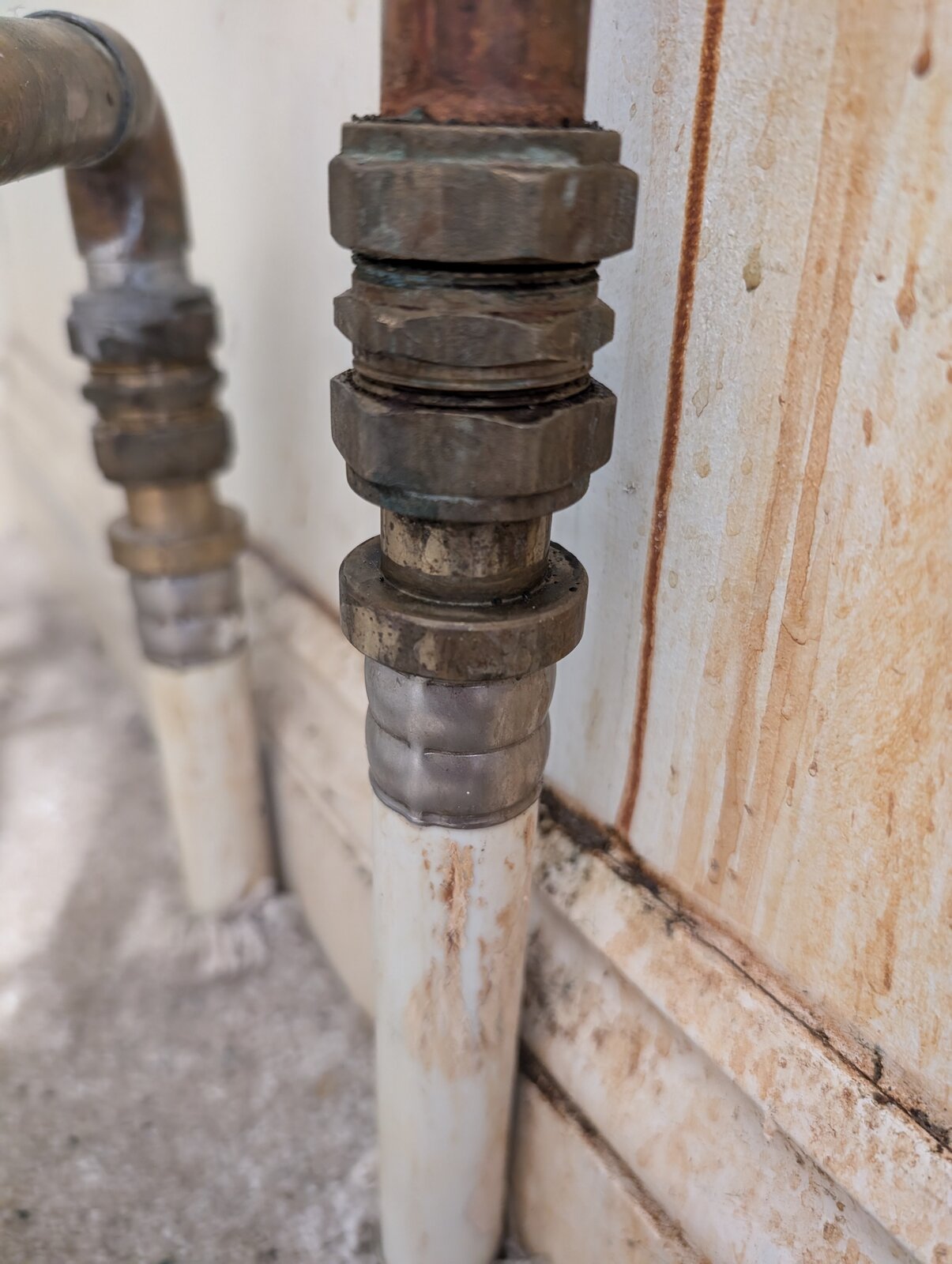

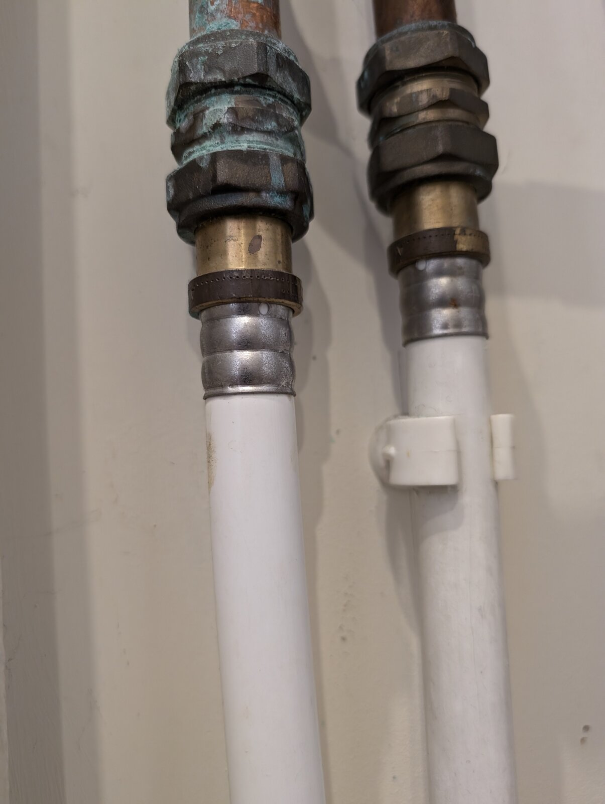

Sounds bad, have you any non barrier piping anywhere?.
Does the AAV vent regularly?,
Maybe look at installing a Spirovent or similar,
Is the filling loop disconnected completely after any/every top up?
Not sure on non barrier piping. When I inspected there is some plastic piping under upstairs floorboards, with plastic push connectors I assume. All exposed piping to rads, cylinder and boiler seems to be 16mm copper pipe.
How could I confirm if non barrier piping is used?
I may be able inspect under floorboards again and look for markings on plastic pipe.

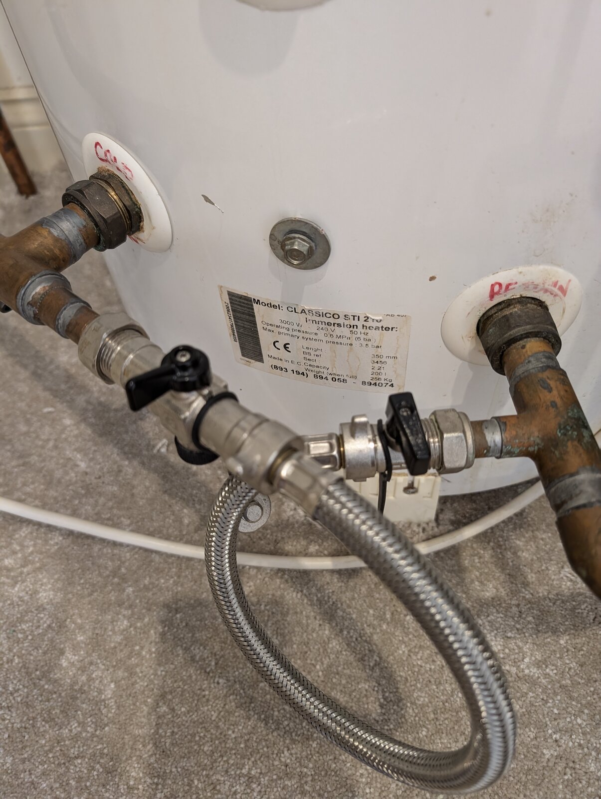

You say both filling valves are closed but still doesnt guarantee full isolation.
I think non barrier pipe absorbs oxygen but one might think not much in 7days but again how does (if) air get in with a shutdown system, not to mention that its a sealed, pressurized one. Try and post any writing on yours.

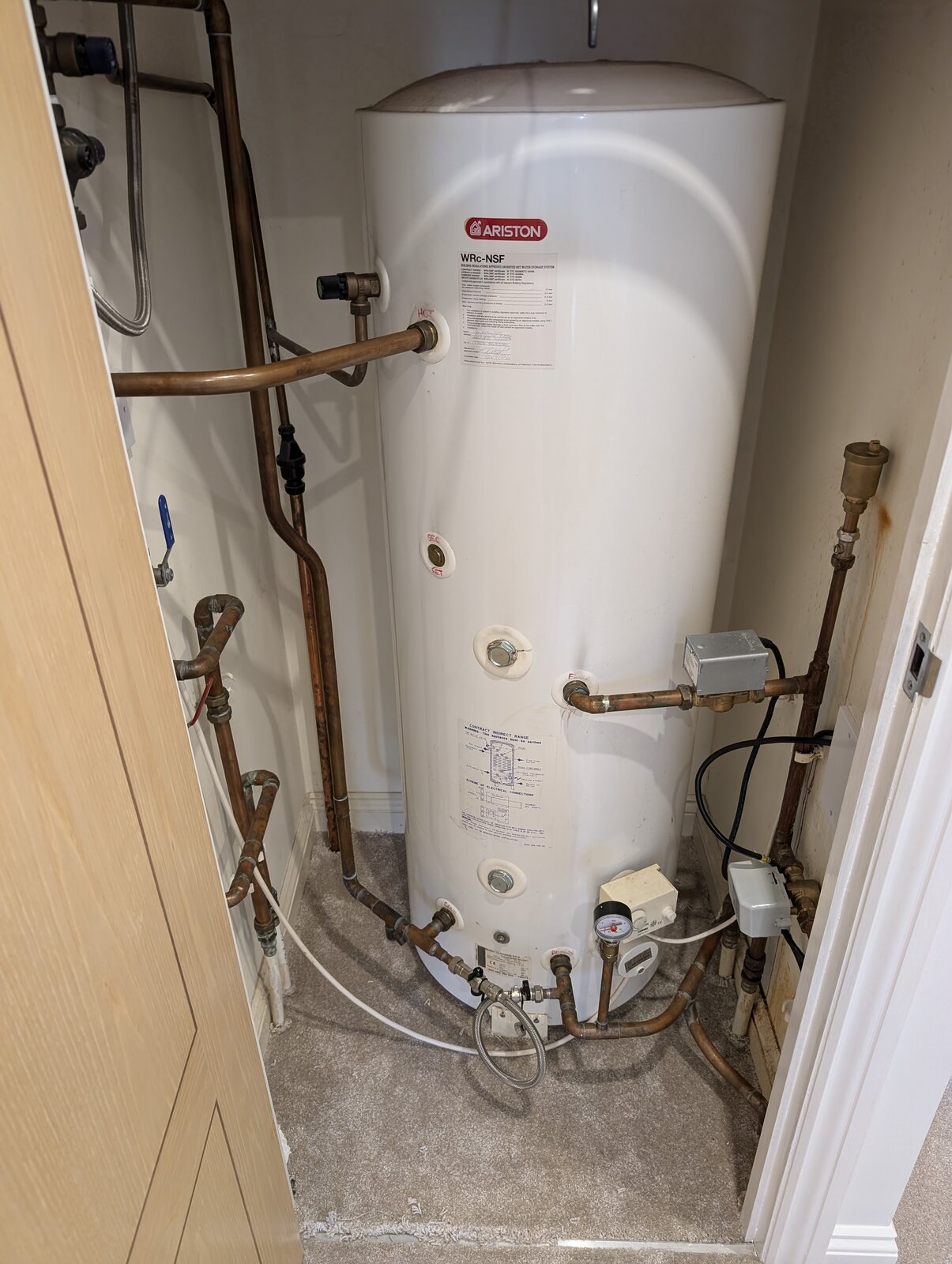

You also mentioned a possible split in the heating coil, a possibility of fresh water ingress but only if you have a unvented cylinder, how old is the cylinder?

I've attached some pics of the hot water cylinder cupboard for reference.
Yeah I think it's an unvented cylinder, which is 20 years old now. It's the last original bit of the system, so seems reasonable idea to replace?
I think I will try adding the spirovent cheers. Looks like an upgrade on a AAV
Good shout on the filling loop. See pic, looks okay to me, but I guess it's possible both are leaking mains into the system.
I assume could replace system side valve next time system is drained as a matter of course

Re Filling Loop, you can first slacken off/remove the flexible hose to check for any valve leakage.
