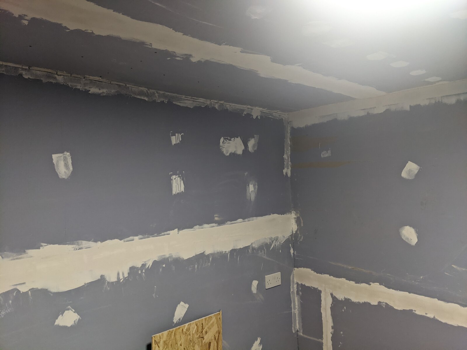

I have used the taping and jointing method to finish my plasterboard walls. Just wondering what's the best options / products to get it ready to paint?
Looking at few option (Zinsser Gardz, Dulux plaster primer, Zinsser Bulls Eye 123 Primer / Sealer)

That's a slightly older picture. Still need to finish sanding, but it's not as bad is in the picture, only need to smooth out any raised bits on the final layer.
I would use Leyland Trade acrylic primer to spot prime the filler. It has the advantage of being easy to sand if required. It is also cheap.

If I use Leyland Trade acrylic primer to only prime the filler, doesn't the plasterboard itself not need sealing? Or should I just apply the primer to whole wall?
Bare plasterboard is a very nice surface to paint straight onto!
You could prime the whole lot if you felt like it, but it's not strictly necessary.
It might also depend on the colour and quality of the topcoat/s - if there's a chance of the filler and primer showing through.
Plasterboard has a paper face and is able to accept emulsion directly. If you want a slightly flatter finish, you could spot prime the filler and then use another coat of the primer over the whole lot before sanding it with 180 grit paper to flatten the paper fibres. Most people don't bother though.

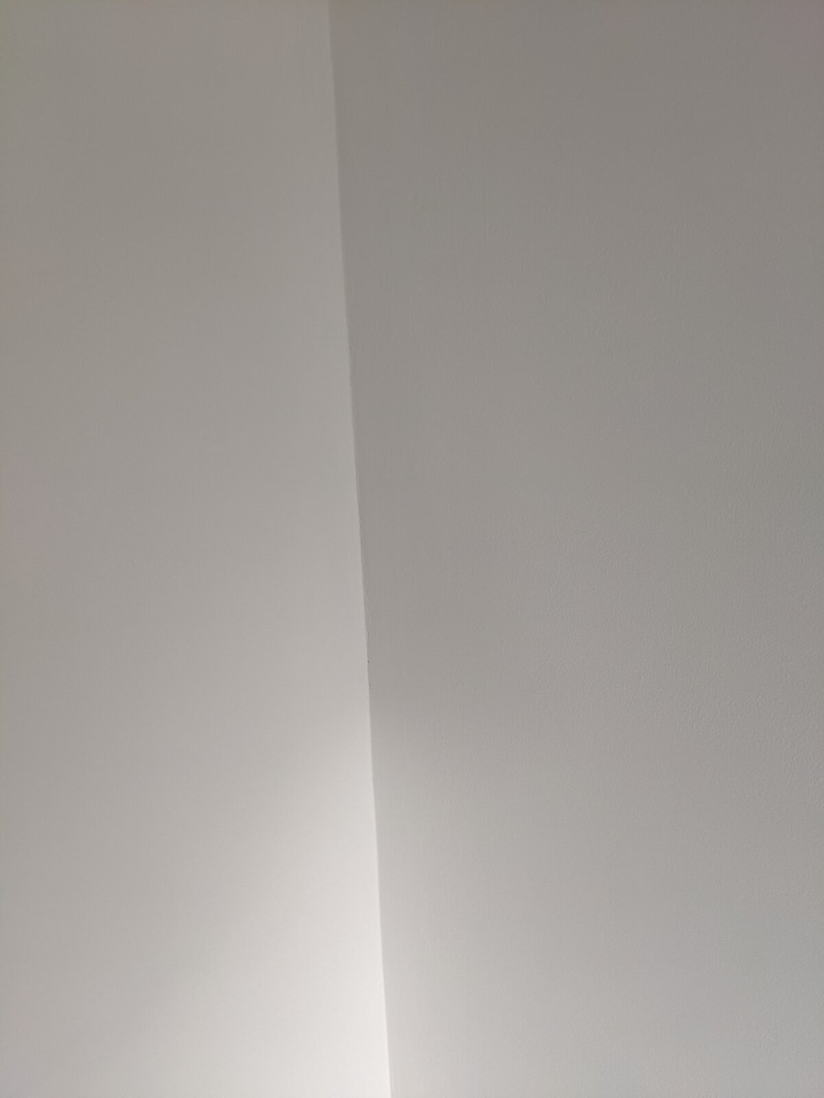

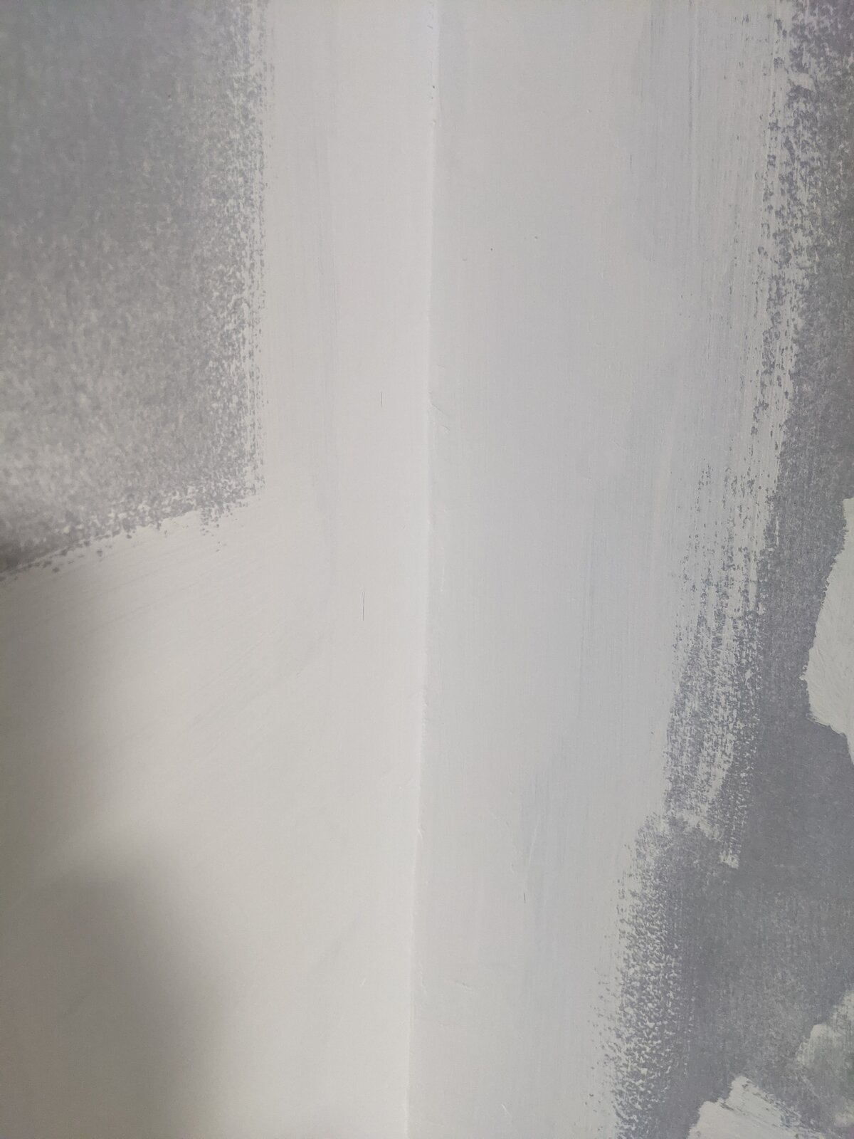

Did first round of priming and happy with how it has turned out.
