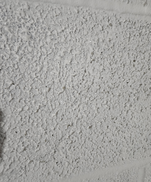

I am going to revive this old thread instead.
I am currently about 3 coats of high opacity Trade Leyland White on these concrete blocks. Still going. Can i mix a few tubes of caulk or something. They really are taking a long time. I have 3 6mx2m walls so far used 3 tubs of 10litres. How do i seal these blocks they dry and holes appear again!!
Pic attached.
