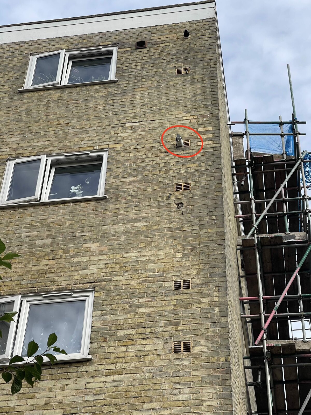

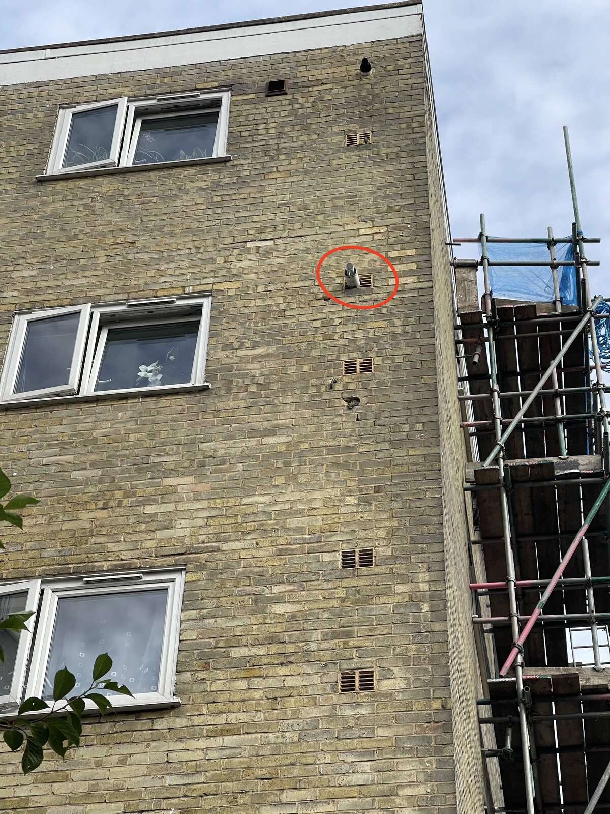

Hello,
My Gas Safety Certificate failed because the flue has been installed through an air brick and has not been sealed externally. I've attached a picture.
This has been the case for many years even before I owned the property, but nobody had challenged it until now.
My boiler is a Vaillant EcoTEC Pro 24.
I'd like to hire someone to carry out the required work. I don't live near the property at the moment, so sealing it myself isn't an option.
The difficulty is that flat is on 3rd floor, so the flue is about 10m above ground.

Clearly fitted by Bodgit & Scarper Ltd. Needs to be a Gas Safe Registered engineer to do the job as it'll need the flue removing, air brick taking out & bricking up, and a new flue installing. Up to you whether you want to provide suitable access yourself or leave it to your chosen tradesperson. It's not clear from your photo how high up it is but a lot of people won't want to do that off a ladder
Thanks Muggles, this makes sense.
Do you have a recommendation what would be an economical solution, that's better than a long ladder?
Rough but easier and a lot cheaper to do it from inside wont be hard to knock out the internal infill from original air brick and fill the external bit of air brick with mortar/cement mix from inside and then make good inside .
This could be done without damaging the existing flue
yep not the best of installs
but why would it need the existing flue removing and replaced , easy to take remnants of existing air brick out without damaging the flue and seal the opening no need to be tying bricks in at that height and especially on such a small opening

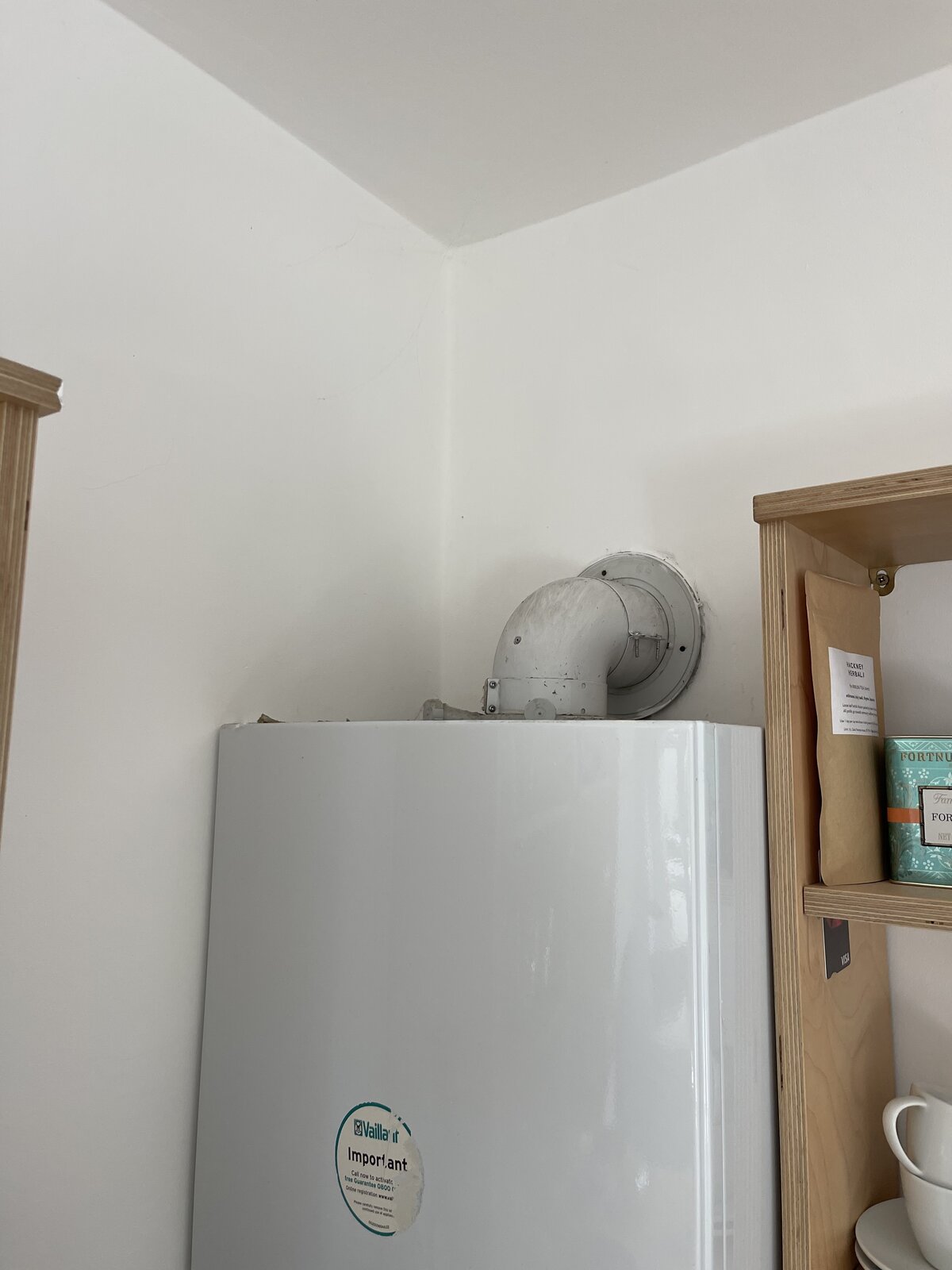

This is what the boiler/flue looks like inside. There's no air brick. Do you still think it could be done from the inside?
It doesn't look to me that anything can be done from inside, without cutting a largish hole in the inside wall which, to get access, would probably require the boiler to be removed.
And I don't see why this flue arrangement failed inspection - the seal to the inside wall is fine. Maybe an over-zeolous inspector? Or am I totally wrong about this?
